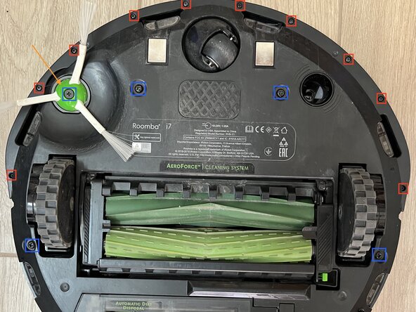

Remove the dust collector. Disassemble the 6 screws marked in blue. Then remove the brush spotted with the orange arrow. You can then remove the bottom of the robot
Remove the 10 screws marked in red. You can remove the bottom cover of the front "bumper".

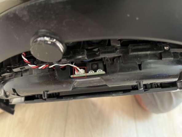

The lower cover of the bumper is removed. By lifting the robot you will be able to clear the "bumper" to access the sensor.
Step 3

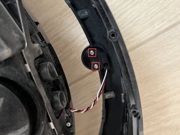

You must then unplug the sensor connector from your card. There are 2 screws to remove to disassemble the sensor

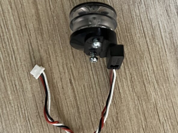

Here is the sensor that is easily found for sale on the internet by searching for "RCON Certified iRobot i7 Sensor Kit"
Mount the new sensor in the "bumper", connect it to its card
