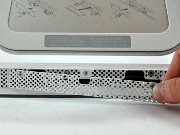

Orient the iMac face-side down on a table with the bottom edge facing yourself.
Remove the two Phillips screws securing the access door to the bottom grille of your iMac.
Remove the access door.

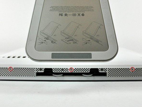

Remove the three T8 Torx screws securing the front bezel to the rear case along the lower edge of the iMac.

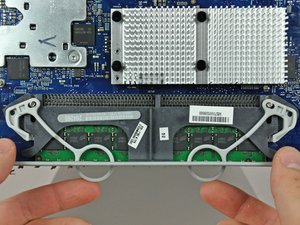

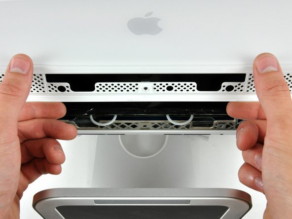

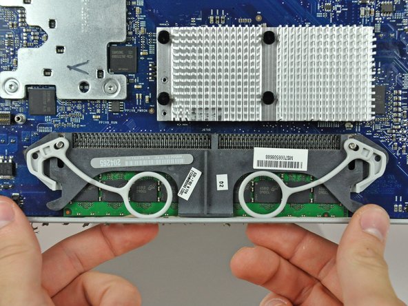

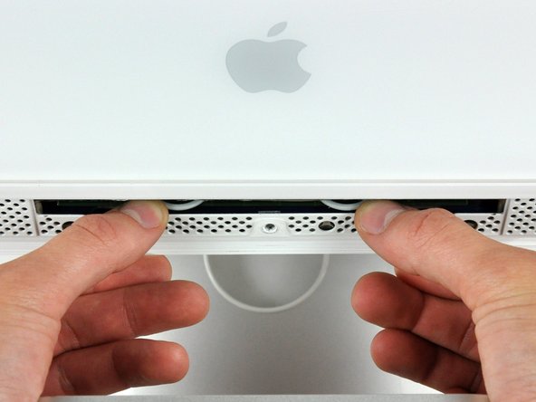

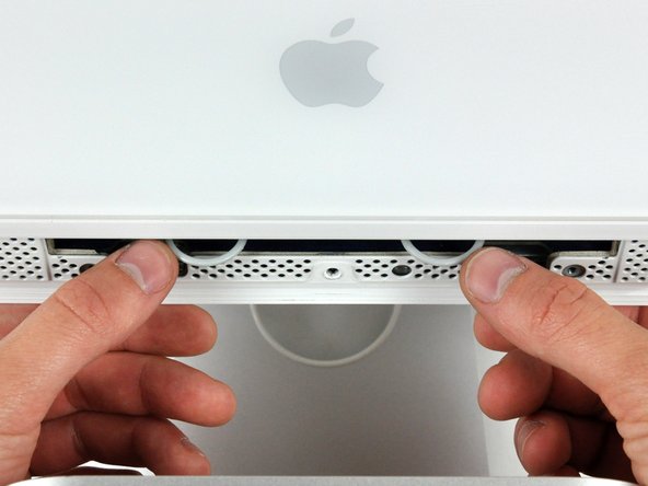

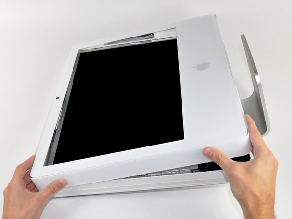

Use your thumbs to press both RAM arms in past the front bezel for enough clearance to lift it off the rear case.
While holding the RAM arms in with your thumbs, lift the lower edge of the front bezel enough to clear the rear case.

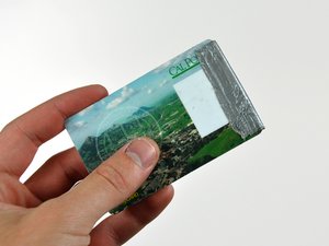

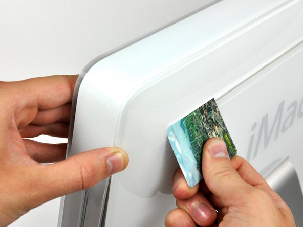

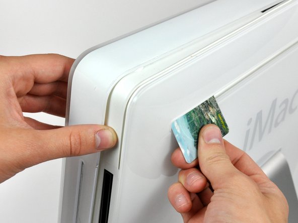

Insert a plastic card up into the corner of the air vent slot near the top of the rear case.
Push the card toward the top of the iMac to release the front bezel latch.
Pull the front bezel away from the rear case.
Repeat this process for the other side of the front bezel.
If the bezel refuses to release, try pressing the lower edge back onto the rear case and repeat this opening process.
Lay your iMac stand-side down on a table.
Lift the front bezel from its lower edge and rotate it away from the rest of your iMac, minding the RAM arms that may get caught.
Lay the front bezel above the rest of the iMac.

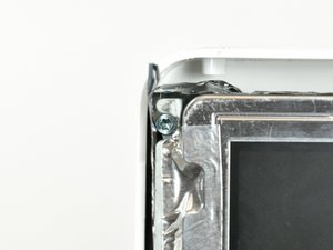

My A1145 seems to be attached, somehow, on the top via some silver looking strips. It does not seems to want to come off. Is that the wireless?
NO they are clamps on each of the top inside corners of the outside bezel (frame ) if you use a Heavy Spudger Tool & pry not too hard just slightly between the bezel (side) and the display (side) this should pop each off usually by just popping one or the other sides the second will automatically pop as well.

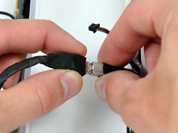

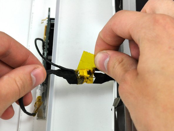

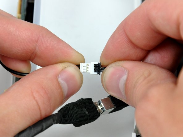

If necessary, remove the piece of kapton tape wrapped around the microphone and camera connectors.
Disconnect both the camera and microphone cables.

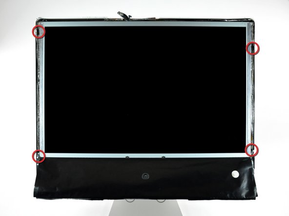

Remove the four recessed T10 Torx screws securing the display to the rear case.

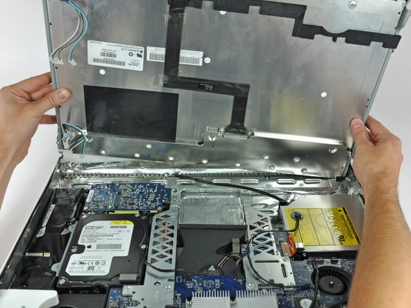

Lift the lower edge of the display slightly out of the rear case.

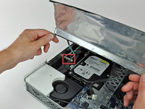

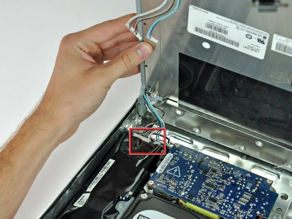

Disconnect both inverter cables (shown in red) by pulling their connectors toward the bottom edge of your iMac.
Lift the display until it is nearly perpendicular to the rear case.
Disconnect the remaining two inverter cables (shown in red) by pulling their connectors toward the top edge of your iMac.
Steps 17 and 18 are not strictly necessary if one simply props up the LCD display into a vertical position while the hard drive is removed and replaced. It worked for me anyway!

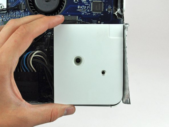

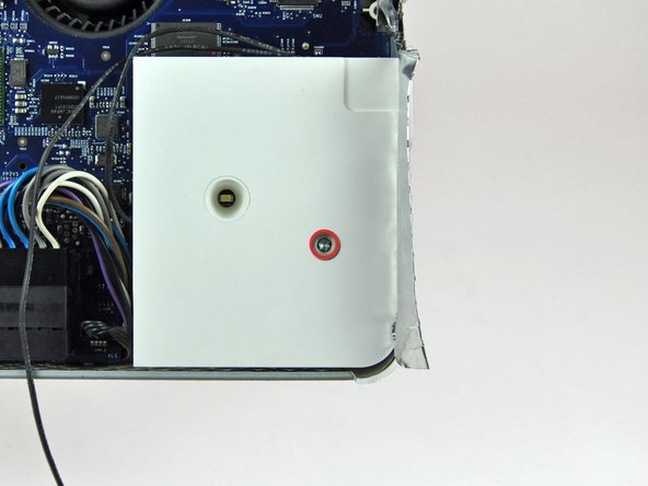

While holding the display perpendicular to the rear case, pull it upward to peel off the EMI shield stuck to its upper edge.
If you are changing the power supply - this is a good point to remove the screws to the old power supply to see if the connectors (both of them) are accessible. If you can gently (but firmly) pull the power connector out from under the chassis, you can install the new unit at this step - saving hours of work.

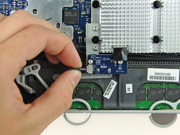

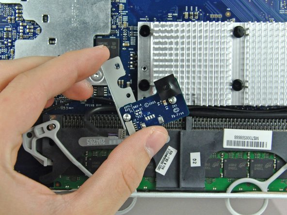

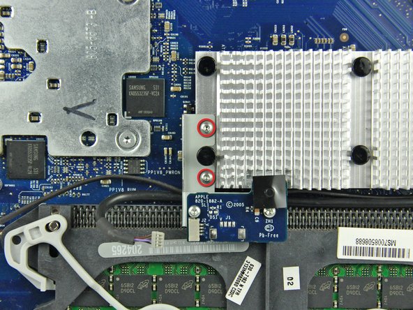

Disconnect the IR board cable by pulling its connector away from the socket on the IR board.
Remove the two T6 Torx screws securing the IR board bracket to the IR board.
De-route the IR cable from under the aluminum heat sink and tuck it behind the optical drive to keep it out of the way.

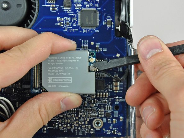

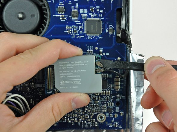

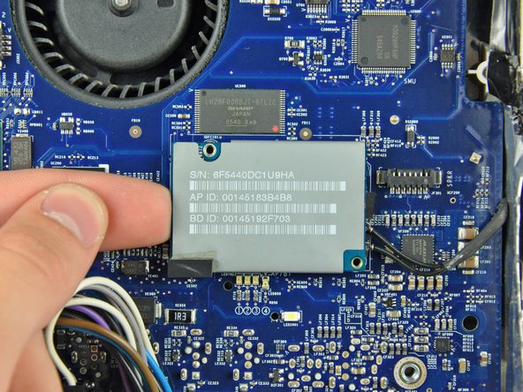

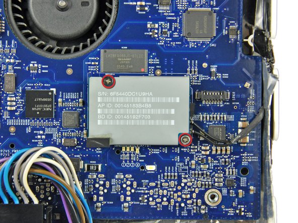

Remove the two Phillips or two T6 Torx screws securing the AirPort/Bluetooth board to the logic board.
Use your finger to lift the AirPort/Bluetooth board from its left edge, disconnecting it from the logic board.

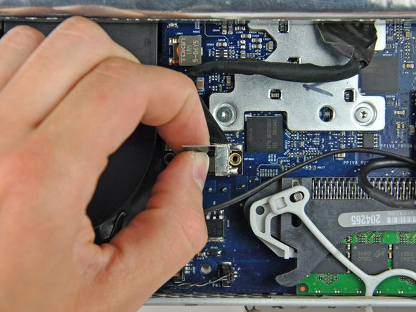

Use the flat end of a spudger to pry both antenna cable connectors up off the AirPort/Bluetooth board.

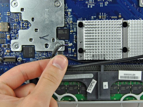

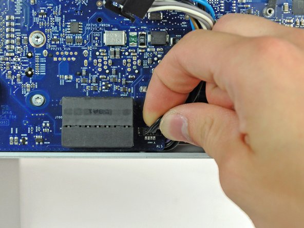

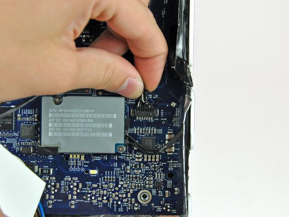

Disconnect the ambient light sensor by pulling its connector away from the face of the logic board.

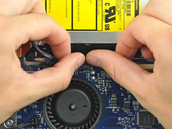

Disconnect the optical drive fan from the logic board.

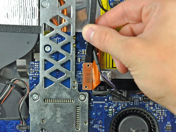

Disconnect the IR/camera cable from the logic board.
Disconnect the optical drive thermal sensor cable from the logic board by pulling its connector toward the left edge of the iMac.

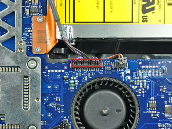

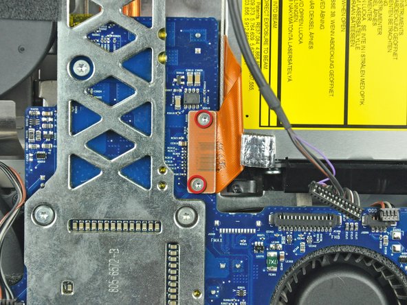

Remove the two T6 Torx screws securing the optical drive connector to the logic board.
Use the flat end of a spudger to pry the optical drive connector up off the logic board.

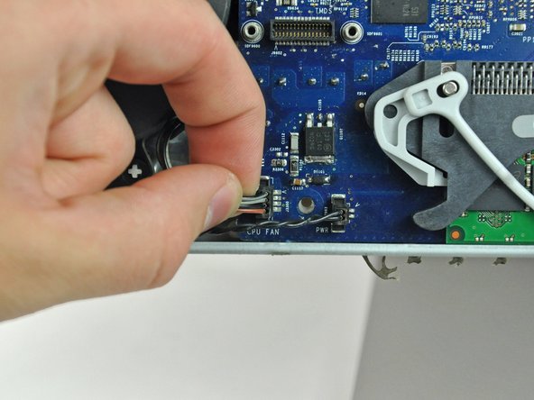

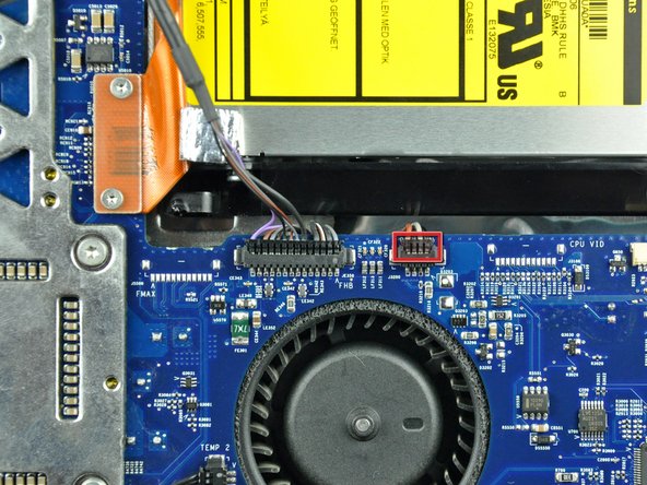

Disconnect the CPU fan from the logic board by pulling its connector toward the top edge of the iMac.

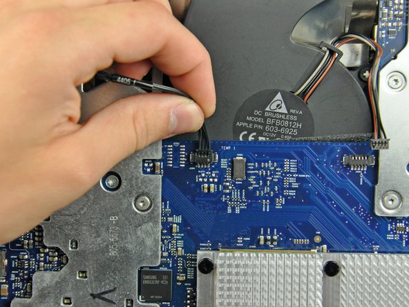

Disconnect the hard drive thermal sensor from the logic board by pulling its connector toward the top edge of the iMac.

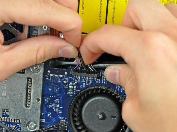

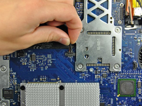

Disconnect the hard drive fan by pulling its connector away from the face of the logic board.

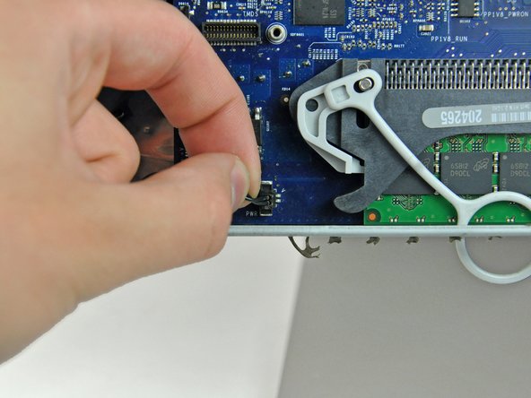

Disconnect the power button cable by pulling its connector away from the face of the logic board.

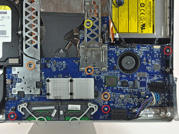

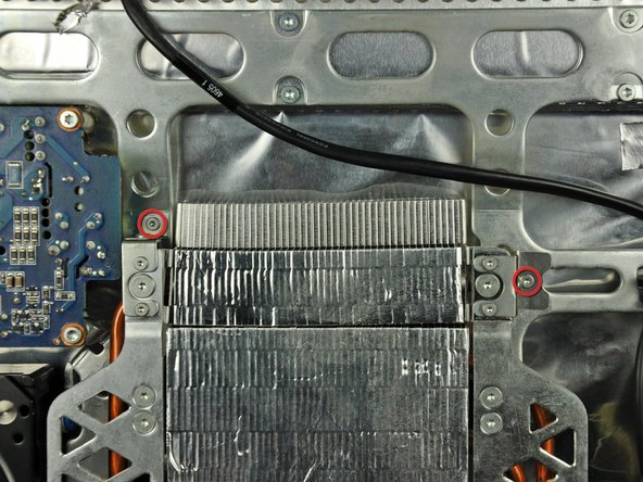

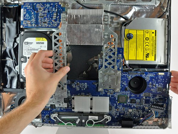

Remove the two T6 Torx screws near the top of the heat sinks.
Remove the following seven screws securing the logic board to the rear case:
Three coarse-thread T10 Torx.
Three fine-thread T10 Torx.
One long coarse-thread T10 Torx.
Tuck the RAM arms into the iMac so they rest on the perforated metal grille along its lower edge.

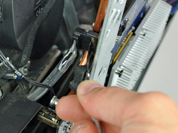

Continue rotating the board toward yourself until you have enough room to reach the SATA connector, shown in the next step.
Continue rotating the board toward yourself until you have enough room to reach the SATA connector (shown in red).

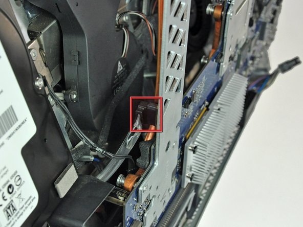

Insert the blunt end of a metal spudger between the SATA connector and its socket. Twist the shaft of the metal spudger to separate the connector from its socket.
Disconnect the SATA cable from the logic board.

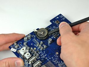

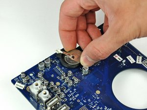

Use the flat end of a spudger to pry the PRAM battery (type CR2032) out of its housing on the logic board.
Use your fingers to remove the PRAM battery from its housing.
