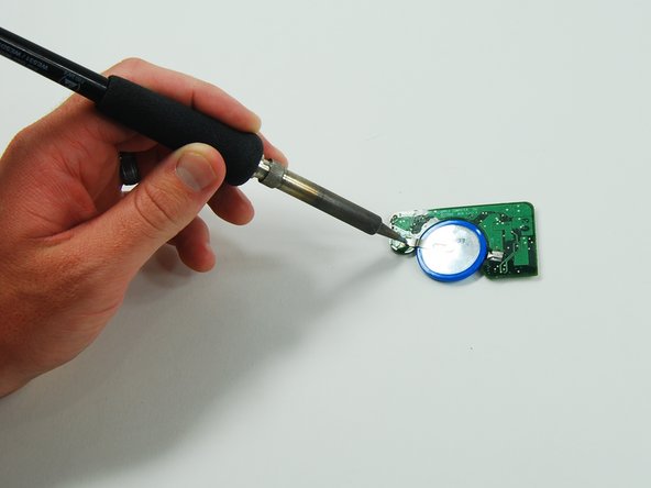

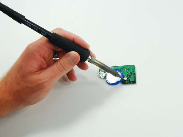

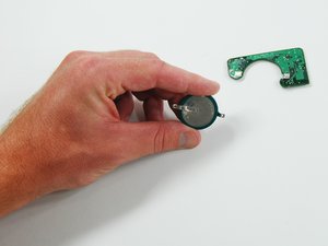

    • With a soldering iron, place the tip on the first joint and hold it there until the solder liquefies allowing you to pull the battery's terminal away.
    • The soldering iron is extremely hot so be sure to keep your fingers away from the metal. You also want to make sure you do not touch anything other than the solder on the assembly board.
    • Do the same for the second, soldered joint.

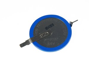

    • With the old battery free from the assembly, you can now install your new one.
    • Again, make note of where the positive (+) side is installed.

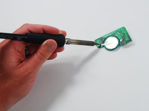

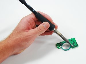

    • Place the battery terminal directly on the remaining solder joint.
    • Using the soldering iron, apply pressure until the solder liquefies and joins with the battery terminal
    • It shouldn't take more than 5-7 seconds
    • Do the same thing for the other soldering joint and you are done.
You can now install the PRAM assembly back in the computer.
