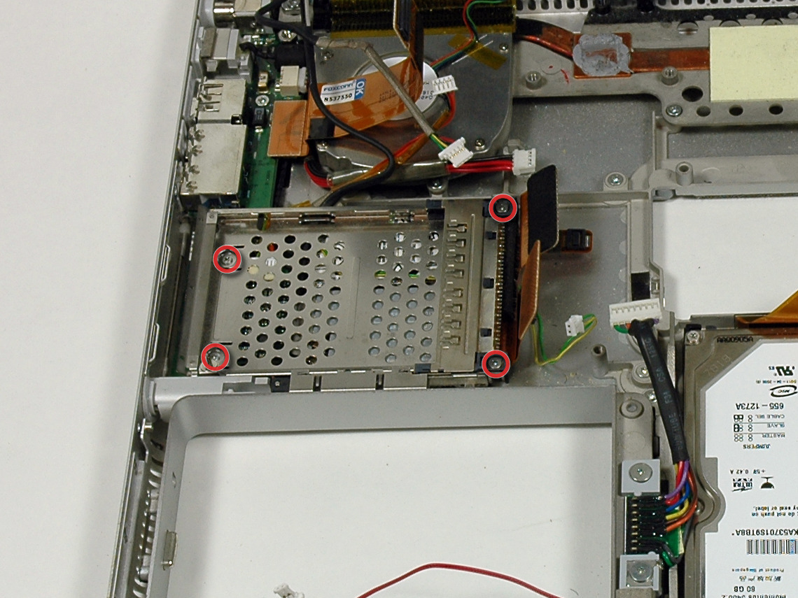

Remove the following 10 screws:
Two 3 mm Phillips in the battery compartment, on either side of the battery contacts.
Four 3 mm Phillips around the memory compartment.
Four 16 mm Phillips along the hinge.
Remove the memory compartment cover.
Remove the two 12 mm Phillips screws on the Aluminum bracket at the top of the memory compartment.

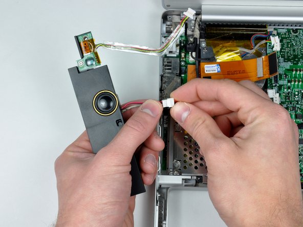

Remove the 12 mm Phillips screw holding the right speaker assembly to the lower case.

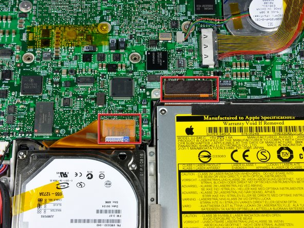

Disconnect the hard drive and optical drive connectors from the logic board.
Disconnect the right speaker cable connector.
De-route the right speaker cable and remove the speaker from the computer.

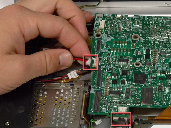

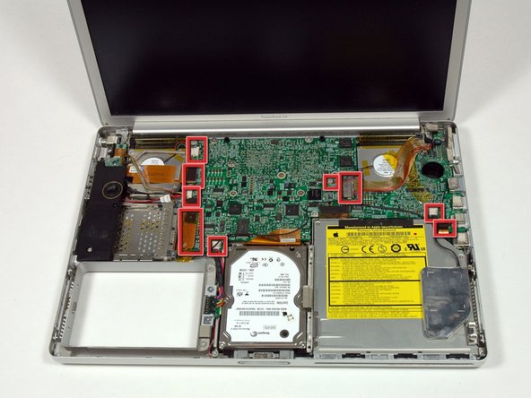

Disconnect the 11 remaining cable connectors, removing tape as necessary.

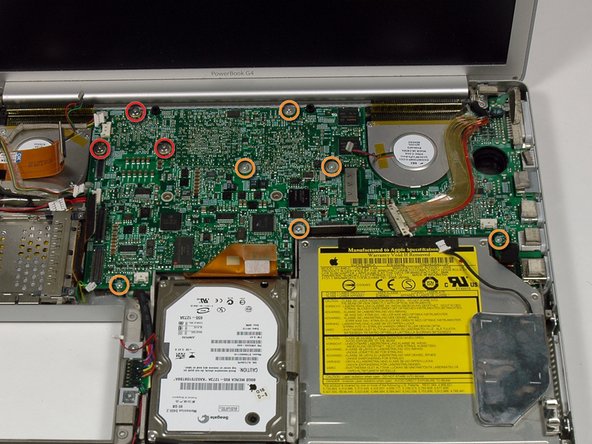

Remove the following 9 Phillips screws from the logic board:
Three 6.5 mm in the upper left corner.
Six remaining 4.5 mm.
Lift up the left side of the logic board enough to disconnect the black and red power cable from the left side of the logic board.
While the logic board is lifted, also disconnect the battery connector.

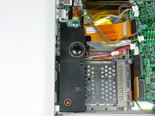

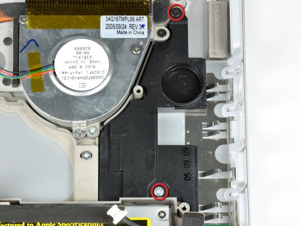

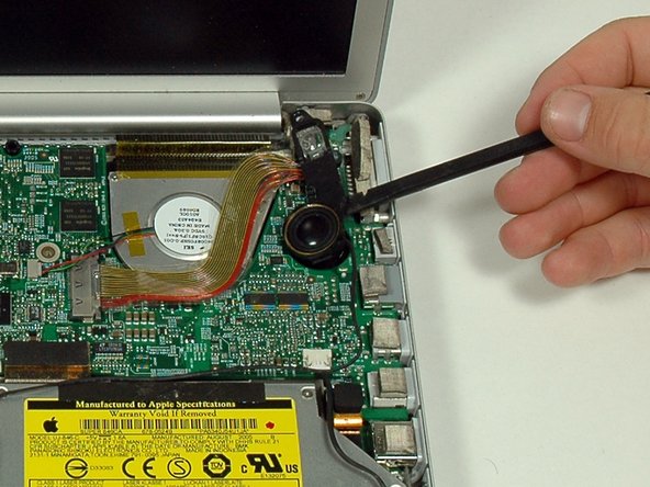

Remove the single black Phillips screw from the top of the left speaker housing.
Remove the 4 mm hex nut from the left speaker housing.
Lift the left speaker housing from the lower case and disconnect the microphone/speaker connector.

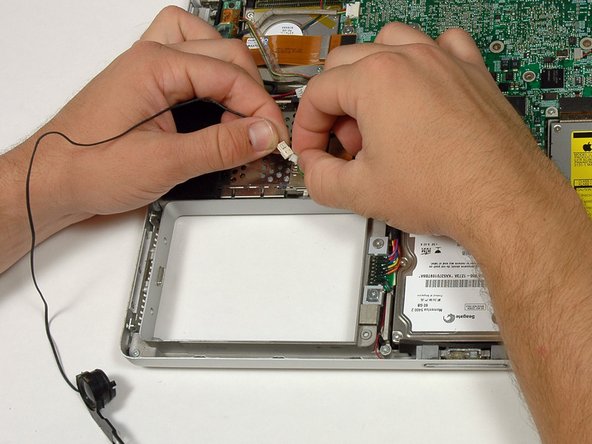

Lift the left side of the logic board and disconnect the modem cable from the underside of the logic board. A spudger is useful for freeing the connector from its adhesive.

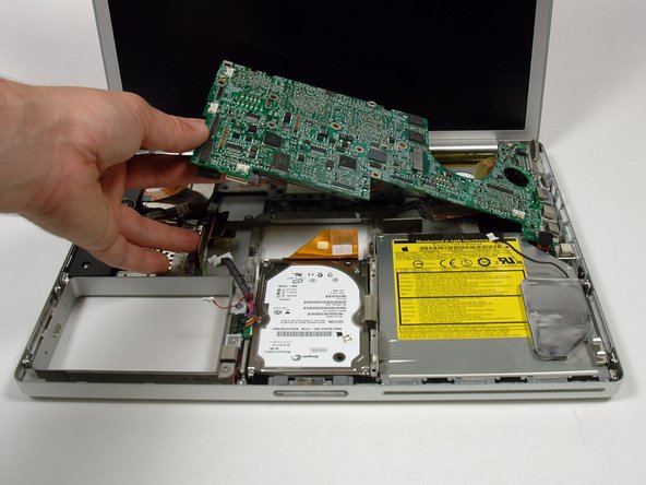

Very gently lift up the left side of the logic board.
Lift the left edge of the board up to approximately a 30 degree angle (if you don't have your protractor handy, just lift until the DVI port clears the right hinge).
Once the logic board clears the ports, slide it out to the left.

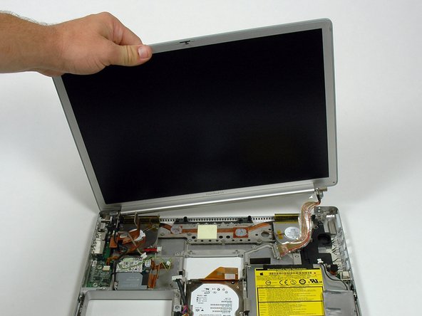

Close the display and turn the hinge side of the computer to face you.
Remove the remaining Phillips screws on either side of the hinge (two screws total).
Remove the two T8 Torx screws from each side of the display (highlighted in red boxes).

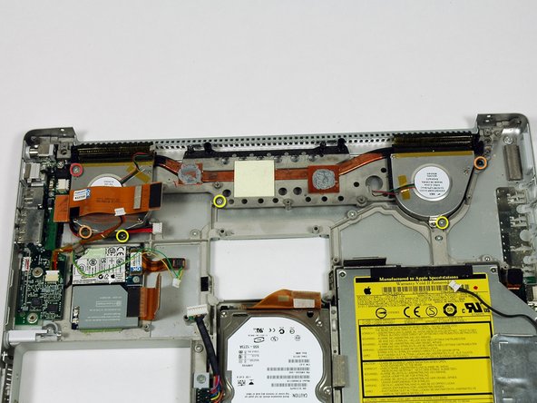

Disconnect the two antenna cables from the airport/bluetooth card (shown in yellow circles) and deroute them from under the other cabling.

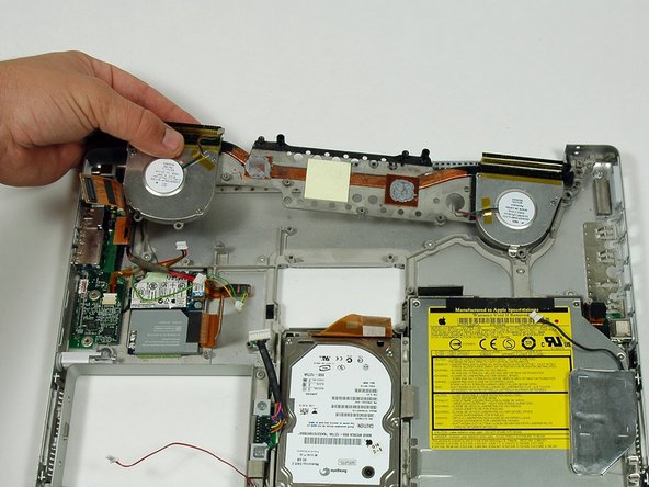

Remove the black and silver Phillips screws (two total) holding the right speaker housing to the lower case.
Remove the right speaker housing from the lower case.
Remove the following 6 screws:
One 9 mm Phillips.
Two black 5 mm Phillips.
Three silver 4 mm Phillips.

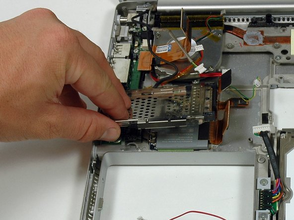

Step 18
For reassembly, it is much easier to keep the PC cage out, place this cable, and then install the PC cage.
Ben Ruiz - Reply
Step 19
It's very hard to put the underside cables back in their place,i recommend to remove the PC card cage to make more place for your fingers!
joelc - Reply
It is much, MUCH easier if you take out the screen before messing around with the logic board. On the way back is also easier if you put the logic board before the screen.
Carlos Ferrari - Reply

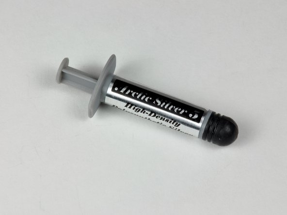

Step 28
When reasembling the heatsink you should pay attention to see if it really is touching the processor and videocard chips or you might end up with dangerous overheating glitches. I had to bend mine a little AND use some tape to keep it bent so it would touch the videocard chip - and it took me LOT'S OF HOURS tearing it up and reasembling it back until I realize that was the culprit of the glitches I was getting...
