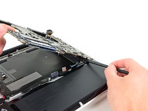

Replacing the heat sink requires removal of the logic board and application of new thermal paste.

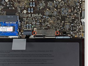

Image 1/2: Use the edge of a spudger to pry the battery connector upwards from its socket on the logic board. Image 2/2: It is useful to pry upward on both short sides of the connector to "walk" it out of its socket.
  • For certain repairs (e.g. hard drive), disconnecting the battery connector is not necessary but it prevents any accidental shorting of electronics on the motherboard. If you do not disconnect the battery connector, please be careful as parts of the motherboard might be electrified.
  • Use the edge of a spudger to pry the battery connector upwards from its socket on the logic board.
  • It is useful to pry upward on both short sides of the connector to "walk" it out of its socket.

At first sight I was confused when I read the description at this step, 'cause it seemed that disconnecting the battery connector was optional, in order to eliminate static discharge. While it's a helpful advice in other circumstances (as mentioned as an example changing hard drives), when changing the battery it is not an option - you have to disconnect the battery connector.
It would have been better to mention the optional disconnecting recommendation in a side-note.
Other than that, an excellent guide!
Damienn - Reply
the fact that this step is optional can not be stressed enough. i tried disconnecting the battery and in the process it short circuited which now leaves me with an even more expensive problem than i had before when i just wanted to change hard drives (at least the new hard drive works fine..)
the hard drive changing worked though.
nina - Reply

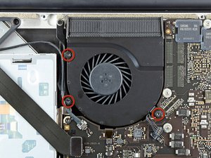

  • Remove the three 3.4 mm (3.1 mm) T6 Torx screws securing the left fan to the logic board.

Image 1/3: It is useful to twist the spudger axially from beneath the fan cable wires to release the connector. Image 2/3: The fan socket and the fan connector can be seen in the second and third pictures. Be careful not to break the plastic fan socket off the logic board as you use your spudger to lift the fan connector straight up and out of its socket. The layout of the logic board shown in the second picture may look slightly different than your machine but the fan socket is the same. Image 3/3: The fan socket and the fan connector can be seen in the second and third pictures. Be careful not to break the plastic fan socket off the logic board as you use your spudger to lift the fan connector straight up and out of its socket. The layout of the logic board shown in the second picture may look slightly different than your machine but the fan socket is the same.
  • Use the flat end of a spudger to disconnect the left fan connector from the logic board.
  • It is useful to twist the spudger axially from beneath the fan cable wires to release the connector.
  • The fan socket and the fan connector can be seen in the second and third pictures. Be careful not to break the plastic fan socket off the logic board as you use your spudger to lift the fan connector straight up and out of its socket. The layout of the logic board shown in the second picture may look slightly different than your machine but the fan socket is the same.

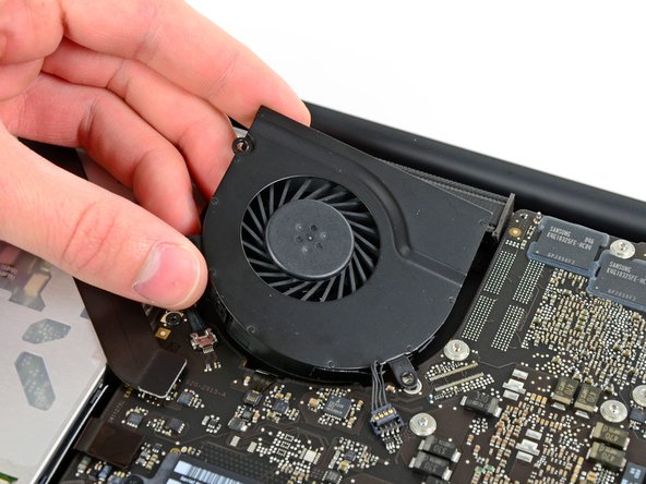

Image 1/1:
  • Lift the left fan out of the upper case.

Managed to break off a fan connector. Really poor mistake there, as it really is not too hard. Follow exactly like the picture and realize that it lifts up! But good news, I managed to break one of the least important parts and the computer still runs fine!
Sam - Reply

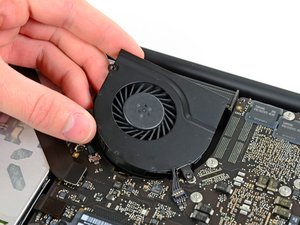

Image 1/2: Lift the right fan out of its opening in the logic board. Image 2/2: Lift the right fan out of its opening in the logic board.
  • Remove the three 3.4 mm (3.1 mm) T6 Torx screws securing the right fan to the logic board.
  • Lift the right fan out of its opening in the logic board.

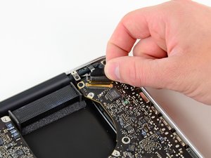

Image 1/1: Don't lift upward on the camera cable as you disconnect it. Pulling upward on the cable may damage both the cable and the logic board. Pull the cable parallel to the face of the logic board.
  • Pull the camera cable out of its socket on the logic board.
  • Don't lift upward on the camera cable as you disconnect it. Pulling upward on the cable may damage both the cable and the logic board. Pull the cable parallel to the face of the logic board.

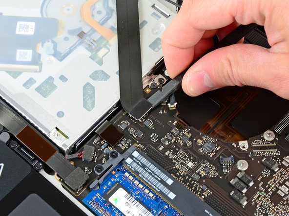

Image 1/1:

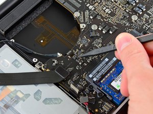

  • Use the flat end of a spudger to pry the AirPort/Bluetooth connector up from its socket on the logic board.
Image 1/1:
  • Use the flat end of a spudger to lift the optical drive connector out of its socket on the logic board.
Image 1/1:
  • Disconnect the hard drive/IR sensor cable from its socket on the logic board by lifting up from beneath its connector.

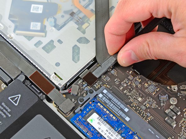

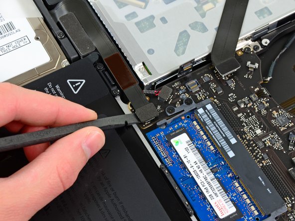

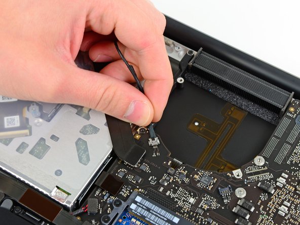

Image 1/1: Pry up from beneath the wires.

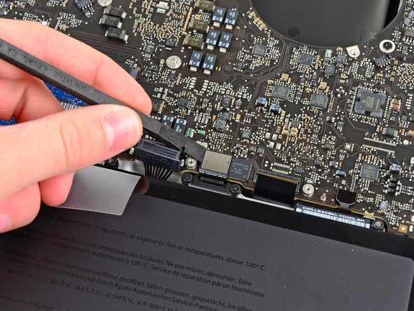

  • Use the flat end of a spudger to lift the subwoofer/right speaker connector out of its socket on the logic board.
  • Pry up from beneath the wires.
Be really, really careful detaching this connector - make sure it's lifted from the cable side. I managed to remove the whole lot from the logic board by accident. On mine it was disguised under a lump of rubber foam.
To replace it, I removed the socket, held it in place against the solder pads and ran a 750degF soldering iron across the pads. It's definitely reattached it, I'm not sure how good the electrical contacts are yet.
afoster - Reply

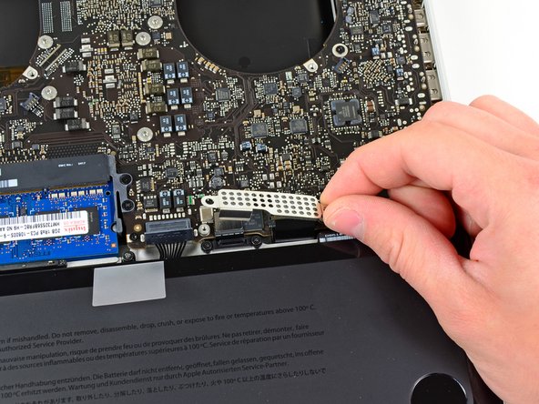

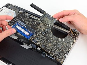

Image 1/2: Lift the cover off the logic board and set it aside. Image 2/2: Lift the cover off the logic board and set it aside.
  • Remove the two 1.5 mm ( 1.2 mm ) Phillips screws securing the keyboard/trackpad cable cover to the logic board.
  • Lift the cover off the logic board and set it aside.
Be sure to use the right size screwdriwer, as these screws might be hard to remove. I ended up having to cut the metal cover and bend it away as the screws wouldn't come loose.
That works too however..
dmitri - Reply

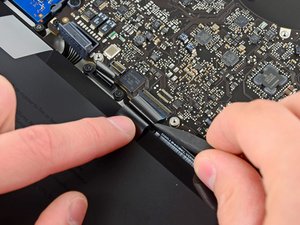

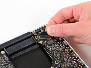

Image 1/1:
  • Use the flat end of a spudger to pry the trackpad connector up and out of its socket on the logic board.

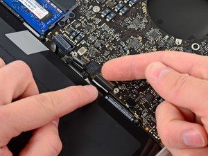

Image 1/2: Be sure you are prying up on the hinged retaining flap, '''not''' the socket itself. Image 2/2: Use the tip of a spudger to pull the keyboard ribbon cable out of its socket.
  • Use your fingernail to flip up the retaining flap on the keyboard ribbon cable ZIF socket.
  • Use the tip of a spudger to pull the keyboard ribbon cable out of its socket.
Need a better picture of the zif connector. You lift the lock from the side farthest from the flat cable, and it lifts toward the cable. When reinserting be sure to get the cable all the way or you may have only half the keyboard working.
Jim - Reply
I could use some advice on reinserting the ZIF cable firmly in its socket. I can get it started, but getting it far enough in to make contact is difficult, given its flexibility. Any tips on manipulating it?
CJ Attias - Reply
I used a piece of sticky tape that I attached to the ZIF cable, then pulled firmly on the tape (attached to the cable) to get the ZIF cable to seat properly. The tape held to the cable, the ZIF cable seated properly, and the keyboard worked.
robertemcgee -
getting the cable back in was leaps and bounds more difficult than this entire replacement job! be very very careful and note that it goes alllll the way in. i bent the ribbon like crazy, but the keyboard still seems to work fine!
shmianco - Reply

Image 1/1:
  • Use the flat end of a spudger to lift the battery indicator connector up and out of its socket on the logic board.
Image 1/2: Pull the display data cable straight out of its socket on the logic board. Image 2/2: Do not lift up on the display data cable, as its socket is very fragile. Pull the cable parallel to the face of the logic board.
  • Grab the plastic pull tab secured to the display data cable lock and rotate it toward the DC-In side of the computer.
  • Pull the display data cable straight out of its socket on the logic board.
  • Do not lift up on the display data cable, as its socket is very fragile. Pull the cable parallel to the face of the logic board.
The metallic flap controlled by the plastic handle looks like it could easily break... a safer route is to grab the shielded cable after rotating the metal flap out of socket and gently pry it out of the socket by applying force parallel to the logic board. It will probably take a few minutes but you could save yourself some gray hairs.
This is the hardest step IMO
brbulic - Reply
Indeed this s the hardest step.its not clear from the instruction that there are two elements to this component. The connector and also a metal retaining clip that needs to be rotated off the connector first.
mail - Reply
this was the hardest part of the dismantling for me. it's not super obvious in the pictures that there is a hinge and the metal piece, attached with tape, swings over and towards the DC-in.
shmianco - Reply
I found it easiest to grab the connector where the hinged metal piece connected to the body.
Replacing this connector was a bit fiddly, as you have to make sure it's lined up exactly before pushing it in, and because pushing it in requires a bit of force.
Kyle - Reply
"Pull the cable straight" means to slide the connector out, do not lift and pull. Also, check for a square locking clip attached to the plug, if it won't come out.
kevicoll409 - Reply
I really advise you to remove the cable retainer (one 8.6 phillips, you can see a photo in the display replacement tutorial) BEFORE unplugging the cable, to have more freedom of movement (to plug it in back it's even more important). Those are REALLY flimsy (i just broke one without being brutal and believe me you don't want to change it).
Bonachera - Reply
Image 1/2: Be sure you are flipping up the hinged retaining flap, '''not''' the socket itself. Image 2/2: Pull the keyboard backlight ribbon cable out of its socket.
  • Use the tip of a spudger to flip up the retaining flap on the keyboard backlight ribbon cable ZIF socket.
  • Be sure you are flipping up the hinged retaining flap, not the socket itself.
  • Pull the keyboard backlight ribbon cable out of its socket.
Connector slides out, do not lift and pull.
kevicoll409 - Reply
Image 1/1: Seven 3.4 mm ( 3.1 mm) T6 Torx screws on the logic board
  • Remove the following nine screws:
    • Seven 3.4 mm ( 3.1 mm) T6 Torx screws on the logic board
    • Two 8 mm T6 Torx screws on the DC-In board
Remove T6 (smaller) screws first, that was the last screwdriver that you used (for smooth workflow).
kevicoll409 - Reply

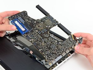

Image 1/3: If necessary, use the flat end of a spudger to separate the microphone from the upper case. Image 2/3: Pull the I/O port side of the logic board away from the side of the upper case and remove the logic board assembly. Image 3/3: Pull the I/O port side of the logic board away from the side of the upper case and remove the logic board assembly.
  • Carefully lift the logic board assembly from its left side and work it out of the upper case, minding the optical drive cable and the I/O ports that may get caught during removal.
  • If necessary, use the flat end of a spudger to separate the microphone from the upper case.
  • Pull the I/O port side of the logic board away from the side of the upper case and remove the logic board assembly.
I had a little difficulty pulling the motherboard before the battery. I'm not sure why you would want to do it in the order listed here, but doing steps 23 and 24 first helped the board come out easier.
maccentric - Reply
The thing that caught me on this step was that, at least on mine, the speaker box was glued/taped to the case, and so I got rather nervous trying to remove the logic board as it wouldn't move until said adhesive was pried apart. Thank goodness I knew the difference between the sounds of "board breaking" and "adhesive separating", but this step was still rather harrowing for me.
Joseph Sikorski - Reply
The microphone cable was easy to pry off the logic board for disassembly. For re-assembly, I was having a heck of a time getting the connector to connect to the logic board. There just isn't enough room to get your hands and tools in there and still see what you're doing (unless you're a dentist and you're used to that kind of thing). Anyway, I finally got brave and pulled the round, rubberized microphone from the case. I connected the short cable to the logic board, set the microphone in the made-for-the-microphone housing on the logic board, hoping it would stick itself back to the case once the logic board was in position, and I was back in business. In this case, simply stating "reverse these steps for reassembly" wasn't very forthcoming.
robk64 - Reply
When I did this step the microphone was REALLY STUCK to the upper case, it actually stayed stuck to it and disconnect "itself" from the mother board while I was lifting up everything.
Finally, there was no damage : I separated the microphone from the upper case while reassembling, then connected it back to the mother board and put it on its housing.
Greg - Reply
Count the number of connectors as you remove the board, so that when you put it back one does not get lost under the board and you can't figure out why it won't go in. You should do this.
kevicoll409 - Reply
Image 1/1: Remove the six #1 Phillips screws securing the heat sink to the logic board.
  • Lay the logic board down on a soft flat surface with the heat sink facing up.
  • Remove the six #1 Phillips screws securing the heat sink to the logic board.
  • Keep track of the small springs housed under each screw.
Image 1/1: If the heat sink appears to be stuck to the logic board after removing all six screws, it may be helpful to use a spudger to separate the two components.
  • Remove the heat sink from the logic board.
  • If the heat sink appears to be stuck to the logic board after removing all six screws, it may be helpful to use a spudger to separate the two components.
  • If you need to mount the heat sink back onto the logic board, we have a thermal paste guide that makes replacing the thermal compound easy.
Are 3,5 grams of thermal paste enough for both CPU and GPU? ('m an owner of a MacBook Pro Early 2011, with the AMD Radeon)
Zamir Hashorva - Reply
