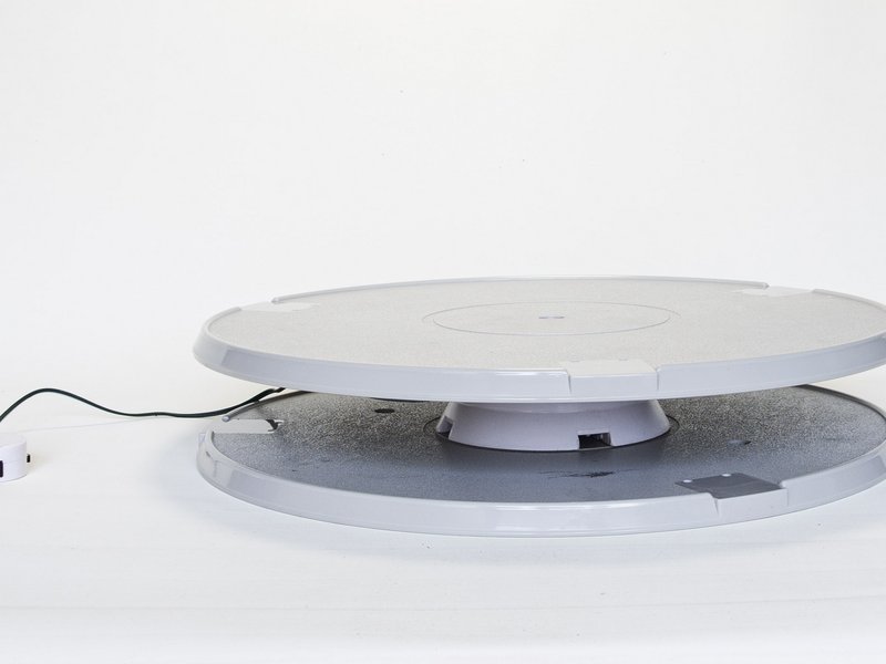

    1. Replacement of a Gearwheel in a Lightweight Carousel, or how to 3D print an existing gearwheel, Caroussel, description of parts: step 1, image 1 of 1
      • The turntable housing has two parts: a base and a cover. The table shaft runs through the cover and has a bottom centering point in the base housing. The gear wheel is mounted on the shaft with screws (not shown). The gearwheel has a groove, 1 mm deep, that fits into an annular ring of the cover, providing a top centering point.
      • All injection moulded parts are anonymous, i.e. they show no identification marks, by number or trade name. Motor rating is 3V 0.5A DC, max turntable load is 20 kg.

    2. Replacement of a Gearwheel in a Lightweight Carousel, or how to 3D print an existing gearwheel, Analysis: step 2, image 1 of 1
      • The gearwheel turns out to be broken, probably due to an unbalanced load of the table during transport Gearwheel is broken at its smallest cross section point: where the width is reduced to give room to the shaft notches.
      • The gearwheel has a triple function: gearwheel, centrepoint and ring to prevent that the turntable can be pulled out of the upper part of the housing. The gearwheel is driven by a brass worm-wheel, the motor shaft also has a brass worm-wheel. We do not bother here why there are only three legs.
      • photo shows part upside down as assembled
