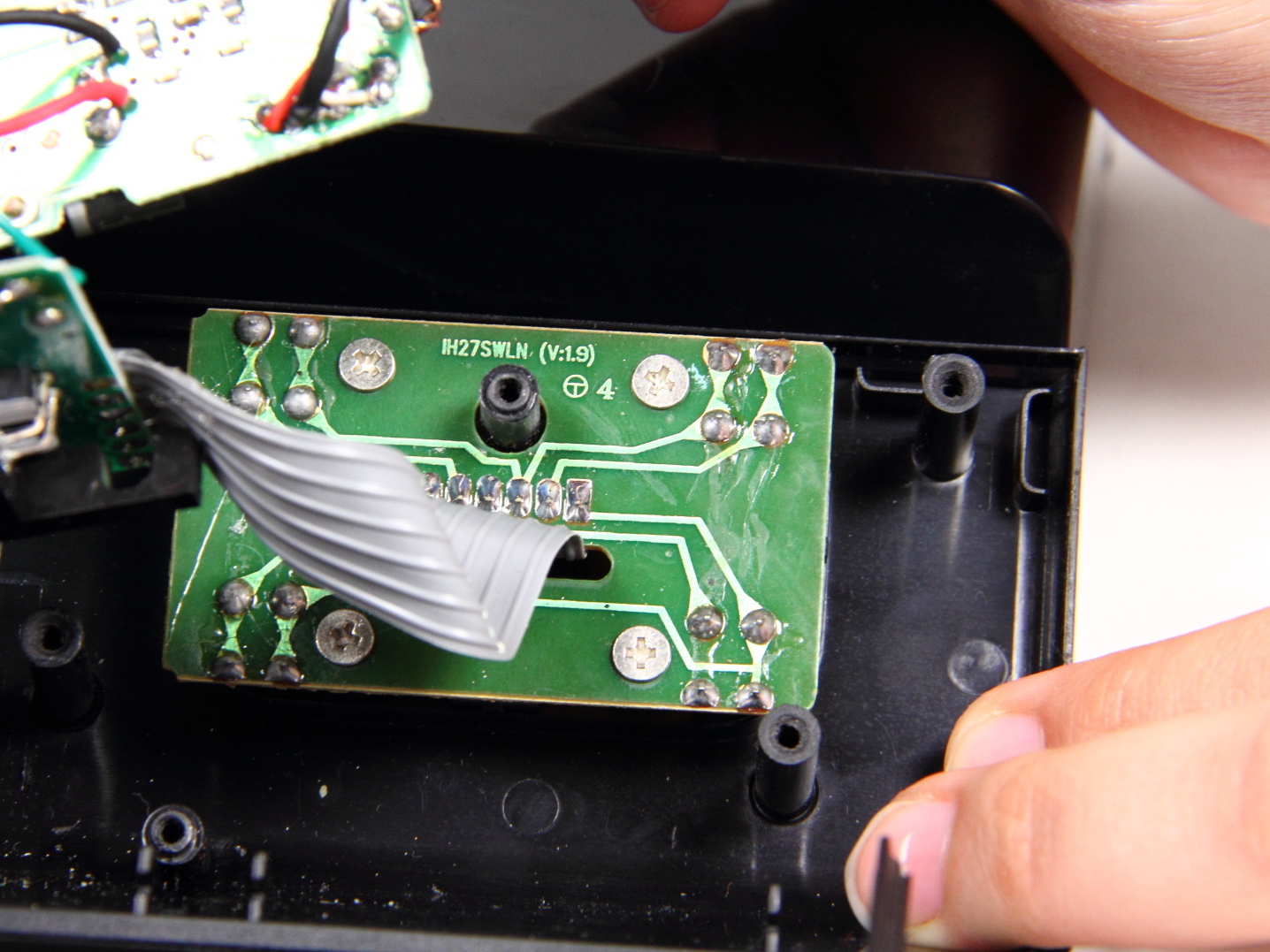

  10. iHome iH27B Right Control Button Replacement, Right Control Button: step 10, image 1 of 1
    • Remember that the device is still upside down, so the right control button will be on the left side. Then rotate the device so it looks as it does in the picture. Peek to verify you are going to the correct spot, because the iHome looks symmetrical at this point.
    • Carefully lift the main motherboard out of the way of the button control circuit board.
    • Remove the following screws:
    • Four 6 mm Phillips head screws
  11. iHome iH27B Right Control Button Replacement: step 11, image 1 of 1
    • Pull the button control motherboard up and out of the way.
    • Use a Flathead screwdriver to push on each of the button tabs.
    • Push the button away and out.
  12. iHome iH27B Right Control Button Replacement: step 12, image 1 of 1
    • Replace broken button with new one.

My volume decrease button was not working. I disassembled per these instructions, blew out the device with compressed air and then contact cleaner and reassembled per the reverse instructions. The screws in step 9 were slightly different (the same holes were there, but the presence/absence of screws was slightly different). I am now happily listening to my iHome right now. Thank you for posting this!!!
