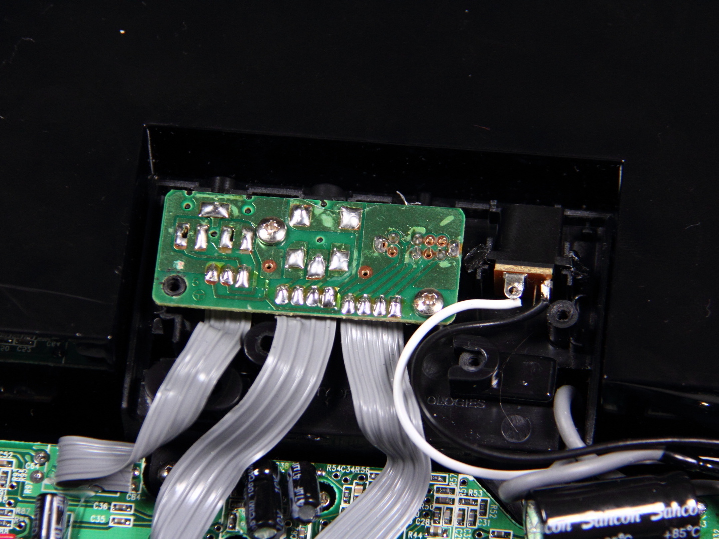

  5. iHome iH27B Power Connector Replacement: step 5, image 1 of 1
    • Slowly lift the plastic base towards you and lay it on the flat surface. The base should still be connected to the rest of the iHome by a few wires.
    • You should have visible access to most of the components inside the iHome now.

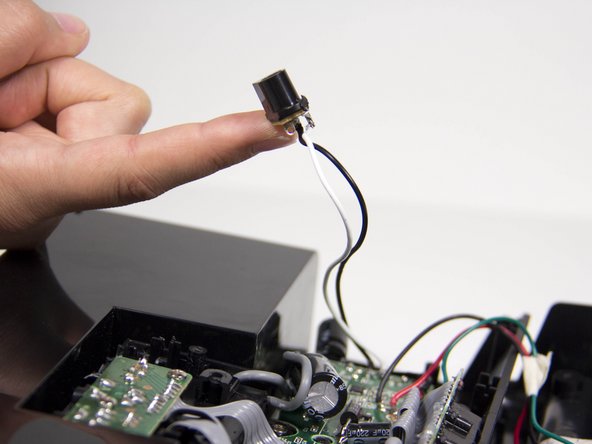

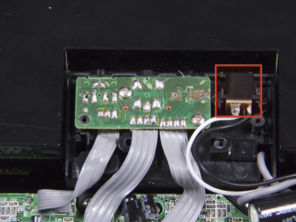

  6. iHome iH27B Power Connector Replacement, Power Connector: step 6, image 1 of 2 iHome iH27B Power Connector Replacement, Power Connector: step 6, image 2 of 2
    • Firmly grasp the power connector, which is the plastic rectangular piece with the white and black wires connected to it.
    • Pull upwards and dislodge the connector.
  7. iHome iH27B Power Connector Replacement: step 7, image 1 of 1
    • Using the scissors on your wire strippers, cut the connecting wires.
    • Using your wire strippers, remove about 1/4 " of the plastic tubing surrounding the end of your exposed wire, careful to not damage the wires.
    • Using a wire-nut or electrician's tape, connect the wires of the replacement power connector to your exposed wires. Connect white wire to white, and black to black.
