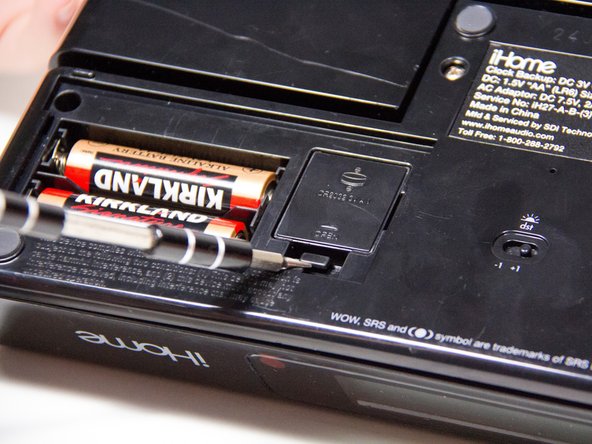

  2. iHome iH27B Left Control Button Replacement: step 2, image 1 of 3 iHome iH27B Left Control Button Replacement: step 2, image 2 of 3 iHome iH27B Left Control Button Replacement: step 2, image 3 of 3
    • Using your fingers, press down firmly on the plastic slide and push in the direction of the arrows shown above the word "Open" on the plastic.
    • Remove the plastic slide from its location and set it aside.
    • These plastic slides are not interchangeable, so make sure each goes back to its original location in reassembly.
    • Remove all 4 AA batteries by placing your fingernail at one end of the battery and applying force upwards until the battery is freed from its holder.

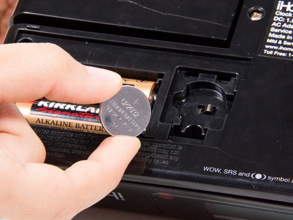

    • Insert your fingernail or a prying tool under the notch of the plastic slide that is protecting the watch battery.
    • Set the plastic covering and the watch battery aside.

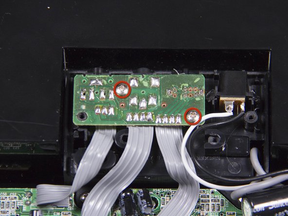

  6. iHome iH27B Left Control Button Replacement, AV circuit board: step 6, image 1 of 1
    • Remove the following screws:
    • Two 10 mm Phillips #0
  7. iHome iH27B Left Control Button Replacement: step 7, image 1 of 1
    • Pull out the AV circuit board and lift it up and out of the way to allow access to other components.

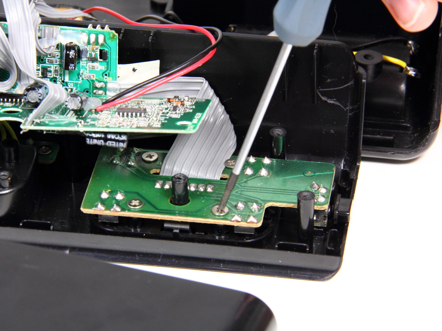

  10. iHome iH27B Left Control Button Replacement, Left Control Button: step 10, image 1 of 2 iHome iH27B Left Control Button Replacement, Left Control Button: step 10, image 2 of 2
    • Remember that the device is still upside down, so the left control button will be on your right hand side. Then rotate the device 180 degrees. You should see the device as it looks in the picture.
    • Carefully lift the iHome about an inch from your surface to verify you are going to the correct spot, because the iHome looks symmetrical at this point.
    • Carefully lift the main motherboard out of the way of the button control circuit board.
    • Four 6 mm Phillips #2
