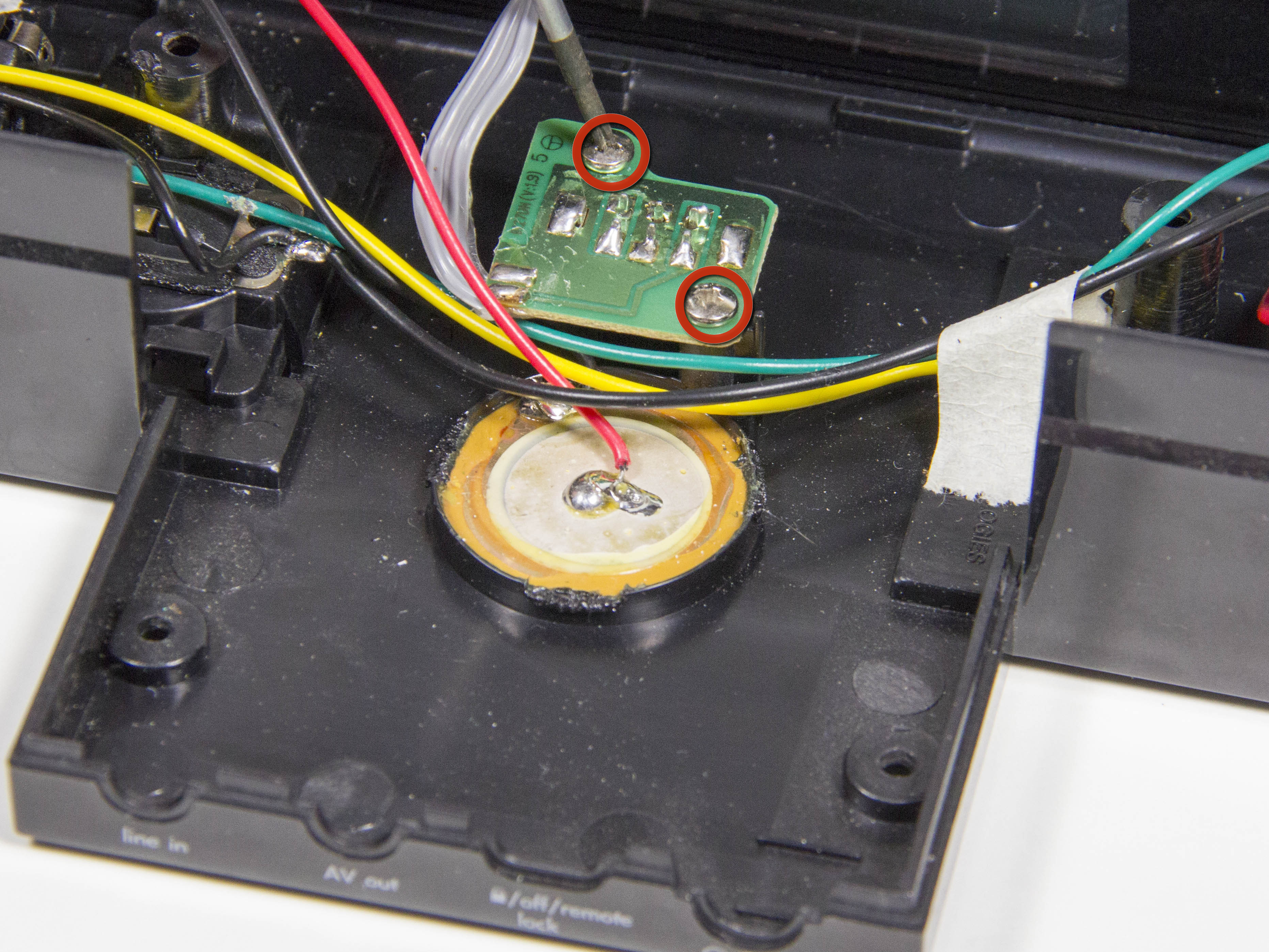

  6. iHome iH27B Daylight Savings Switch Replacement, Daylight Savings Switch: step 6, image 1 of 1
    • Remove the following screws:
    • Two 10 mm Phillips #0

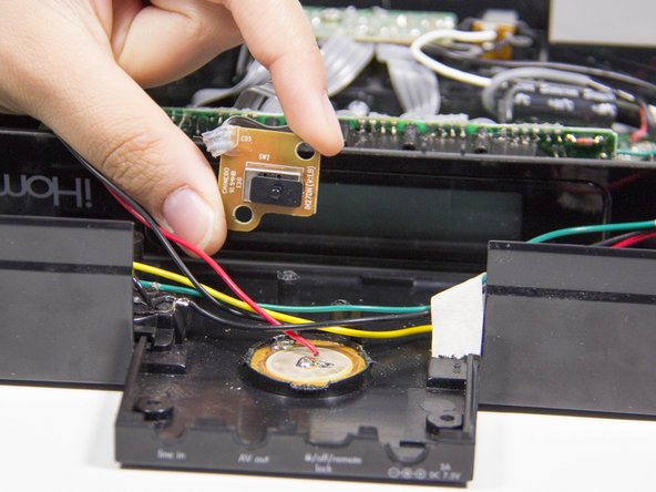

  7. iHome iH27B Daylight Savings Switch Replacement: step 7, image 1 of 1
    • Remove switch and replace with new one.
