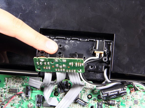

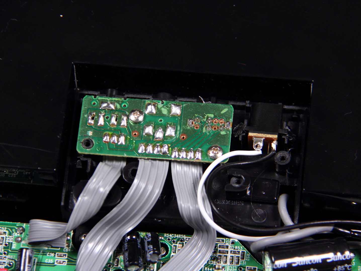

  6. iHome iH27B AV circuit board Replacement, AV circuit board: step 6, image 1 of 1
    • Remove the two 10 mm Phillips #0 screws attaching the circuit board to the case.
  7. iHome iH27B AV circuit board Replacement: step 7, image 1 of 1
    • Desolder each of the sets of grey wires as close as you can to the circuit board.
    • Retrieve your replacement board, making sure to align it the same way as your defective board was previously aligned.
    • Solder the ends of the grey wires to the same locations on the replacement motherboard as you had them on your original board. (Not pictured in this guide.)
