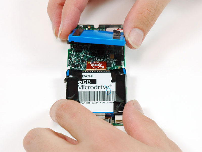

  11. iPod Mini Battery Replacement: step 11, image 1 of 1
    • Lift the battery off of the logic board and lay it to the side of the iPod.
  12. iPod Mini Battery Replacement: step 12, image 1 of 1
    • Carefully disconnect the battery from the logic board. Make sure to pull only on the connector and not on the battery wires.
