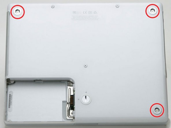

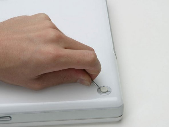

  • Use a pin (or anything you like) to remove the three rubber feet from the lower case.
Image 1/1:
  • Remove the three 5.2 mm newly-revealed Phillips screws.
Screw sizes are 2.5mm x 6mm flat low profile head or cheese head.

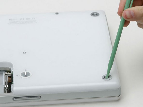

  • Use a spudger or small flathead screwdriver to pry up the three metal rings that housed the rubber bumpers.

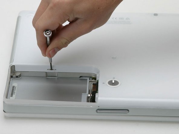

  • Remove the one 10 mm and two 20 mm hex screws using a 2mm hex. Alternatively, a T8 Torx screwdriver key will do.
FYI, the two screws at the top of this picture are longer than the one in the middle of the case. Don't mix them up!
JuciusMaximus - Reply
Top screws are 20 mm, middle one is 10 mm. These have thread lock.
commenter - Reply
The 3 long screws (not the ones under the rubber feet) are 2.5mm x 20mm metric. Head style is cheese head. i found replacements for these at ACE hardware, for about $0.08 each in a flat head drive style which IMO are better than the hex style that can easily be stripped.
XnriquX - Reply

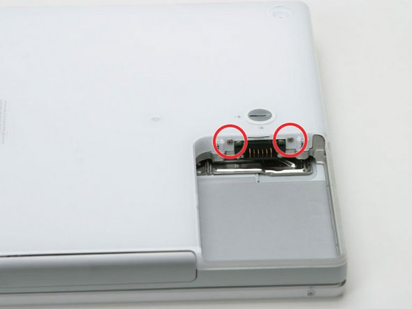

  • Remove the two 4.2 mm Phillips screws on either side of the battery contacts.

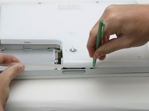

Image 1/1:
  • Run a spudger along the seam between the lower case and upper case on the front of the computer to free the tabs locking the lower case. Pull up on the lower case and continue to use the spudger as necessary until you hear three distinct clicks.

  • Once the front and sides of the lower case are free, turn the computer so that the back is facing you and pull the lower case up and toward you until the back tabs pop free (it may be helpful to jiggle the case up and down).
You might wanna use your spudger to pry up those back tabs to. You might break the bottom case just wiggling around waiting for it to pop loose.

Be aware that you may need to use a spudger at the front of the computer to separate the metal shield from the bottom case.
michael leahy - Reply

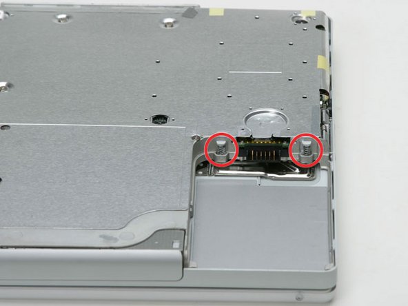

  • Remove the small greasy springs with white plastic caps from either side of the battery contacts.
