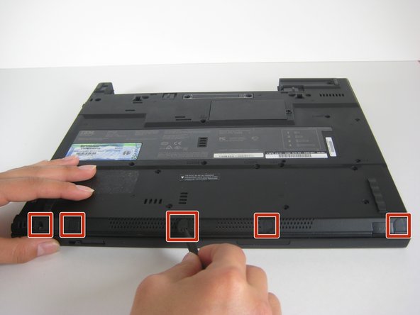

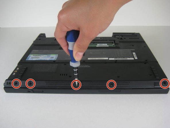

  5. IBM ThinkPad T41 Motherboard Replacement, Trackpad: step 5, image 1 of 1
    • Close the laptop and turn it over.
    • Remove the five plastic stickers covering the screws on the front edge of the case.
    • In order to reuse the stickers, remove them carefully.
  6. IBM ThinkPad T41 Motherboard Replacement: step 6, image 1 of 1
    • Unscrew the five screws that were hidden by the stickers.
  7. IBM ThinkPad T41 Motherboard Replacement: step 7, image 1 of 1

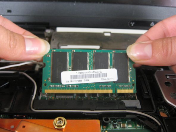

  9. IBM ThinkPad T41 Motherboard Replacement, RAM: step 9, image 1 of 1
    • Push apart the retaining clips on the RAM.
    • Note: The RAM should pop up a little bit.
  10. IBM ThinkPad T41 Motherboard Replacement: step 10, image 1 of 1
    • Lift out the RAM chip.

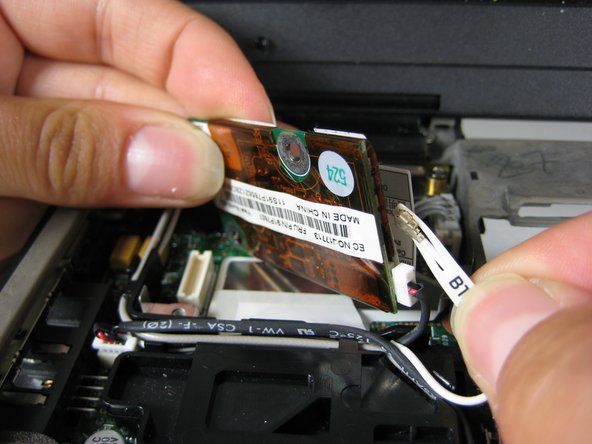

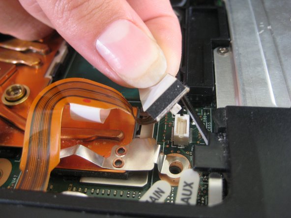

  11. IBM ThinkPad T41 Motherboard Replacement, Wireless Network Card: step 11, image 1 of 1
    • Pull off the one black and one white coaxial cables by lifting the tabs labeled main and aux (for auxiliary).
  12. IBM ThinkPad T41 Motherboard Replacement: step 12, image 1 of 1
    • Push apart the retaining clips.
    • Note: The card should pop up a little bit.
  13. IBM ThinkPad T41 Motherboard Replacement: step 13, image 1 of 1
    • Pull the wireless network card out.

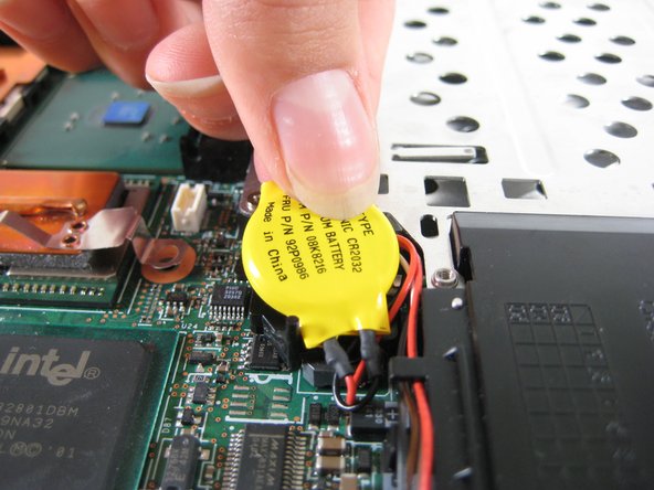

  14. IBM ThinkPad T41 Motherboard Replacement, CMOS Battery: step 14, image 1 of 1
    • Lift the yellow plastic-covered battery up.
  15. IBM ThinkPad T41 Motherboard Replacement: step 15, image 1 of 1
    • Unplug the battery connector.

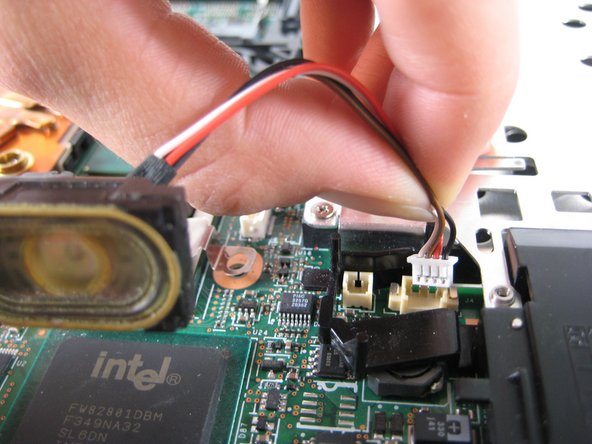

  16. IBM ThinkPad T41 Motherboard Replacement, Speakers: step 16, image 1 of 1
    • Lift the speakers out by starting with the left end and then unsnake the wires.
  17. IBM ThinkPad T41 Motherboard Replacement: step 17, image 1 of 1
    • Unplug the wires from the motherboard.

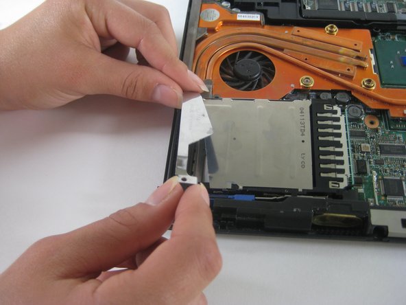

  20. IBM ThinkPad T41 Motherboard Replacement: step 20, image 1 of 1
    • Pull the sheet metal cover away from slot.
  21. IBM ThinkPad T41 Motherboard Replacement: step 21, image 1 of 1
    • Lift out the expansion slot by starting at the entrance hole and pulling upward.
    • Note: Try wiggling the slot from side to side until it comes out all the way.

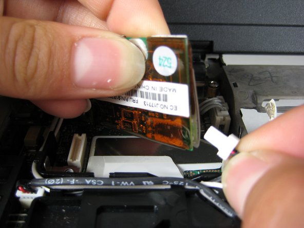

  22. IBM ThinkPad T41 Motherboard Replacement, Modem: step 22, image 1 of 1

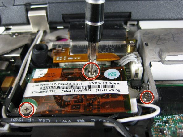

    • Remove the three screws holding down the modem in the upper left corner of the laptop.
  23. IBM ThinkPad T41 Motherboard Replacement: step 23, image 1 of 1
    • Lift the modem up, unplugging it from the motherboard as you lift.
  24. IBM ThinkPad T41 Motherboard Replacement: step 24, image 1 of 2 IBM ThinkPad T41 Motherboard Replacement: step 24, image 2 of 2
    • Pull out the wire that connects the modem to the screen.
    • Unplug the other cable that attaches the modem to the motherboard

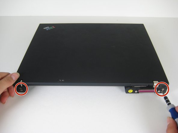

  25. IBM ThinkPad T41 Motherboard Replacement, Screen: step 25, image 1 of 1
    • Close the computer screen.
    • Remove the four screws on the back of the laptop, near the right and left hinges.

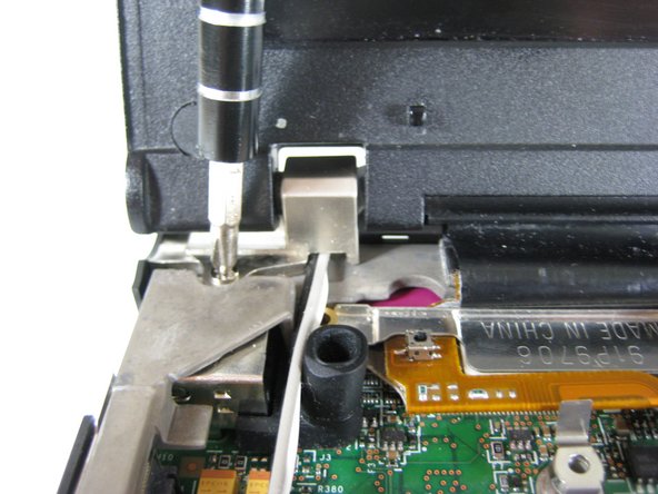

    • Open the laptop screen.
    • Remove the single screw that secures the left hinge to top of the computer.

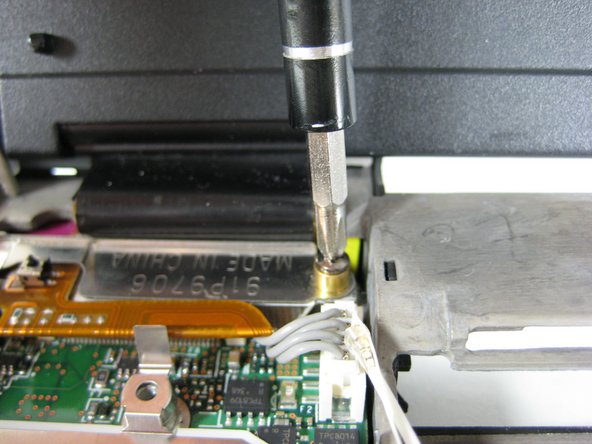

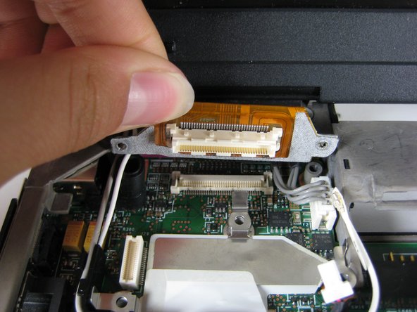

    • Remove a single screw from the metal plate that secures the display cable.
  28. IBM ThinkPad T41 Motherboard Replacement: step 28, image 1 of 1
    • Pull the metal plate away from the display cable.

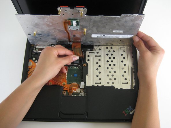

  29. IBM ThinkPad T41 Motherboard Replacement: step 29, image 1 of 1
    • Disconnect the display cable.
  30. IBM ThinkPad T41 Motherboard Replacement: step 30, image 1 of 1

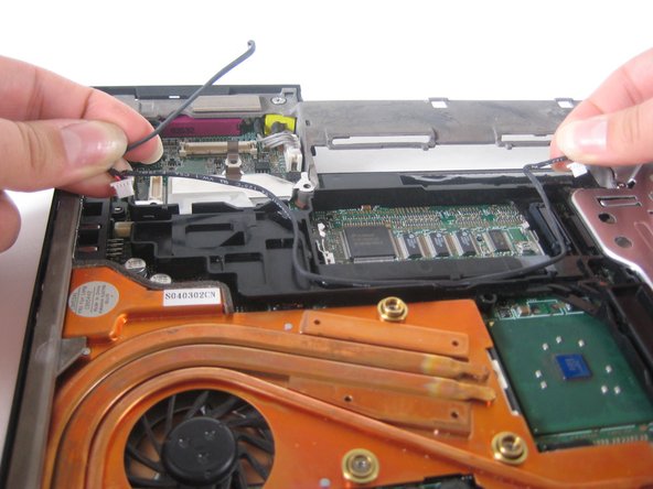

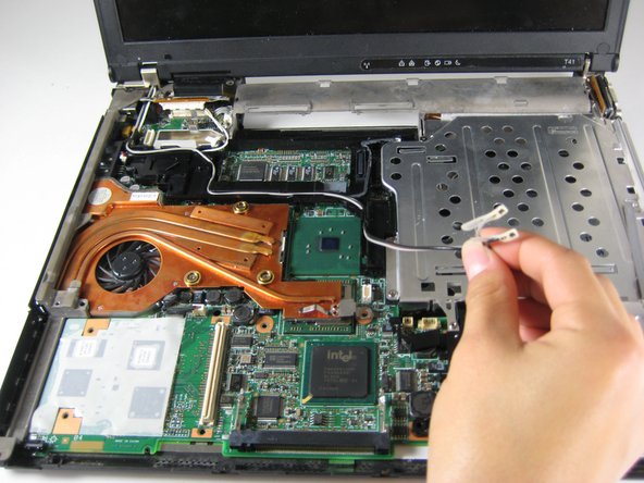

    • Carefully pull up the long antenna cables that were attached to the wireless network card.
  31. IBM ThinkPad T41 Motherboard Replacement: step 31, image 1 of 1
    • Lift out the screen.

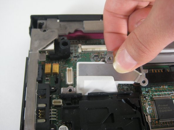

    • Remove the sheet metal piece, which was underneath the modem.
  34. IBM ThinkPad T41 Motherboard Replacement: step 34, image 1 of 1

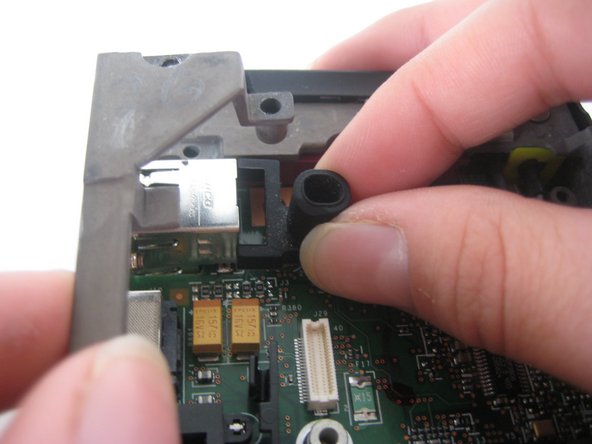

    • Remove the rubber microphone cover in the upper left hand corner by lifting up the gray metal frame.
  35. IBM ThinkPad T41 Motherboard Replacement: step 35, image 1 of 1
    • Lift away the gray metal frame.

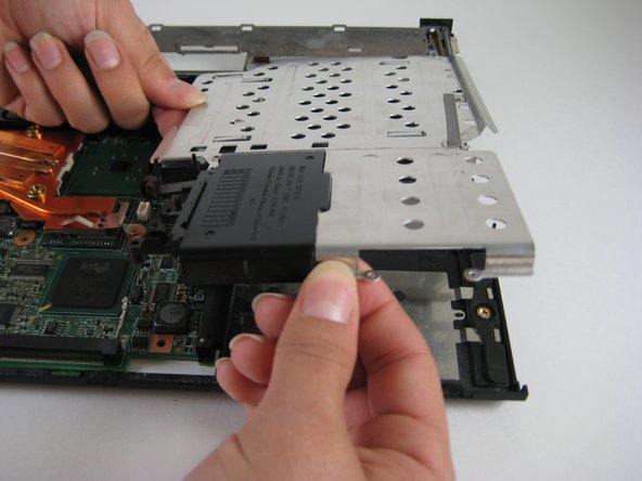

  37. IBM ThinkPad T41 Motherboard Replacement: step 37, image 1 of 1
    • Lift out the optical bay and HDD covers.

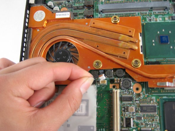

    • Unplug the fan from the motherboard.
  40. IBM ThinkPad T41 Motherboard Replacement: step 40, image 1 of 1
    • Remove the three screws on the fan.
  41. IBM ThinkPad T41 Motherboard Replacement: step 41, image 1 of 1
    • Lift the fan out.

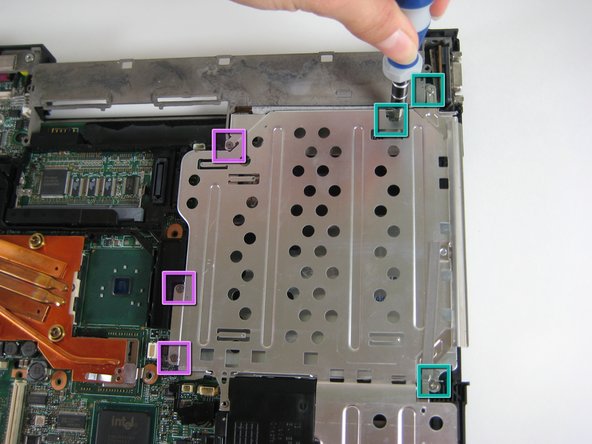

  43. IBM ThinkPad T41 Motherboard Replacement, Motherboard: step 43, image 1 of 1

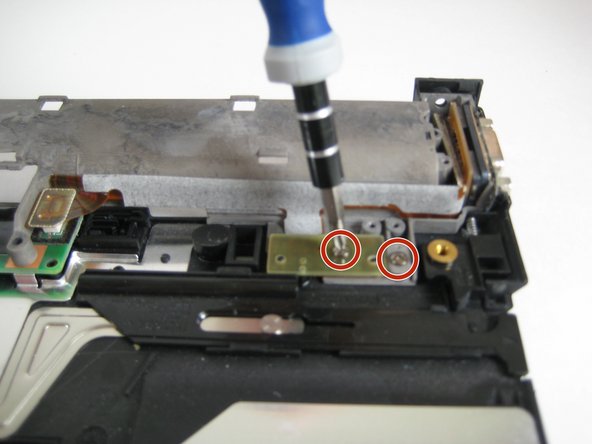

    • Remove the two screws in the upper right corner that secure the gray metal frame.
  44. IBM ThinkPad T41 Motherboard Replacement: step 44, image 1 of 1

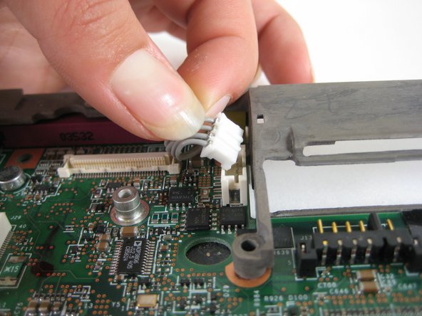

    • Unplug the small ribbon cable attached to the motherboard.

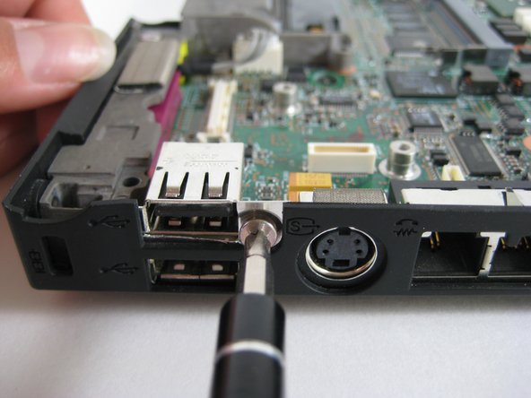

  45. IBM ThinkPad T41 Motherboard Replacement: step 45, image 1 of 1
    • Remove the single screw located next to the USB slots.
  46. IBM ThinkPad T41 Motherboard Replacement: step 46, image 1 of 1

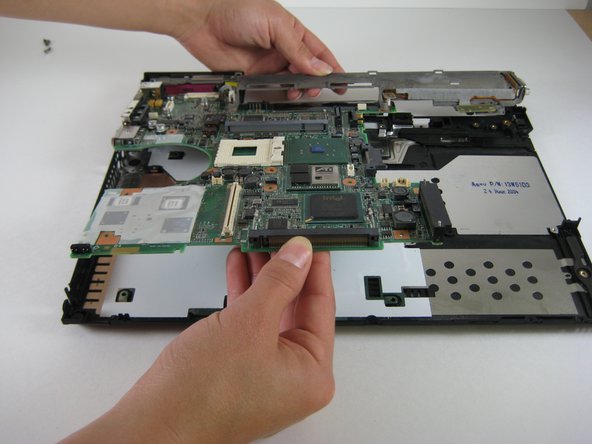

    • Rotate the device so that the front faces you.
    • Lift the entire motherboard assembly out of the case.

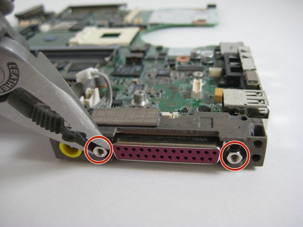

  48. IBM ThinkPad T41 Motherboard Replacement: step 48, image 1 of 1
    • Using a nut driver or a pair of thin nose pliers, remove the two stand off screws next to the pink parallel port on the back of the computer.

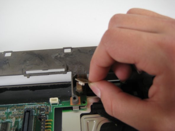

  49. IBM ThinkPad T41 Motherboard Replacement: step 49, image 1 of 1
    • Lift up the outer end of the grey metal frame.
    • Carefully rotate the frame clockwise to release it from the motherboard.
