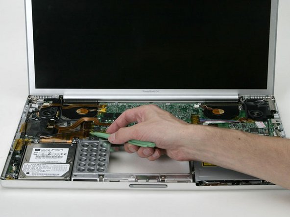

Image 1/1: Once the casing is entirely free, lift it off of the computer.
  • Use a spudger to loosen the casing if it sticks.
  • Once the casing is entirely free, lift it off of the computer.
BE VERY CAREFUL when replacing the keyboard to thread the keyboard ribbon cable through the slot. The steps didn't appear to make this warning and when I replaced all screws, found that it was jammed and would not come through to connect with the connector. I had to undo a lot of steps to go back and rethread it properly.
Ted - Reply
  • The sound ribbon cable is very fragile. Be especially careful when disconnecting the cable from the logic board.
  • Disconnect both ends of the orange sound ribbon cable that crosses over the hard drive, removing tape as necessary.

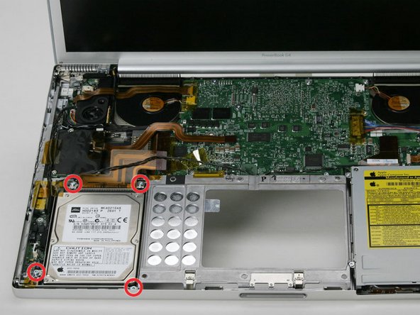

Image 1/1: Make sure you're removing the screws from the hard drive bracket, not the hard drive itself.
  • Remove the four T8 (lower right screw is 3.8 mm, the other 3 are 11 mm) Torx screws from the corners of the hard drive bracket.
  • Make sure you're removing the screws from the hard drive bracket, not the hard drive itself.

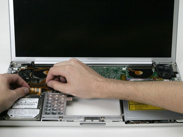

Image 1/1: Lift the hard drive and its attached cable out of the computer.
  • Deroute hard drive ribbon from beneath the speaker cable.
  • Lift the hard drive and its attached cable out of the computer.
on mine, the speaker wire was run under the IDE ribbon cable, so no rerouting was needed

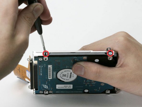

Image 1/1:
  • Remove the two silver Phillips screws from either side of the hard drive (four screws total).
On mine they are tiny Torx drive screws
John Blanning - Reply

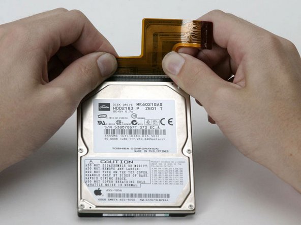

Image 1/1: This is a bit tricky. Try holding the drive against your body while pushing the cable away from you, or rocking the cable gently from side to side while applying even pressure, or both. If you bend the pins, do your best to straighten them, using the hard drive cable as a guide.
  • Disconnect the hard drive cable from the hard drive by applying even pressure on both sides while maintaining a firm grip on the drive itself.
  • This is a bit tricky. Try holding the drive against your body while pushing the cable away from you, or rocking the cable gently from side to side while applying even pressure, or both. If you bend the pins, do your best to straighten them, using the hard drive cable as a guide.
