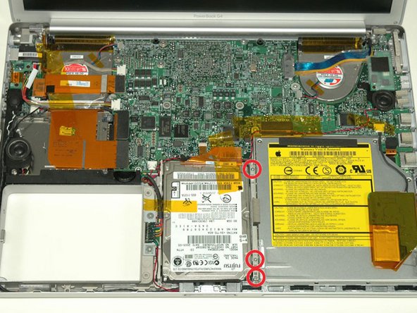

Image 1/1: Remove the retaining bracket.
  • Remove the three long silver Phillips screws from the retaining bracket on the left side of the optical drive.
  • Remove the retaining bracket.

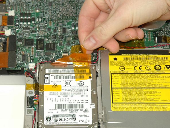

Image 1/1:
  • Disconnect the large orange hard drive cable from the logic board, removing tape as necessary.
It may be easier to leave the ribbon cable attached to the logic board and simply disconnect the other end from the drive after it is lifted out of the compartment slightly.
(Why pull more apart than necessary?)
This is how I did it when replacing the stock drive with a WD 320GB drive.
caffiend - Reply

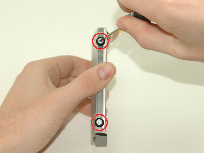

Image 1/1: There is a black pad on one end of the hard drive that you should peel off and transfer to your new hard drive.
  • Remove the two silver Phillips screws and black rubber bumpers from either side of the hard drive (four sets of screws and bumpers total).
  • There is a black pad on one end of the hard drive that you should peel off and transfer to your new hard drive.
  • Lift the plastic shield off of the hard drive.

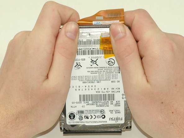

Image 1/1: This is a bit tricky. Try holding the drive against your body while pushing the cable away from you, or rocking the cable gently from side to side while applying even pressure, or both. If you bend the pins, do your best to straighten them, using the hard drive cable as a guide.
  • Disconnect the hard drive cable from the hard drive by applying even pressure on both sides while maintaining a firm grip on the drive itself. You may need to remove a piece of orange tape attaching the ribbon cable to the hard drive.
  • This is a bit tricky. Try holding the drive against your body while pushing the cable away from you, or rocking the cable gently from side to side while applying even pressure, or both. If you bend the pins, do your best to straighten them, using the hard drive cable as a guide.
  • If you are installing a new hard drive, we have an OS X install guide to get you up and running.
  • When re-installing the adapter cable, be sure to place it over the large field of pins so that the small connector lines up with the motherboard.
