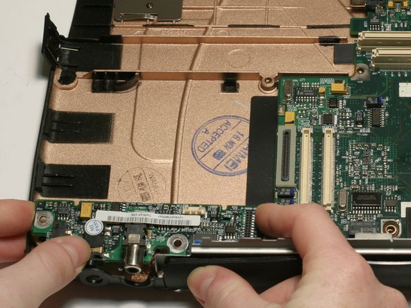

Image 1/1: Grasp the power card near the black plastic shield toward the center of the case and lift up.
  • Remove the single black T8 Torx screw from the power card.
  • Grasp the power card near the black plastic shield toward the center of the case and lift up.
  • Occasionally, a post connecting the power card to the logic board will come out with the power card.
  • Lift the sound card out by pulling up on both the right and left sides.
  • If the sound card sticks, pull the black metal wall of the casing toward you while lifting the right side of the sound card up.
