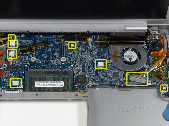

  • Disconnect the hard drive and ExpressCard connectors from the left side of the logic board.
Image 1/1:
  • Disconnect the eight indicated connectors from the logic board, removing tape as necessary.
I wish there was some tip or picture how to remove the tiny ones. I already broke the left als
Shann ell - Reply

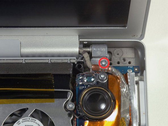

  • Remove the silver T6 Torx screw securing the ground loop on the display data cable to the casing.
Image 1/1: Lift the clear plastic shield off the right ambient light sensor.
  • Remove the single silver T6 Torx screw securing the clear plastic shield over the right ambient light sensor.
  • Lift the clear plastic shield off the right ambient light sensor.

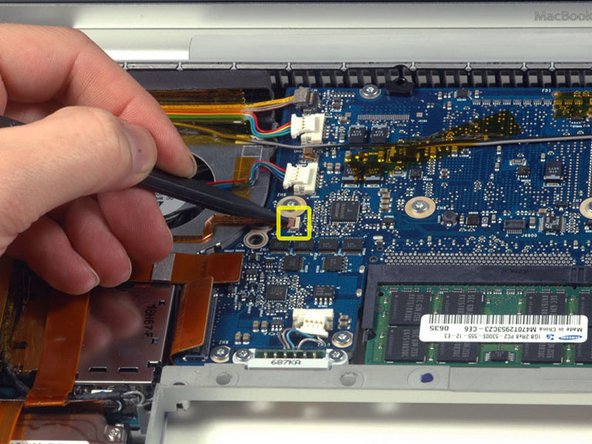

  • Peel up the orange Kapton tape securing the right thermal sensor cable to the logic board.

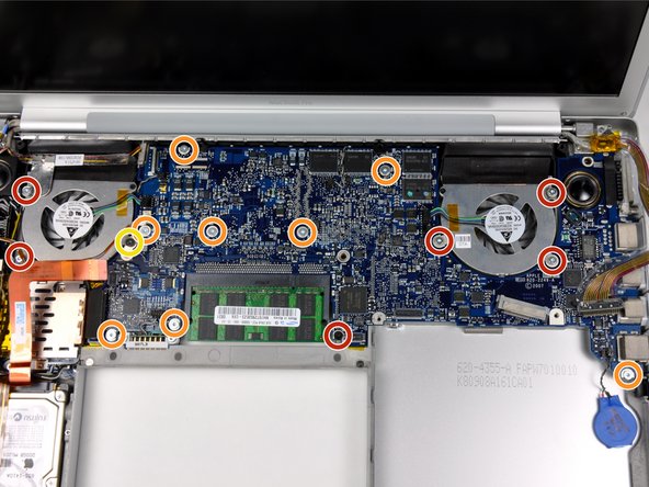

  • Remove the following 16 screws, moving cables as necessary:
    • One 4.4 mm black Phillips screw to the right of the RAM slot.
    • Nine 4.7 mm silver T6 Torx screws securing the logic board to the lower case.
    • One 6.2 mm black T6 Torx screw on the right side of the left fan.
    • Five 9.4 mm silver T6 Torx screws securing the left and right fans.
When reassembling, make sure all cables are above the logic board before you start putting the screws back in, especially the battery to logic board connector.
Steve S - Reply
And, even MORE especially, the heat sensor cable that attaches to the tiny white connector near the middle-left of the logic board. If you don't you have to take everything apart again when you get back to the step where you reattach all the cables.
Steve S - Reply

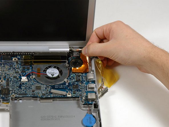

Image 1/1: Peel up and remove the orange foil shield near the right speaker.
  • Move the display data cable to the right, removing tape as necessary.
  • Peel up and remove the orange foil shield near the right speaker.

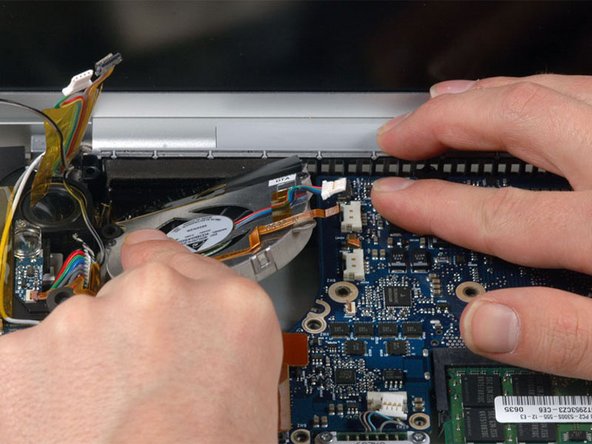

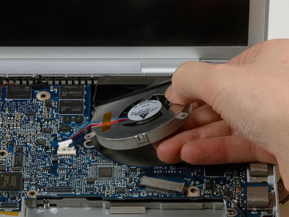

Image 1/1: Hold the logic board down with one hand and use your other hand to lift the left fan up from its housing. There is a piece of black tape securing the fan to the heat sink. Carefully peel this tape up from the heat sink as you lift the fan up.
  • Peel up the iSight and inverter board cables from above the left fan.
  • Hold the logic board down with one hand and use your other hand to lift the left fan up from its housing. There is a piece of black tape securing the fan to the heat sink. Carefully peel this tape up from the heat sink as you lift the fan up.
  • Place the fan above the Airport card. It is not necessary to entirely remove the fan from the computer.
When reassembling, the left fan goes under the black tab on the left speaker.

I would recommend actually removing the fan as it is just another flip connector like the other side of the ribbon cable. This way it is less likely to damage the ribbon and leaves the fan out of the way.
Sebastian Malton - Reply

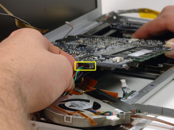

Image 1/1:

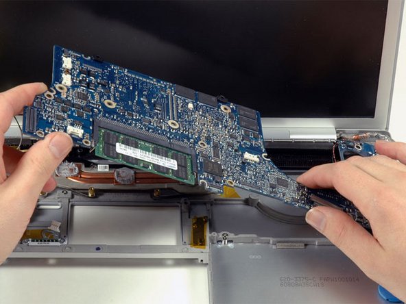

  • Lift up the left side of the logic board and disconnect the multi-colored power cable from the bottom of the board.
Image 1/1: Grasp the logic board at the left side and at the thin section, and rotate the logic board out of the lower case.
  • The logic board is still attached to the computer by one more cable, so don't lift the logic board too far out of the computer yet.
  • Grasp the logic board at the left side and at the thin section, and rotate the logic board out of the lower case.
  • To properly reassemble your MacBook Pro, you'll have to clean off and replace the old thermal compound from the chips on the back of the logic board. Use our Applying Thermal Paste Guide to prepare the processor and heat sink surfaces.

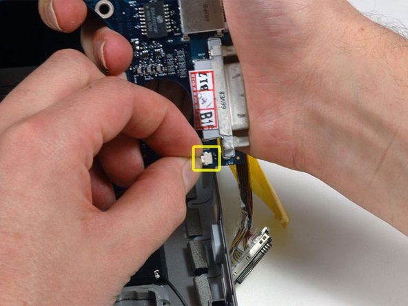

  • Disconnect the right thermal sensor cable from the bottom of the logic board near the DVI port.

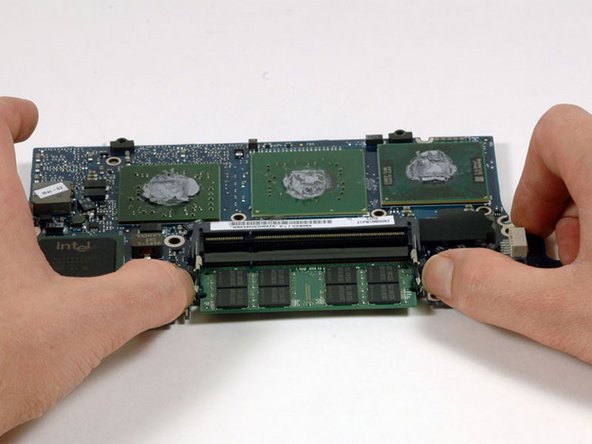

Image 1/1: Pull the chip directly out from its connector.
  • Release the tabs on each side of the RAM chip at the same time. These tabs lock the chip in place and releasing them will cause the chip to "pop" up.
  • Pull the chip directly out from its connector.
  • If there are two RAM chips installed, repeat the above procedure for the second chip.

Buying the part, it says that thermal paste is needed for installation. Where?
bjornarstople - Reply
Thermal paste is needed to transfer heat from the Nvidia GPU and the CPUs to the heat spreader bar which is located below the motherboard. It transfers heat from the CPUs to the fans.
Michael Pender - Reply
The final part says to just follow the steps in reverse order to reassemble--that isn't quite enough information. It is critical *not* to snug or overtighten the memory door screws from step 2. The screws pass to the bottom of the keyboard, and the keyboard is made of a light material that deforms easily. If you overtighten the screws it will bend the keyboard out of shape and the spacebar will not work properly.
After installing the screws on the memory door, then test that the space bar goes down and back up properly. If it doesn't back the screws out and try again. Do not proceed with the rest of reassembly if the keyboard is not working.
