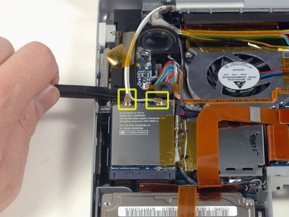

Image 1/1: The white antenna cable connects to the left side of the Airport Extreme card.
  • Disconnect the two antenna cables attached to the Airport Extreme card.
  • The white antenna cable connects to the left side of the Airport Extreme card.

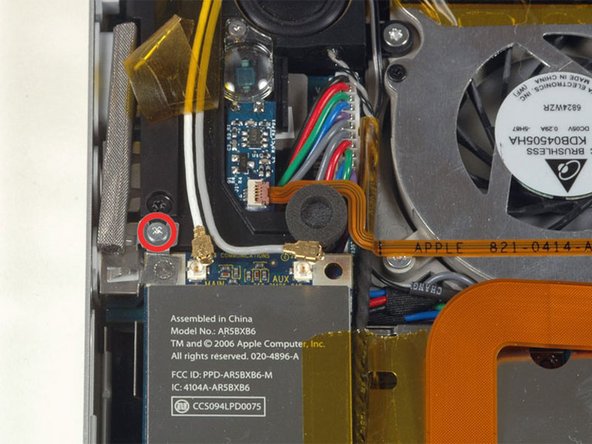

Image 1/1:
  • Remove the single silver Phillips screw located just above the Airport Extreme card.

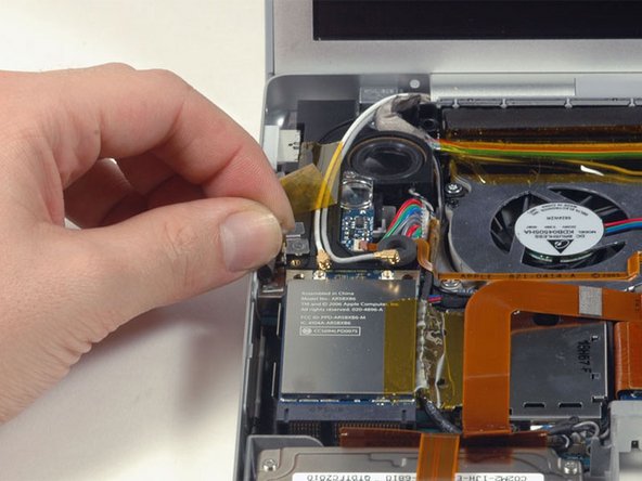

Image 1/1: Peel back the orange tape on the right side of the Airport Extreme card.
  • Lift the small silver metal retaining bracket up and out of the computer.
  • Peel back the orange tape on the right side of the Airport Extreme card.

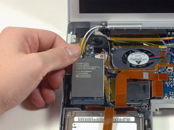

Image 1/1:
  • Lift the Airport Extreme card up and slide it out of its connector.
Did both an upgrade to an "n" airport and a new 500gig hard drive while watching the Phils whip the Yankees in Game 1. Happy to say everything is working after reassembly.
