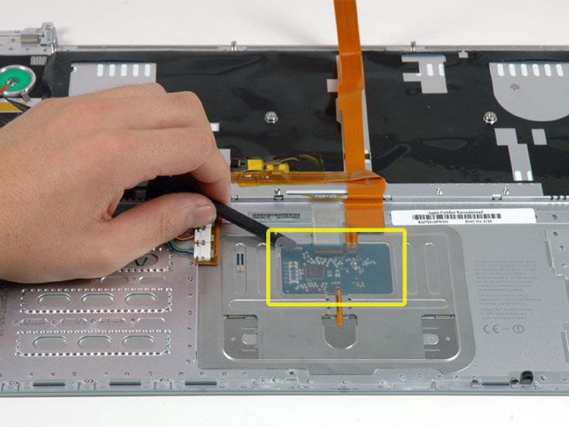

    • Disconnect the trackpad and keyboard ribbon cable from the logic board, removing tape as necessary.
    • Remove the upper case.
  11. MacBook Pro 15" Core 2 Duo Model A1211 Keyboard Replacement, Keyboard: step 11, image 1 of 1
    • Use a spudger to pry up the translucent plastic sheath covering the keyboard connector.
  12. MacBook Pro 15" Core 2 Duo Model A1211 Keyboard Replacement: step 12, image 1 of 1
    • Use the tip of a spudger to flip up the black plastic flaps locking down the keyboard and keyboard backlight ribbon cables.
