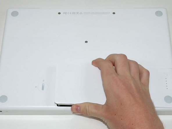

  • Use a coin to rotate the battery-locking screw 90 degrees clockwise.
I used this guide plus the Thermal Paste guide to resolve my MacBook RRS (Random Restart Syndrome) issue. My MacBook would randomly restart after the fan kicked into high speed. When I removed the heatsink I discovered an an irregular patch completely free of thermal compound of about 15-20% of the area on one of the processors. I removed and re-applied the thermal paste. I ran a memory test utility overnight that previously caused a restart after a couple of hours, and the probelm seems to be solved. TIme will tell.

My battery does not pop out when after step 1. Any idea why, and how do fix it?
Calvin - Reply
Quote from Calvin:
Will not drop out even if you turn it upside down?
skraggle - Reply

Somehow the plastic disc with the slot for a coin got dislodged from the case, and I can't seem to get it open now. Any tips/links on how to open this without the aid of the plastic disc?
Peter Wood - Reply
i broke my disc off as well. I used two toothpicks to rotate the thing. hi tech.

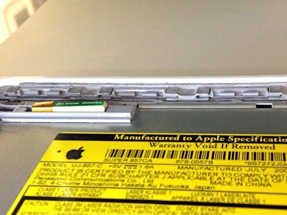

Image 1/1: Starting near the display and working around to the front of the computer, pry up on the upper case. A [product|IF145-000|plastic opening tool] or a medium hard guitar pick may help you to do this.
  • There's a trackpad and keyboard ribbon connecting the upper case to the logic board, so don't pull the upper case off entirely just yet.
  • Starting near the display and working around to the front of the computer, pry up on the upper case. A plastic opening tool or a medium hard guitar pick may help you to do this.

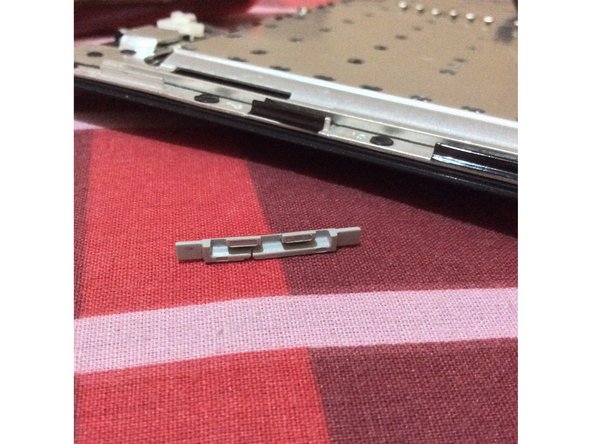

  • The upper case is likely to stick at the connection above the optical drive. If this is the case, first free all other sides, then proceed to pull upward on the upper case from either side of the optical drive opening.
  • If you stand the base on end to get a better look you may displace the total of 4 grey plastic clips that hold the keyboard in place. Don't panic. They slide into slots at the top right-most edge near the CD drive.
There will be 4 grey plastic clips just right of the DVD drive. Note their position as they will fall out in the next steps.
tim7866 - Reply
No such clips found on my early 2008 version.
Ernie K -

As is reported above, there a 4 friction tabs that connect to the keyboard. If they do not stay in place and stick to the keyboard, the keyboard will not go back on. Just remove them and put them in the clips, with the solid clip wall to the outside of the unit, and put the keyboard back on. Do this before reconnecting the keyboard.
David Higgins - Reply

When reassembling, take some care to align the tabs on the right hand side next to the optical drive. Rock and slide these tabs into position. Then work from right to left, as the rest of the case is quite easy to put back together.
Andrew Dent - Reply

On the right side above the optical drive there are little plastic braces that latch the upper case to the main body. This is the reason why the upper case might stick here. If the above step is not working, also try to gently push the upper case sideways away from the optical drive after freeing all other sides. When reassembling make sure the braces are in their slots of the main body and not attached to the upper case. If you cannot fit the upper case evenly over the optical drive, that's probably why. In this case carefully remove them and slide them back into their slots before lowering the upper case.
Hendryk1982 - Reply

  • Upon reassembly, there are 4 grey plastic clips on the optical drive side of the keyboard (refer to second picture). They must be installed in their slots for the keyboard to snap in properly.
  • To make the reassamble process easier, it's better to pull out the clips first by pulling it straight up gently. Be careful not to put too much strength because it will break.

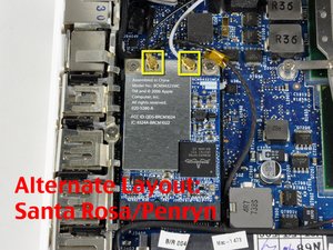

Image 1/2: Notice the order of the antenna cables from left to right is black, blue, and gray. Image 2/2: If you have a MacBook Core 2 Duo Santa Rosa/Penryn, there are only two antenna cables on the Airport card--black on the left, and gray on the right.
  • Disconnect the three antenna cables from the Airport card on the left side of the computer. Gently pull an antenna cable straight up to remove it.
  • Notice the order of the antenna cables from left to right is black, blue, and gray.
  • If you have a MacBook Core 2 Duo Santa Rosa/Penryn, there are only two antenna cables on the Airport card--black on the left, and gray on the right.
