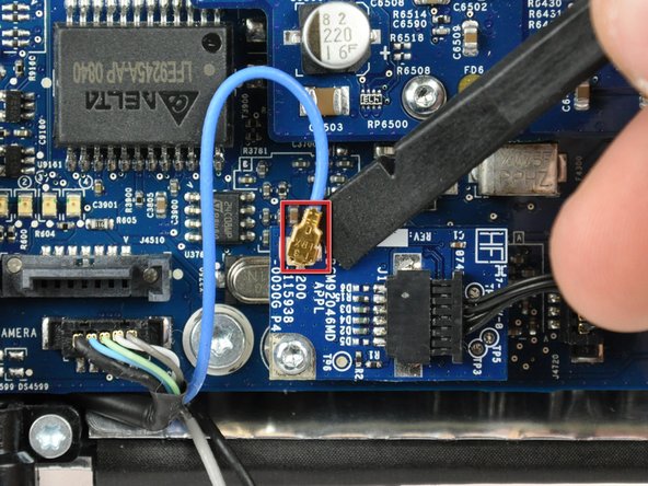

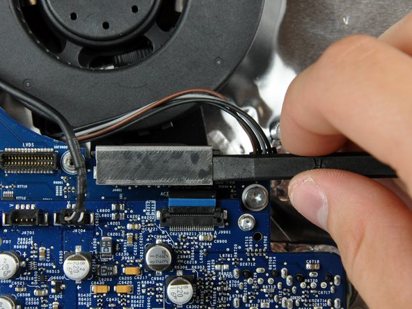

Image 1/2: If necessary, de-route the LCD temperature sensor cable from behind the logic board. Image 2/2: When you remove the LCD, check the routing of the LCD temperature display cable.  On reinstalling the display, be sure this cable does not block one of the bottom screws for the front bezel.
  • Pull the LCD temperature sensor connector straight up out of its socket on the logic board.
  • If necessary, de-route the LCD temperature sensor cable from behind the logic board.
  • When you remove the LCD, check the routing of the LCD temperature display cable. On reinstalling the display, be sure this cable does not block one of the bottom screws for the front bezel.
This was the most confusing step, because the video shows MJ just tilting the monitor open, and I had a ribbon cable hooked up to it. Finally figured out that the ribbon cable was connected to the LCD temp sensor cable, and it was neatly tucked under the adjacent fan. Had to pull it pretty hard to get it out from under the fan, and then could tilt the LCD. Instructions are not completely clear about this, only that you may have to reroute the cable around the motherboard.
d3nn151950 - Reply
I agree, there is no sign of how to remove the bezel (it took me several minutes to understand it was even the bezel that came off here) in these steps (in all the guides for this model, in fact). On step 4 says remove the LCD screws, and suddenly step 6 shows innards and fans etc - !! - What about showing the bezel being removed here - super confusing and not up to usual ifixit high standards.
hutchwilco - Reply

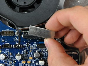

Image 1/1:
  • Use the attached black tab to pull the data display cable connector away from the logic board.

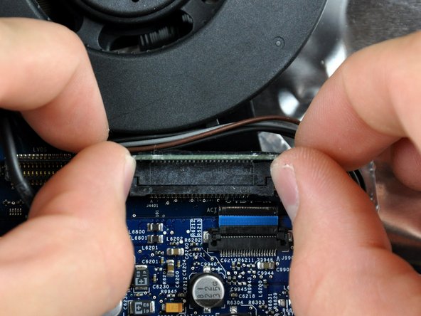

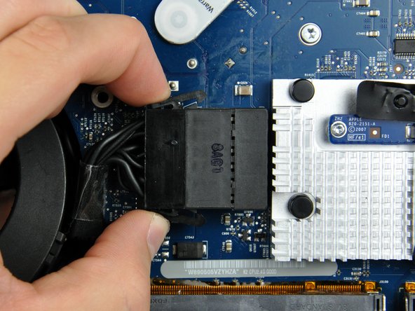

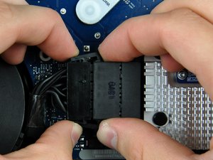

Image 1/2: During reinstallation, place the four inverter cable connectors in voids between components attached to the rear panel so the display panel will sit flush. Image 2/2: During reassembly, the order of the inverter cables is interchangeable within each socket.
  • With the display panel still lifted, disconnect the four inverter cables.
  • During reinstallation, place the four inverter cable connectors in voids between components attached to the rear panel so the display panel will sit flush.
  • During reassembly, the order of the inverter cables is interchangeable within each socket.
  • If you are replacing a hard drive and have an extra set of hands, it is possible to reach in and remove the drive without disconnecting anything but the LCD temp and display connector in the previous step with the LCD in its propped position.
Make sure to not squeeze the inverter-cables between the superdrive and the display when putting the display back on !
epzzky - Reply
This was the only step different for my 2134 - it is just one cable that connects to the monitor - disconnect the monitor end rather than the motherboard side.
Jim Laredo - Reply
There is no need to discnnect the inverter cables if display is positioned against a wall or something of the sort. Make sure it doesn't tumble over !!!
info5825 - Reply
For 24" iMacs, a single power cable is attached on the left side of the screen. To remove the cable, lift the screen from the right side and rotate it to the left. Remove the black plastic protector on the back of the screen and disconnect the cable.
Matt Stichnoth - Reply
Make sure you squeeze the two ends of the inverter cable together firmly - if not you will get yellow areas on your screen. One of my cables had not quite been clicked together, and I had to unscrew everything all over again.
Philip - Reply
So does it matter which ones are connected to which?
That is, at each end there are two connectors (one pink/black the other light blue/dark blue on the "male" side). The "female side appear identical. Does it matter if the pink/black "male" one is connected to the wrong "female" one?
Mark Gibson - Reply
Mark, did you ever get an answer about the connectors?
Mike -
Agreed this is an unspecified issue and i'm surprised it's not covered? Did everyone else just guess?
kainatticus -
Managed to avoid this step just lifting the lcd panel and holding it with my... head ;)
Antonio Bernardini - Reply
I'm trying to find some information on replacing the power supply temperature sensor cable. Mine broke during removal of a bad power supply.
Mike Overholt - Reply
found out that taking the 2 inverter cables (top right corner underneath LCD) and mixing them will not work. I got beeping sound. So...you really need to mark the 2 white sockets with P (pink) and B (for light blue-gray color). Then everything will come out smoothly. Again... inserting the 2 inverter cable sets into the right socket DOES MATTER.
Scorps - Reply

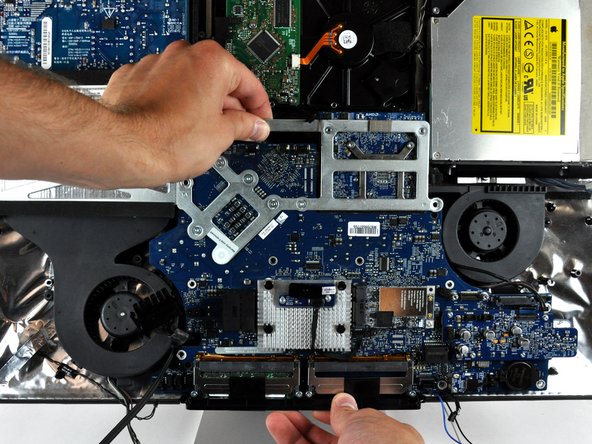

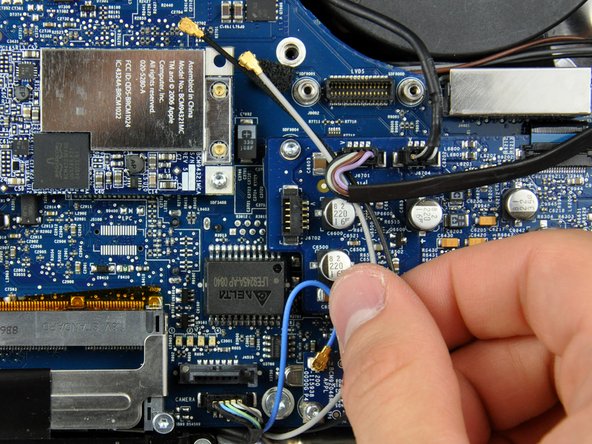

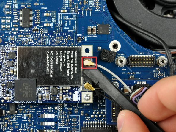

Image 1/1: Pull the connector parallel to the face of the logic board.
  • Disconnect the left speaker cable connector from the audio board by pulling it straight away from its socket.
  • Pull the connector parallel to the face of the logic board.

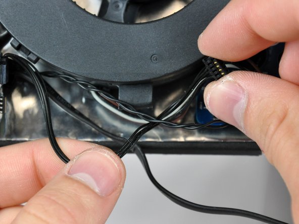

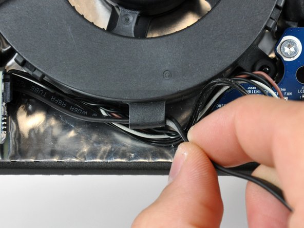

Image 1/1:
  • De-route the left speaker cable from the channel in the CPU fan. Continue completely de-routing the cable through the undersides of the IR board and heat sink.

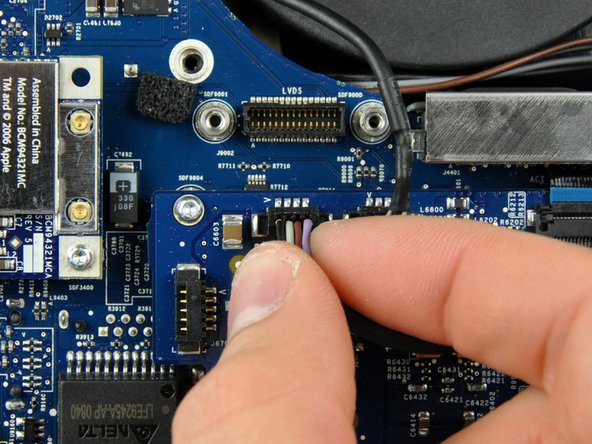

Image 1/1:

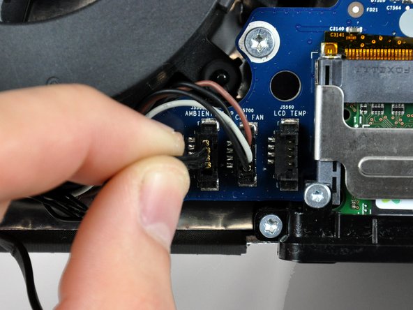

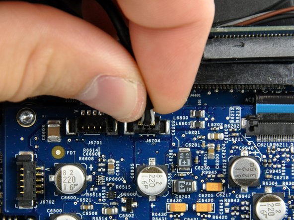

  • Disconnect the ambient temperature sensor cable by pulling its connector straight up off the logic board.

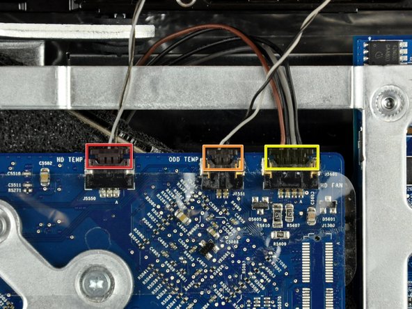

Image 1/1:
  • If necessary, de-route the ambient temperature sensor cable from under the power button cables.

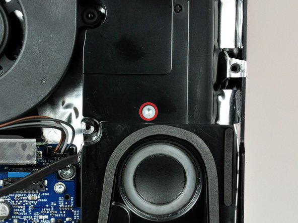

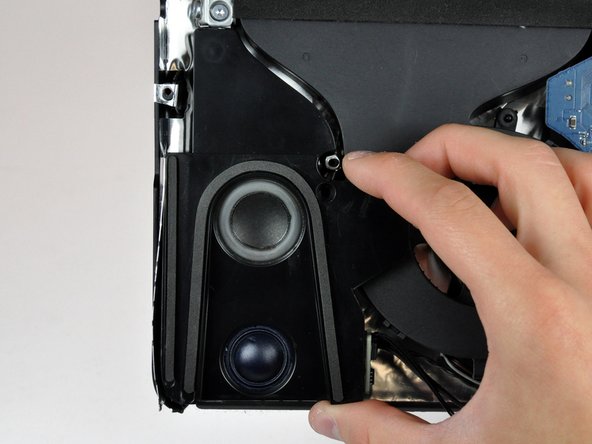

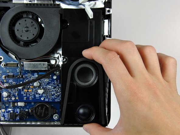

Image 1/2: Lift the left speaker up and out of the rear case. Don't try to slide the speaker out, since there is a plastic mounting pin under the top end of the speaker housing that holds it in place. Image 2/2: Lift the left speaker up and out of the rear case. Don't try to slide the speaker out, since there is a plastic mounting pin under the top end of the speaker housing that holds it in place.

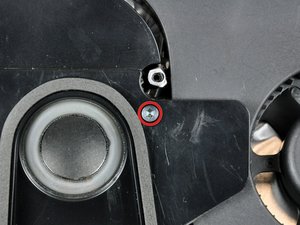

  • Remove the single 28 mm T10 Torx screw securing the left speaker to the rear case.
  • Lift the left speaker up and out of the rear case. Don't try to slide the speaker out, since there is a plastic mounting pin under the top end of the speaker housing that holds it in place.
I found it impossible to lift the speaker out without breaking the plastic mounting pin. All I can say is don't worry about it if it happens. When I put it back and tightened the screw, it seemed solidly in place.
mattgauntt - Reply

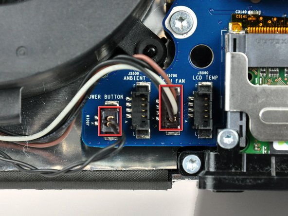

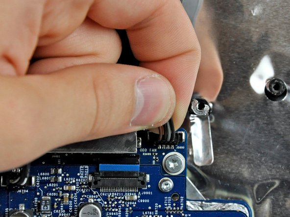

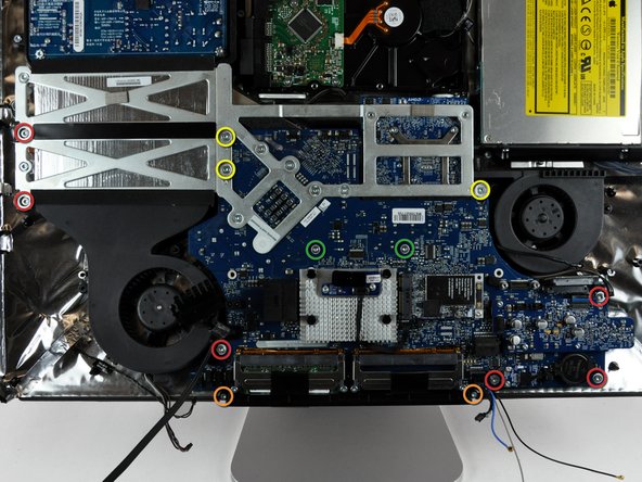

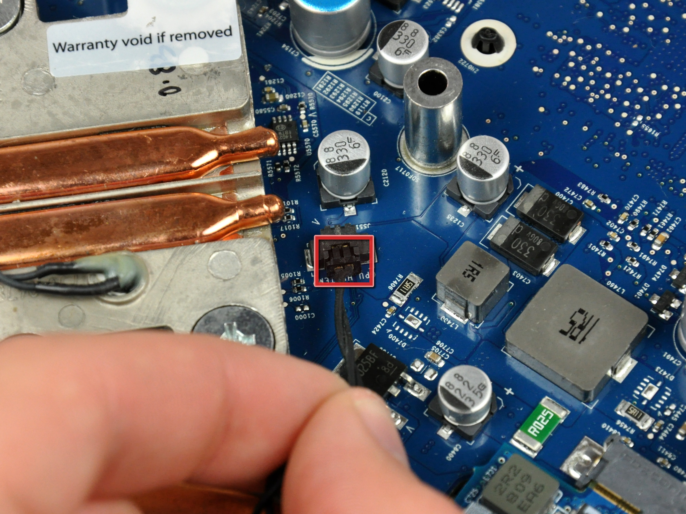

Image 1/1:
  • Disconnect the power button and CPU fan by lifting their connectors straight up off the logic board.

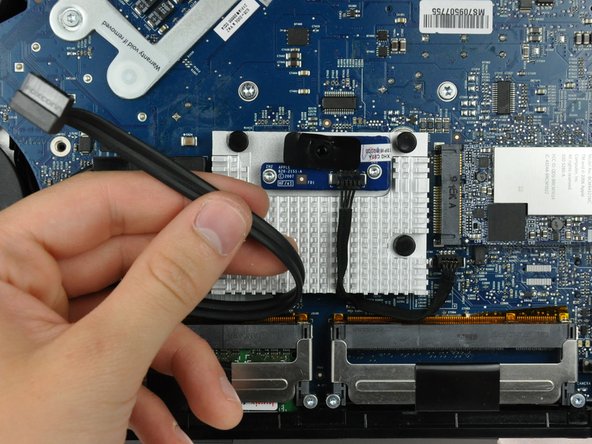

  • Disconnect the SATA data cable from the logic board by carefully pulling it straight away from its socket.
  • The SATA connector on most iMacs tends to stick in its socket on the logic board. If you are having trouble disconnecting the SATA cable, insert a metal spudger or any other thin tool into the gap between the SATA connector and its socket and twist the spudger's shaft to safely separate the two pieces.
Image 1/1:
  • Pull the SATA data cable out of its channel in the logic board and tuck it aside near the left edge of the rear case.

  • Disconnect the DC-in cable by simultaneously depressing both locking arms and pulling its connector away from the socket on the logic board.
  • After both locking arms pass their retaining tabs, it is helpful to push them toward the left edge of your iMac with one hand while pulling on the body of the connector with your other hand.

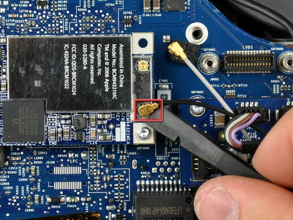

  • Use the flat end of a spudger to pry both AirPort antenna connectors up off the AirPort card.
Image 1/1:
  • Move both AirPort antennas toward the lower edge of your iMac, out of the way of the logic board.

  • Use the flat end of a spudger to pry the Bluetooth antenna connector up off the Bluetooth board.

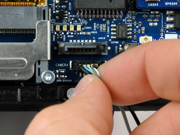

  • Pull the camera cable connector straight up out of its socket on the logic board.

  • Pull the right speaker cable connector straight up out of its socket on the audio board.
Image 1/2: Lift the right speaker up and out of the rear case, to clear the plastic mounting pins underneath it. Image 2/2: Lift the right speaker up and out of the rear case, to clear the plastic mounting pins underneath it.
  • Remove the single 12 mm T10 Torx screw securing the right speaker to the rear case.
  • Lift the right speaker up and out of the rear case, to clear the plastic mounting pins underneath it.

  • Lift the optical drive fan connector straight up out of its socket on the logic board.

Image 1/1:
  • Push the optical drive cable connector toward the top of your iMac to disconnect it from the logic board.
Image 1/1: During reinstallation, ensure that the mic cable runs between the ODD fan and the board support.  If the cable runs on the wrong side of the support,  the cable will be too short to plug in.
  • Lift the microphone cable connector straight up out of its socket on the audio board.
  • During reinstallation, ensure that the mic cable runs between the ODD fan and the board support. If the cable runs on the wrong side of the support, the cable will be too short to plug in.
TIP for re installation..I had the mic cable around the left side board support when I installed the board so it was too short and had to pull the board a out again! Make sure the mic cable runs between the ODD fan and the board support.
Richdave - Reply
Image 1/1:
  • If necessary, remove the piece of tape securing the thermal sensor and fan cables to the chassis.
Image 1/1: Hard drive thermal sensor.
  • Disconnect the following three cables from the logic board:
    • Hard drive thermal sensor.
    • Optical drive thermal sensor.
    • Hard drive fan.
  • When removing these connectors, it is helpful use your thumbnails to push the ears on either side of the connector toward the top of your iMac.
Image 1/1: Six 7.2 mm coarse-thread T10 Torx.
  • Remove the following 13 screws securing the logic board to the rear case:
    • Six 7.2 mm coarse-thread T10 Torx.
    • Two 6.8 mm T8 Torx. When reinstalling these two screws, don't overtighten them, as the plastic tabs they hold down are thin and brittle, and can crack.
    • Three 7 mm fine-thread T10 Torx.
    • Two 24 mm T10 Torx.
Image 1/1: If the front edge of the logic board, under the RAM sockets, won't pull up, it's sticking on the three plastic mounting pins in the rear housing under this edge.  Use a spudger under the front edge of the RAM sockets to gently push up on this edge until it clears these mounting pins.
  • Lift the logic board out of the rear case, minding any cables that may get caught.
  • If the front edge of the logic board, under the RAM sockets, won't pull up, it's sticking on the three plastic mounting pins in the rear housing under this edge. Use a spudger under the front edge of the RAM sockets to gently push up on this edge until it clears these mounting pins.
  • Disconnect the video card thermal sensor by pulling its connector away from the socket on the logic board.

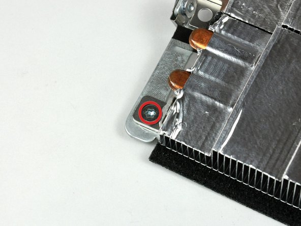

  • Remove the 4.3 mm T8 Torx screw securing the video card heat sink to the framework attached to the logic board.

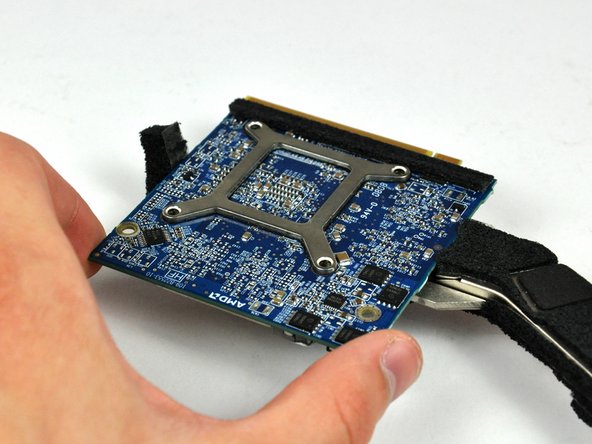

Image 1/2: It may be helpful to hold the socket from the other side of the video card with a Phillips screwdriver if the screws will not come out. Image 2/2: It may be helpful to hold the socket from the other side of the video card with a Phillips screwdriver if the screws will not come out.

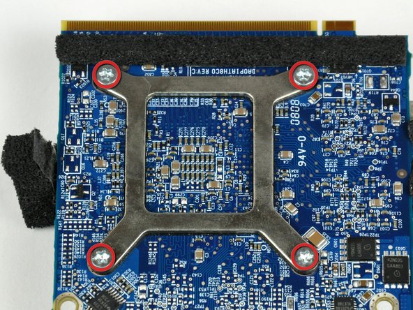

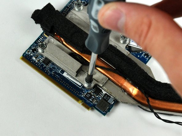

  • Remove the four 7.5 mm T10 Torx screws securing the heat sink to the video card.
  • It may be helpful to hold the socket from the other side of the video card with a Phillips screwdriver if the screws will not come out.

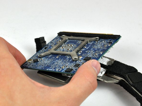

Image 1/2: Image 2/2:
  • Gently lift the video card off the video card heat sink.

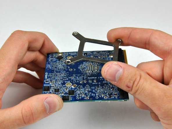

  • Lift the metal heat sink bracket off the video card.
