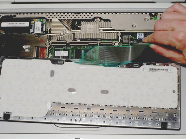

Image 1/1: Disconnect the keyboard connector from the logic board.
  • Rest the keyboard face down on the trackpad area.
  • Disconnect the keyboard connector from the logic board.
Image 1/1:
  • Your laptop should look approximately like this.

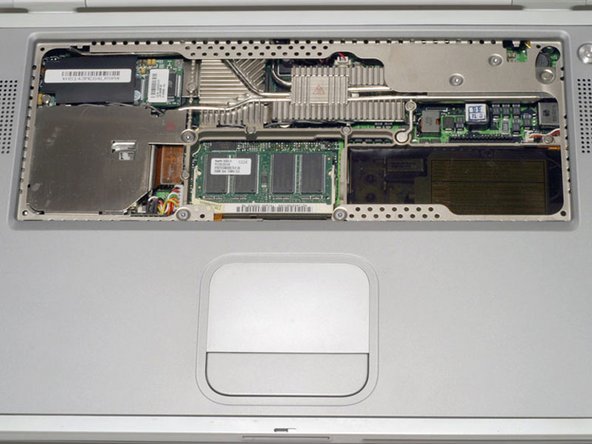

Image 1/1: Pull the RAM chip out.
  • Release the tabs on each side of the RAM chip at the same time. These tabs lock the chip in place and releasing them will cause the chip to ÒpopÓ up.
  • Pull the RAM chip out.
  • Repeat this process if a second RAM chip is installed.
Don't forget to spread the brackets on the sides apart to release the chips.

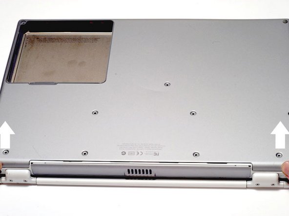

  • Turn the G4 over.
  • Remove the eight T8 Torx screws from the lower case.
Image 1/1: The lower case may stick in the front on a tab just above the center of the DVD drive. Be careful as you work the case off, or you may break the thin strip of plastic just above the drive.
  • Using your thumbs, slide the lower case away from you.
  • The lower case may stick in the front on a tab just above the center of the DVD drive. Be careful as you work the case off, or you may break the thin strip of plastic just above the drive.
  • Lift the lower case off.

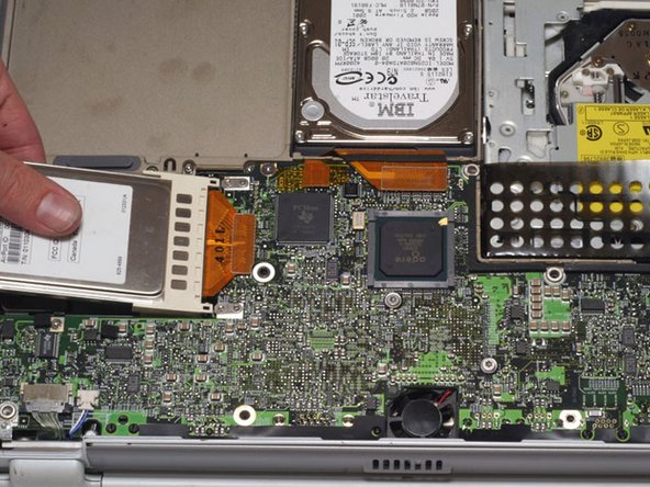

Image 1/1: Firmly grasp the plastic tab attached to the Airport card and pull up and to the left.
  • Skip this step if your computer does not have an Airport card.
  • Firmly grasp the plastic tab attached to the Airport card and pull up and to the left.
  • Disconnect the antenna cable from the left side of the Airport card.
I'm not sure what the point is for this step. This helped not at all in getting the drive out. Also, the cable is taped down, and must be untaped before the card will come out.

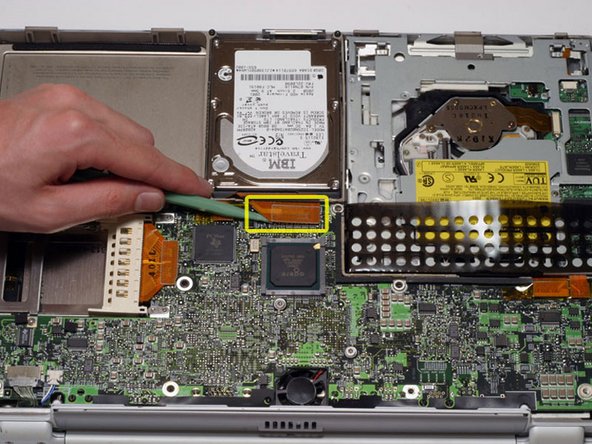

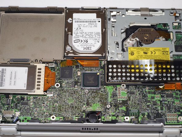

  • Disconnect the hard drive ribbon from the logic board using a spudger or the tip of your finger, removing tape as necessary.
Image 1/1:
  • To free the hard drive, remove the two T8 Torx screws from the right wall of the battery housing.
Image 1/1: There are four rubber bumpers that fit over the hard drive screws. Ensure that these bumpers come out when you remove the hard drive.
  • Remove the hard drive by gently grasping the orange ribbon cable and lifting the left edge up and out of the computer.
  • There are four rubber bumpers that fit over the hard drive screws. Ensure that these bumpers come out when you remove the hard drive.
Image 1/1:

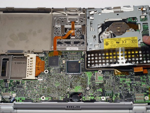

Image 1/1: The EMI clip is not essential for reassembling the computer. If the clip falls out, don't worry about putting it back in.
  • Bend the silver metal EMI clip so that it is vertical. This part may fall out after removing the DVD drive.
  • The EMI clip is not essential for reassembling the computer. If the clip falls out, don't worry about putting it back in.
You don't actually have to bend the EMI clip. You can use a 2mm or smaller slotted screwdriver to pry the clip up and out.
Sugar Fish - Reply

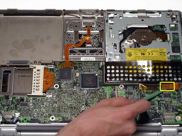

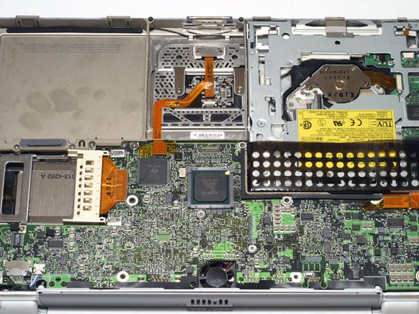

Image 1/1: Disconnect the orange DVD ribbon cable from the logic board using a spudger or the tip of your finger
  • Turn the G4 over.
  • Disconnect the orange DVD ribbon cable from the logic board using a spudger or the tip of your finger
Image 1/1: If you have a CD or any other object jammed in your optical drive, we have an [guide|772|optical drive repair guide].
  • Remove the DVD drive by lifting the right edge up and out of the computer.
  • If you have a CD or any other object jammed in your optical drive, we have an optical drive repair guide.
