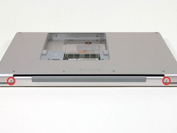

  • Rotate the computer 90 degrees and remove the two Phillips screws from the rear of the computer.

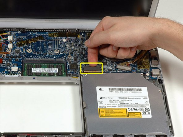

  • Disconnect the orange SuperDrive ribbon cable from the logic board, removing tape as necessary.

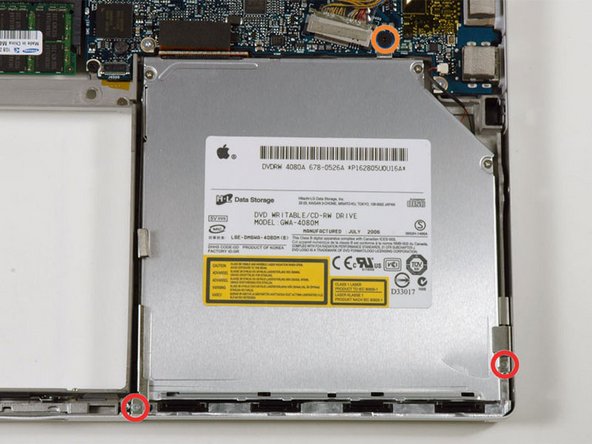

Image 1/1: Two 3.3 mm silver Phillips screws on either side of the SuperDrive.
  • Remove the following 3 screws:
    • Two 3.3 mm silver Phillips screws on either side of the SuperDrive.
    • One 4.8 mm black Phillips screw at the top right corner of the drive.
    • The 4.8mm screw may be a T6 Torx
On my model (core duo 1.8 ghz Macbook Pro) that "One 4.8mm black Phillips screw at the top right corner of the drive" is a silver Torx T6 screw.
holmesworcester - Reply
Mine was a silver T6 Torx also.
Melissa Godsey -
My machine had a grey Torx here.
dave -
There was one extra silver Torx T6 screw, at the top left of the drive, immediately left of the ribbon cable connection, that I had to remove in order to extract the Optical drive. It is visible in the picture for Step 12.
pensivemonk - Reply
On my MBP 15.4" santa rosa (July 2007), the bottom left 3.3mm screw is smaller than this and doesn't fit a PH000 screw driver.
Greg K - Reply
On my A1150, the black screw wasn't- it is a silver Torx 6
stevesontheroad - Reply

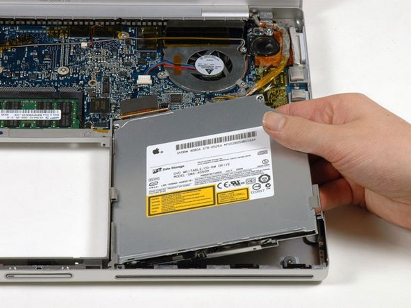

  • Lift the optical drive up and out of the computer.

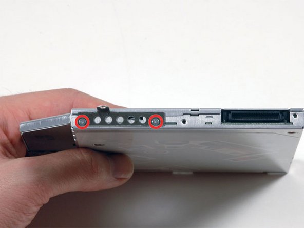

Image 1/1: Remove the two silver Phillips screws securing the mounting bracket to the left side of the optical drive.
  • If your new optical drive already has brackets on it, you'll only need to transfer the data cable to your new drive.
  • Remove the two silver Phillips screws securing the mounting bracket to the left side of the optical drive.
