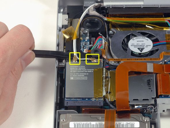

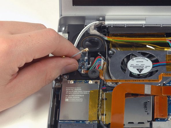

Image 1/1: The white antenna cable connects to the left side of the Airport Extreme card.
  • Disconnect the two antenna cables attached to the Airport Extreme card.
  • The white antenna cable connects to the left side of the Airport Extreme card.
Image 1/1:
  • Deroute the Airport antenna cables from their channel in the left speaker.
These were hard for me to get back on.

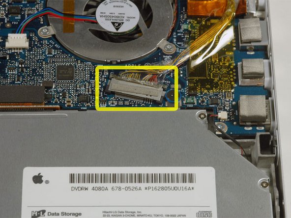

  • Disconnect the display data cable from the logic board.

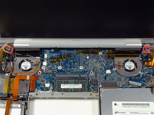

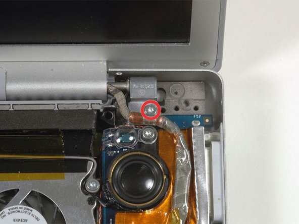

  • Remove the silver T6 Torx screw securing the ground loop on the display data cable to the casing.

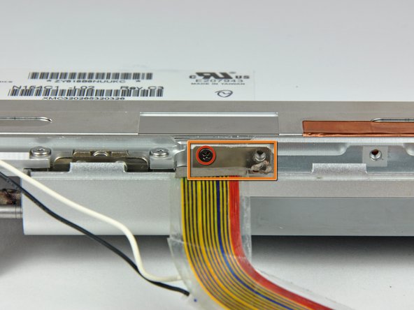

Image 1/1: Two 9.5 mm silver T6 Torx screws with threads on only part of the shaft on the inside of the display hinges.
  • Support the display with one hand while removing the following 3 screws:
    • Two 9.5 mm silver T6 Torx screws with threads on only part of the shaft on the inside of the display hinges.
    • One 9.5 mm silver T6 Torx screw with threads on the entire shaft on the outside of the left hinge.

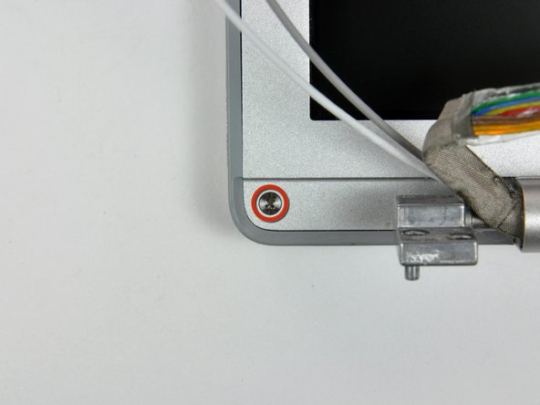

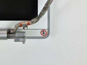

  • Remove the two 5 mm Phillips screws from the lower left and right corners of the display (two screws total).
The screw fixing points on my MBP came away from the back case. They are spot welded to the back case and in the Photo's I have you can see the point's each. You may think that if this happens you lose the ability to use the screws to secure the enclosure but you still can use the screws if you position the fixing points before clipping the front panel in place. Have a needle of small nail to align though the holes before replacing the screws. This is not easy and you need to be practices at this sort of repair.
They sit under the plastic surround and do! add the the string of the completed enclosure.
substevew - Reply

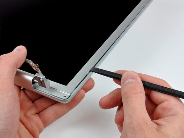

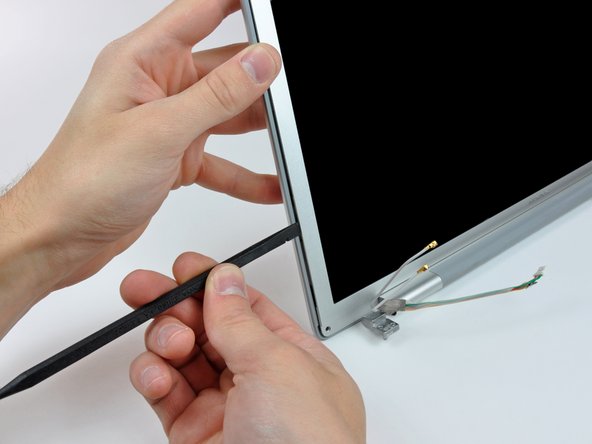

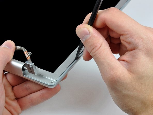

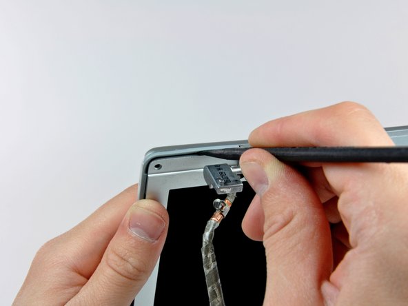

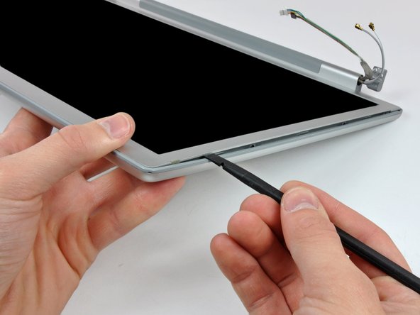

Image 1/3: Do not insert your spudger between the plastic strip and the rear bezel. Image 2/3: With the spudger still inserted, rotate it away from the display to separate the front and rear bezels. Image 3/3: Work along the left edge of the display until the rear bezel is evenly separated from the front bezel.
  • Insert the flat end of a spudger perpendicular to the face of the display between the plastic strip attached to the rear bezel and the front bezel.
  • Do not insert your spudger between the plastic strip and the rear bezel.
  • With the spudger still inserted, rotate it away from the display to separate the front and rear bezels.
  • Work along the left edge of the display until the rear bezel is evenly separated from the front bezel.

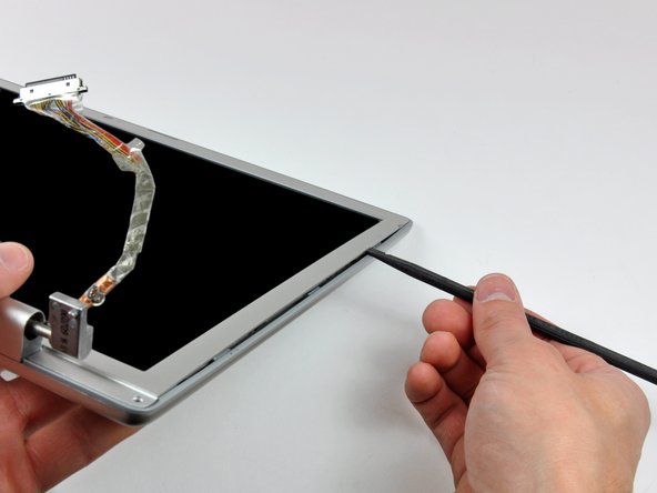

Image 1/3: With the spudger still inserted, rotate it away from the display to separate the front and rear bezels. Image 2/3: Work along the right edge of the display until the rear bezel is evenly separated from the front bezel. Image 3/3: Work along the right edge of the display until the rear bezel is evenly separated from the front bezel.
  • Work along the right edge of the display until the rear bezel is evenly separated from the front bezel.

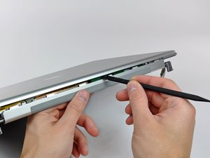

Image 1/3: Rotate your spudger toward the rear bezel to separate it from the front bezel. Image 2/3: If necessary, enlarge the gap between the lower edge of the rear bezel and the clutch cover until the two components are completely separated. Image 3/3: If necessary, enlarge the gap between the lower edge of the rear bezel and the clutch cover until the two components are completely separated.
  • Insert the flat end of a spudger between the front bezel and the plastic strip attached to the rear bezel near the screw holes at the bottom corners of the display.
  • Rotate your spudger toward the rear bezel to separate it from the front bezel.
  • If necessary, enlarge the gap between the lower edge of the rear bezel and the clutch cover until the two components are completely separated.

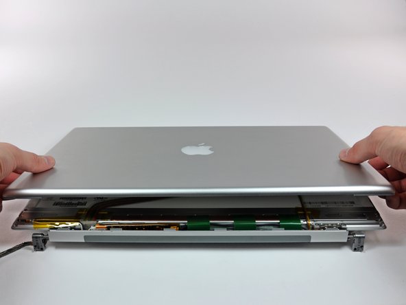

Image 1/1: Remove the rear display bezel from the display assembly.
  • Lift the rear bezel by its bottom edge and rotate it away from the display assembly to separate the top edge.
  • Remove the rear display bezel from the display assembly.

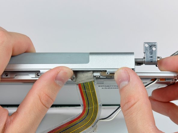

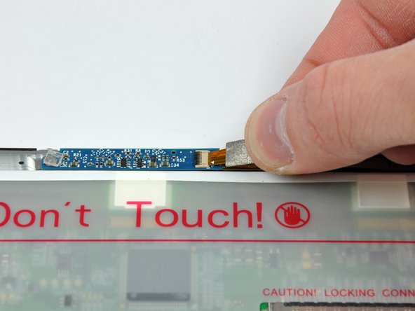

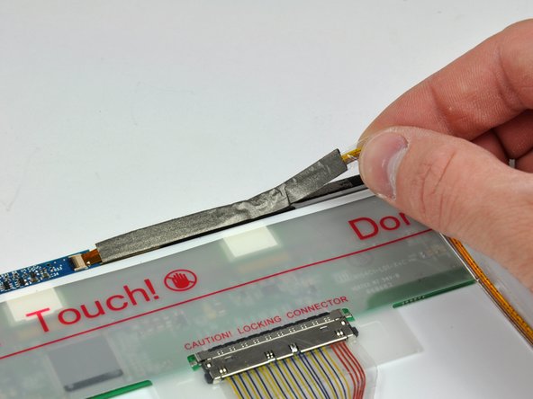

Image 1/1: Carefully lift the inverter board out of the clutch cover.
  • The display inverter is a very thin and delicate circuit board that is easily broken. Use caution when handling.
  • Carefully lift the inverter board out of the clutch cover.

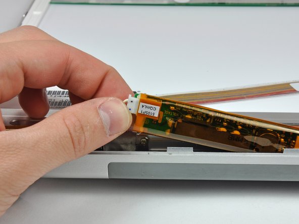

Image 1/1:
  • Disconnect the LCD backlight from the inverter by pulling its connector away from the inverter board.
Image 1/1: Disconnect the inverter cable by pulling its connector away from the socket on the inverter.
  • Be cautious to not put any strain on the inverter cable ground loop, as it is a very thin and delicate wire.
  • Disconnect the inverter cable by pulling its connector away from the socket on the inverter.

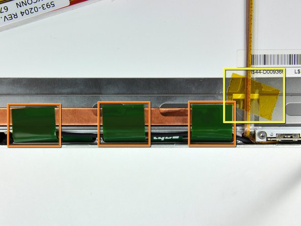

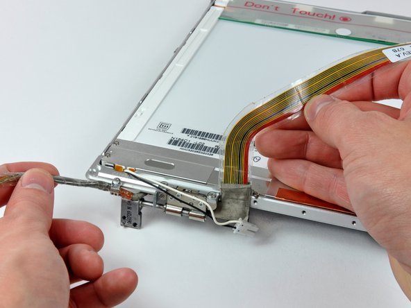

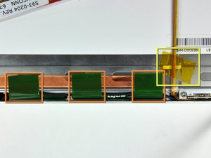

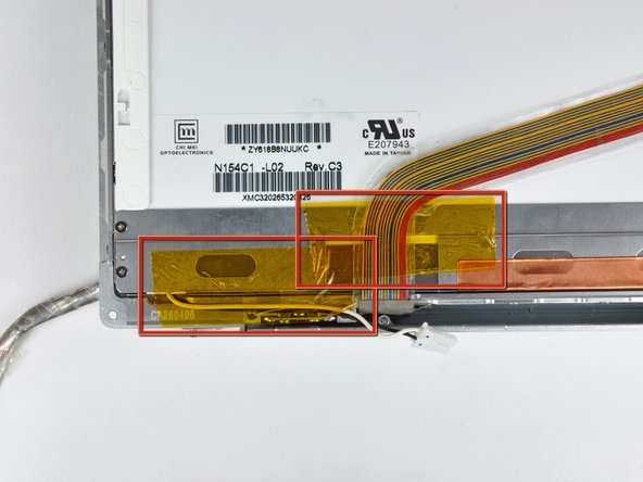

Image 1/2: Peel the three green antenna ground straps off the copper tape along the bottom edge of the LCD. Image 2/2: The adhesive connecting these straps to the display is very strong. An edged tool is helpful to separate the adhesive while you peel the straps off.
  • Remove the pieces of yellow kapton tape from the bottom left corner of the display.
  • Peel the three green antenna ground straps off the copper tape along the bottom edge of the LCD.
    • The adhesive connecting these straps to the display is very strong. An edged tool is helpful to separate the adhesive while you peel the straps off.
  • Remove the piece of tape securing the camera cable to the LCD.
The replacement antenna I just bought has all the adhesive cleaned off of the green ground straps. What do I use to glue them back on?
Aaron - Reply
That's a great question Aaron, I am also curious if you can just use contact adhesive, although mine has a copper strip adhered to the back of the LCD, which I am sure is used to increase the gain of the antenna, if so regular contact adhesive may act as a insulator and not be the best solution.
Jose Francisco Medeiros - Reply

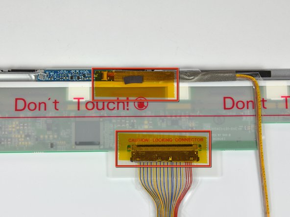

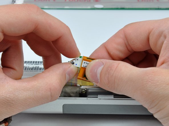

Image 1/2: Carefully peel the camera cable off the foam tape along the top edge of the LCD. Image 2/2: Carefully peel the camera cable off the foam tape along the top edge of the LCD.
  • Remove the pieces of tape covering the display data cable and camera cable connectors.
  • Carefully peel the camera cable off the foam tape along the top edge of the LCD.

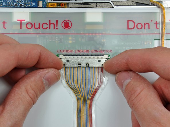

Image 1/2: Pull the display data cable connector away from its socket on the LCD. Image 2/2: Pull both cables parallel to the face of the logic board.
  • Gently pull the camera cable away from its socket on the camera board.
  • Pull the display data cable connector away from its socket on the LCD.
  • Pull both cables parallel to the face of the logic board.

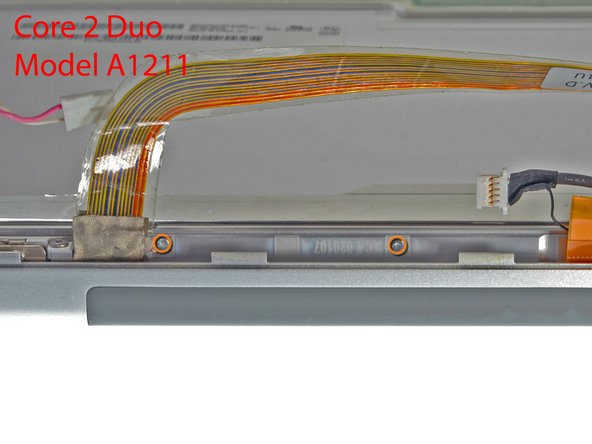

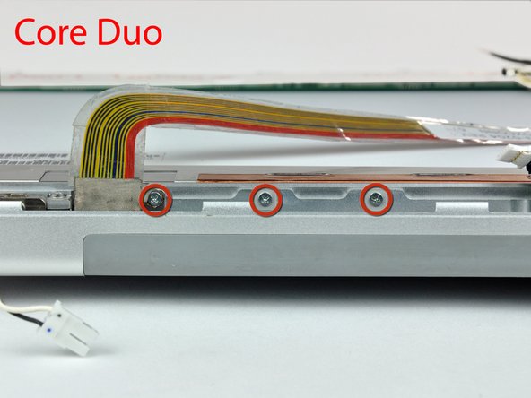

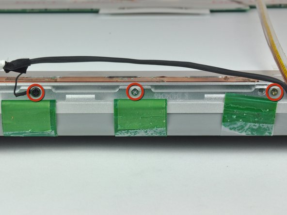

Image 1/2: If you have a Core 2 Duo Model A1211 machine, refer to picture 2 and remove two Phillips screws connecting the clutch assembly to the lower edge of the front display bezel near the display data cable. Image 2/2: If you have a Core 2 Duo Model A1211 machine, refer to picture 2 and remove two Phillips screws connecting the clutch assembly to the lower edge of the front display bezel near the display data cable.
  • If you have a Core Duo machine, refer to picture 1 and remove three Phillips screws connecting the clutch assembly to the lower edge of the front display bezel near the display data cable.
  • If you have a Core 2 Duo Model A1211 machine, refer to picture 2 and remove two Phillips screws connecting the clutch assembly to the lower edge of the front display bezel near the display data cable.
Image 1/1: Remove the small rectangular steel bracket by sliding it away from the right clutch hinge.
  • Remove the small Phillips screw from behind the display data cable.
  • Remove the small rectangular steel bracket by sliding it away from the right clutch hinge.
    • If you have a Core 2 Duo Model A1211, there is no steel bracket. Simply remove the screw and continue to the next step.
Image 1/1: The inverter cable ground loop is a very thin and delicate wire. Work gently.
  • Remove three Phillips screws attaching the clutch assembly to the lower edge of the front display bezel.
  • The inverter cable ground loop is a very thin and delicate wire. Work gently.
Image 1/2: If necessary, repeat this process for the right side of the clutch assembly. Image 2/2: Remove the clutch assembly from the front display bezel.
  • Push the open edge of the clutch cover away from the left clutch hinge to pop it off the clips attaching the two parts.
  • If necessary, repeat this process for the right side of the clutch assembly.
  • Remove the clutch assembly from the front display bezel.
Image 1/1:
  • De-route the display data cable from around the right clutch hinge and remove it from the front bezel.
