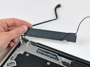

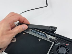

Image 1/2: Lift the subwoofer off the optical drive, and set it above the computer. Image 2/2: Lift the subwoofer off the optical drive, and set it above the computer.
  • The subwoofer is still connected to the right speaker, so don't completely remove it just yet.
  • Lift the subwoofer off the optical drive, and set it above the computer.

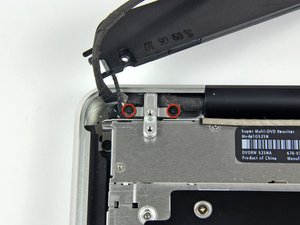

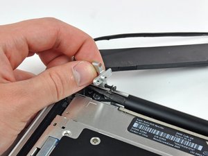

Image 1/2: The right screw may remain captive in the camera cable. Image 2/2: Lift the camera cable bracket out of the upper case.
  • Remove the two 8.4 mm Phillips screws securing the camera cable bracket to the upper case.
  • The right screw may remain captive in the camera cable.
  • Lift the camera cable bracket out of the upper case.
There's another type of bridge, black, with an extra piece of metal to hold the cable. You don't have to remove this bridge to unmount the optical drive.
Martin - Reply

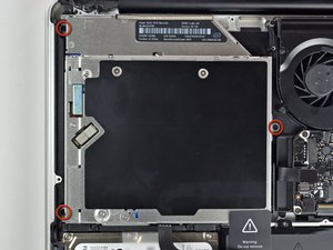

Image 1/2: Lift the optical drive from its right edge and pull it out of the computer. Image 2/2: Lift the optical drive from its right edge and pull it out of the computer.
  • Remove the three 2.5 mm Phillips screws securing the optical drive to the upper case.
  • Lift the optical drive from its right edge and pull it out of the computer.
