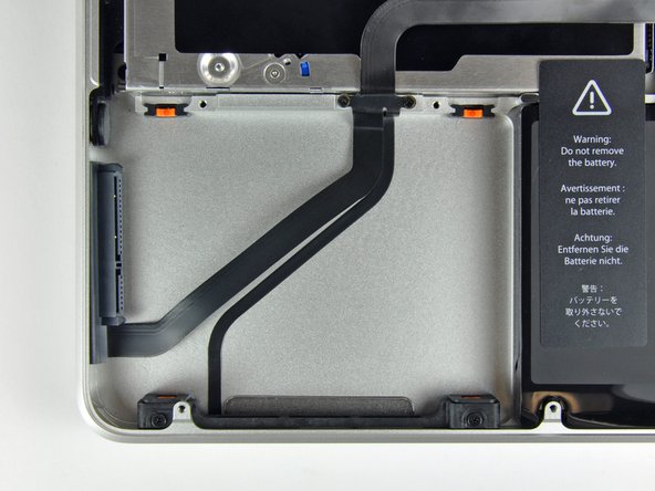

Image 1/1: Two 1.5 mm Phillips screws.
  • Remove the following four screws securing the hard drive and IR sensor cable to the upper case:
    • Two 1.5 mm Phillips screws.
    • Two 9.5 mm Phillips screws.

Image 1/2: Carefully peel the hard drive and IR sensor cable from the upper case. Image 2/2: Carefully peel the hard drive and IR sensor cable from the upper case.
  • Slide the hard drive and IR sensor bracket away from the edge of the upper case.
  • Carefully peel the hard drive and IR sensor cable from the upper case.
Image 1/1:
  • Use the flat end of a spudger to pry the hard drive cable connector up off the logic board.
Image 1/1: If your replacement part does not come with the hard drive bracket and indicator light, you will need to pull those off of the part you are removing and install them on the new part.
  • Lift the hard drive/IR sensor cable assembly out of the upper case.
  • If your replacement part does not come with the hard drive bracket and indicator light, you will need to pull those off of the part you are removing and install them on the new part.
  • Your replacement part may come with several adhesive foam bumpers. These are to ensure a snug fit of both bracket and hard drive. Apply only as needed.
I bought the cable from ifixit and did have to peel off the IR receiver, which was surprisingly challenging. I'd never come across the ribbon cable clamp connection before and so didn't know how to open it, or how much of the new cable needed to go in. I'd also suggest marking the location of the cable that attaches to case bottom, before you pull it off. A few pencil marks would work. (That's probably a step 8 add)
gregsrow - Reply
I had the same challenge with the ribbon cable clamp. There is a tiny orange ribbon, visible in the lower left corner of the photo for step 10, above, that needs to be connected to the new part using a tiny clamp, also visible right there in step 10. To open it, you flip up part of the clamp that is opposite the ribbon. That will release the ribbon, and enable you to slide the ribbon into the new clamp, which then you can adhere to the bracket. Hope that's helpful for future fixers.
Bryony - Reply
Thank you, Bryony! Very helpful clarification on how to open the clamp. All set now.
Lucas -
Thanks. You comment should be added to the guide along with a close up photo.
larsvange -
Thanks to Bryony I easily fastened the small orange connector. For future fixers: I photographed the little clamp while opened: http://imgur.com/a/1cYyx. Use the edge of a credit card or a plectrum to open it.
Pete -
It would REALLY be helpful if there were some instructions with close-up photos to guide you through the process of removing AND re-attaching the IR sensor component to a new drive cable. This is not intuitive and the part is very small and fragile. Forcing things the wrong way will quickly result in breaking parts. Bryony's comments were very helpful (Thank YOU!). Any way to get these steps added to the guide?
tpoyner - Reply
Just want to endorse tpoyner's request to add guidance on how to attach the tiny, tiny orange ribbon cable to the clamp. I managed to do it without lifting the clamp but was terrified of damaging the delicate cable. Wish I'd ready Bryony's comment first.
David - Reply
Does anyone have pictures of how to reinsert the IR orange cable? Or a link to a site that does..stuck at that part
knickerbockers16 - Reply
Success. I agree that this is the trickiest part of the job, and is the least documented.
Getting orange ribbon cable off is relatively easy, but reseating it onto the new cable was an <OMG, I am going to break this> moment.
My approach was to slide the side of a credit card underneath and use that as an in situ support. I was then able to exert some lateral force to reseat the orange cable connector into the connector on the black plastic terminal piece of the new cable.
NB: I did unpeel the sticky back of the black piece before reconnecting cables.
Advice: at the end, stick the length of the cable to the case following the original path; make sure it is flush with the other side of the case on the short vertical drop. Any slack in the cable length will foul the replacement of the back IR sensor assembly.
Good Luck!
(PS: got my cable cheaply from eBay, but I note that the date stamped on the cable is 2009, so if it was a faulty batch from that period, maybe I have a problem in store for the future...?)
Leo - Reply

Pic 7 : the clamp opened with orange ribbon still in.
Pic 8, 9 : orange ribbon out.
I could open the clamp with nail.
I could unscrew with PH00.
Some crews hard as mentioned.
Sorry for the bad pictures, I did not set my camera at max resolution.

Used a Phillips #00 and a creditcard. It's an easy job, takes about 10 minutes. :)
sjoerdstra - Reply
In step #8 the two small screws were very tight in my computer. The Phillips #00 was too large and damaging the screws. I changed to a Phillips #000 applied substantial pressure and voila, the screws came off.
Reassembly: placing the IR sensor cable (the one you"peeled off" in step #9) is a bit tricky. Start from the side opposite the IR sensor (the side with the two small screws of step 8) and press first along the short vertical side and then across towards the IR section. There should be a little left for a vertical section at the IR sensor end.
