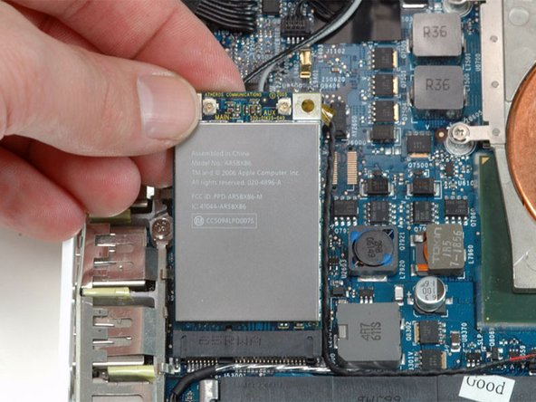

Wi-Fi connectivity not what it used to be? A new AirPort Extreme 802.11g card might alleviate your woes.

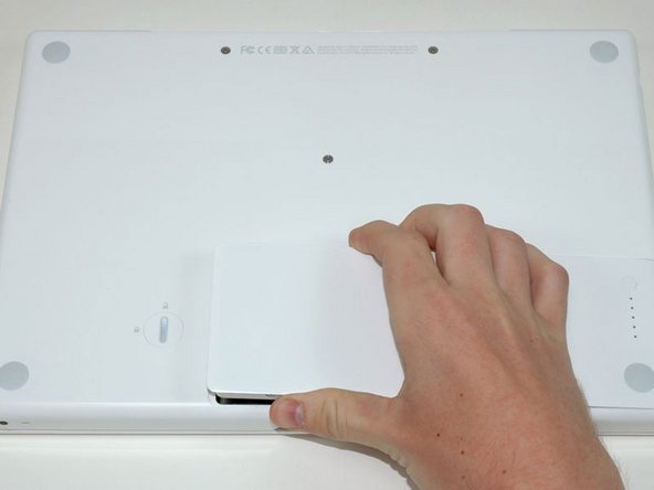

  • Use a coin to rotate the battery-locking screw 90 degrees clockwise.

The guide is fantastic and the Airport Extreme Card upgrade took me less than an hour to complete. It wasn't very difficult. Some pointers: read the entire guide before undertaking the project; keep the screws from each step separated in labeled containers; buy a spludger if you don't already have one; keep a tweezer handy for the tiny screws; and take your time separating the keyboard from the computer so as to not crack/break the plastic bezel.

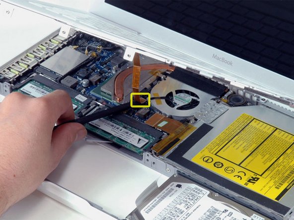

One note on the fan replacement, or really any MacBook repairs. If you fire your MacBook up and nothing happens but the sleep light is blinking then make sure your memory is seated correctly. I freaked out after installing my new fan but it turns out that all I needed to do was reseat the memory.

Reference: "prising off the plastic bezel around the display, removing the three screws from the hinge cover, then prising off the hinge cover to expose the inverter. That is all that is needed."
Unfortunately putting it back an shred the cables to the airport card..

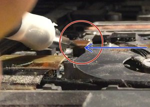

Image 1/2: Take care to pry between the black socket and the white connector. You might have to pry on both sides for it to release properly. Image 2/2: Do not pry from the bottom or the top, but from the sides.
  • While holding up the upper case (from the bottom or the top), use a spudger to pry up the orange trackpad and keyboard cable from its connector.
  • Take care to pry between the black socket and the white connector. You might have to pry on both sides for it to release properly.
  • Do not pry from the bottom or the top, but from the sides.
  • If you happen to break your upper case cable when removing the upper case, we stock the cable individually and we have a guide that makes replacing it easy.
It lifts straight up.
Cameron Moll - Reply
Quote from cameronmoll:
I'd suggest being careful and perhaps having help with step 12, as I have broken the connector piece at the end of the cable by pulling too hard/fast and having the connector stuck in the board and the ribbon dangling without purpose.
Does anybody know of a good way to repair such a ribbon, or am I stuck buying new upper case units?
o2bnited - Reply
An extra picture or warning should be added about this... The same as you, I broke the connector. I didn't even use any force, but the pins got off the cable and now I'm forced into buying a new one. Trying to buy one from ebay as we speak. It might have been due to metal fatigue after 7 years, but it got broken none the less.
schederpetel -
The computer serial number and network IDs are on the underside of the top case (visible in the battery compartment.) In order to prevent misidentification in the future (for instance, while on the phone with Apple tech support), I print the info from the old top case on a sticker and affix it over the label on the new top case.
colleenthompson - Reply
A lot of top case replacements are due to the front edge being broken by the bumpers on the lid of the MacBook. I stick a couple of felt dots on either side of these bumpers to absorb some of the shock when the lid is slapped shut, to prevent damage to the new top case.
I think that one extra picture should be added here. That is to say, the purpose of using the spudger (which I do suggest you should buy so that you don't risk ruining the orange cable), is to unplug a little connection. Basically your are "popping" it open. Had I known this it would have made th4e process feel a little less risky. In any case the mission was successful... Job completed in 45 minutes and my computer has wireless internet once again!!
juztino - Reply
Be really careful. The cable comes up really easily.
Nick Cox - Reply
Do NOT use a spudge!!! Just pull in the tab. Spudge Ruins the cable!
Oliver - Reply
The image is misleading. Don't pry it up from the front, but from the sides. Personally I used a small flathead screwdriver, but sadly - only after ripping apart the soldering on the wire/plug.
Also, be careful to lift the white plastic plug, not the circuitboard/wire attached to it
Magnus Bae - Reply
Image 1/1:
  • Disconnect the two antenna cables from the Airport card on the left side of the computer.
Image 1/1: One 3 mm Phillips from the left side.
  • Remove the following 2 screws from the Airport card:
    • One 3 mm Phillips from the left side.
    • One 8 mm Phillips from the right side.
Image 1/1:
  • Grasp the Airport card at its top and slide it toward the screen and out of the computer.
Yeah all done, and computer is wireless once again!!
