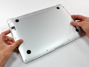

  1. MacBook Air Models A1237 and A1304 Audio Cable Replacement, Lower Case: step 1, image 1 of 1
    • Unplug your MacBook Air and power it off before you proceed.
    • Remove ten Phillips screws securing the lower case to the MacBook Air:
    • Six 2.8 mm screws
    • Two 3.8 mm screws
    • Two 5.4 mm screws
  2. MacBook Air Models A1237 and A1304 Audio Cable Replacement: step 2, image 1 of 2 MacBook Air Models A1237 and A1304 Audio Cable Replacement: step 2, image 2 of 2
    • Slightly lift the lower case near the vents and push it toward the rear of the computer to free the mounting tabs.

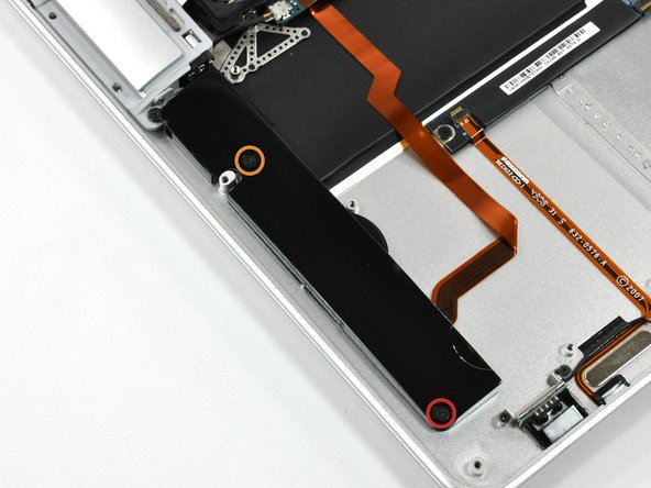

  6. MacBook Air Models A1237 and A1304 Audio Cable Replacement, Speaker: step 6, image 1 of 1
    • Remove the following two screws securing the speaker assembly to the upper case.
    • One 3 mm Phillips.
    • One 5.8 mm Phillips.

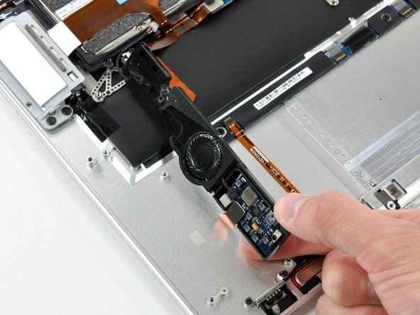

  7. MacBook Air Models A1237 and A1304 Audio Cable Replacement: step 7, image 1 of 2 MacBook Air Models A1237 and A1304 Audio Cable Replacement: step 7, image 2 of 2

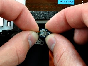

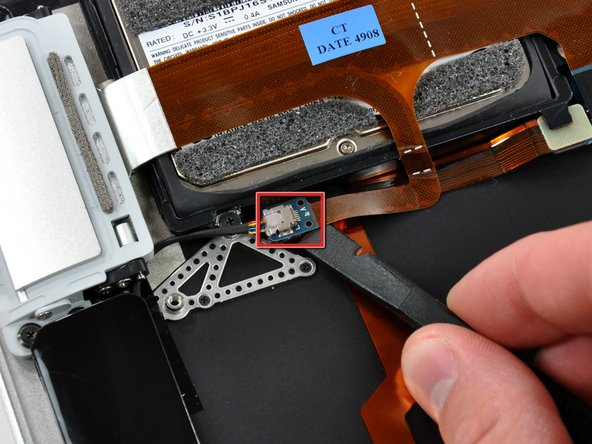

    • Use a spudger to lift the audio-out connector board off the adhesive that secures it to the hard drive bracket.
    • Disconnect the audio out connector from its socket.

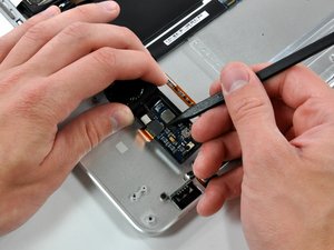

  8. MacBook Air Models A1237 and A1304 Audio Cable Replacement: step 8, image 1 of 2 MacBook Air Models A1237 and A1304 Audio Cable Replacement: step 8, image 2 of 2
    • Rotate the speaker assembly toward the center of the Air.
    • Use a spudger to pry the speaker cable connector up off the audio board.

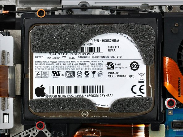

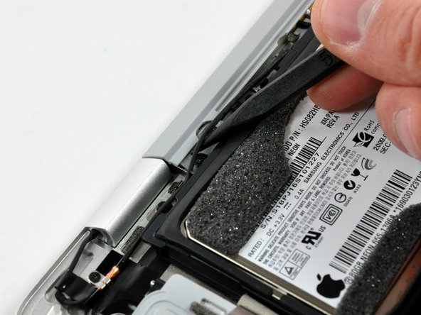

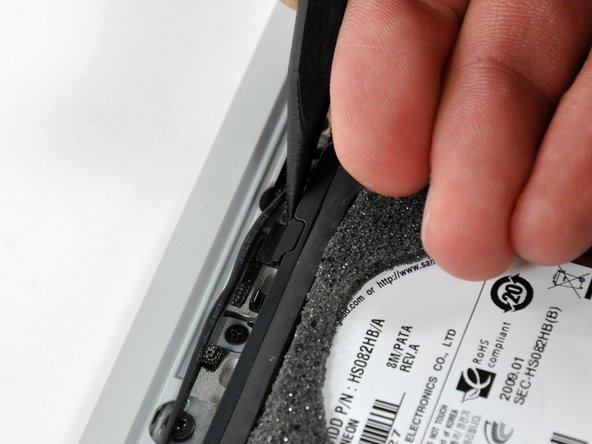

    • Use the pointed end of a spudger to de-route the microphone cable from the hard drive bracket.
  11. MacBook Air Models A1237 and A1304 Audio Cable Replacement: step 11, image 1 of 1
    • Remove the following screws securing the hard drive to the upper case:
    • Two 3.9 mm Phillips screws.
    • One 4.7 mm Phillips screw.
    • This may be a Torx T6 screw.
  12. MacBook Air Models A1237 and A1304 Audio Cable Replacement: step 12, image 1 of 1
    • Use the tip of a spudger to remove the cosmetic screw cover to reveal the last remaining screw securing the hard drive.
  13. MacBook Air Models A1237 and A1304 Audio Cable Replacement: step 13, image 1 of 1
    • Remove the 4.7 mm Phillips screw securing the hard drive to the upper case.

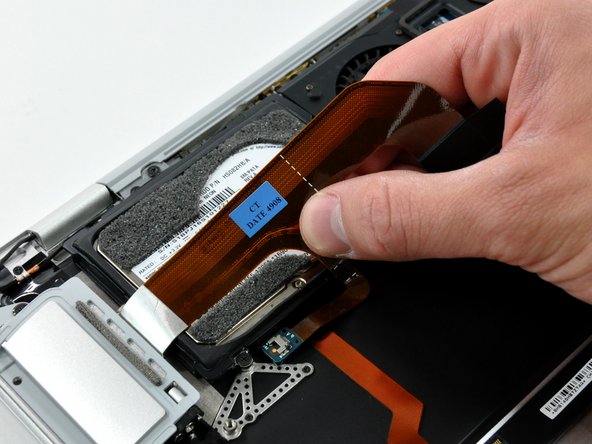

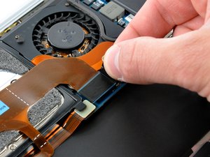

  14. MacBook Air Models A1237 and A1304 Audio Cable Replacement: step 14, image 1 of 2 MacBook Air Models A1237 and A1304 Audio Cable Replacement: step 14, image 2 of 2

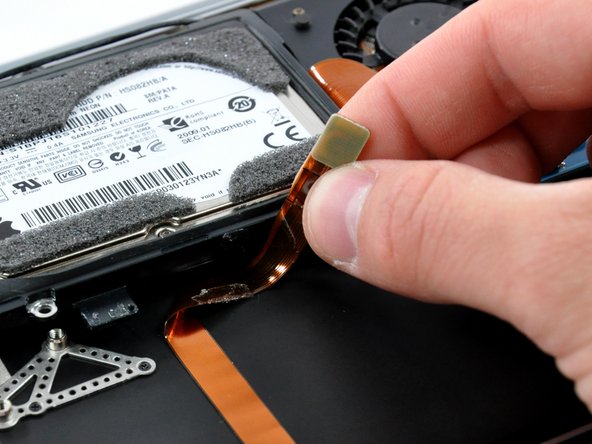

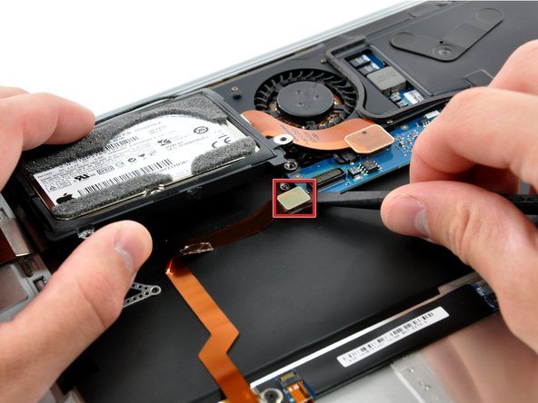

    • Lift the hard drive slightly and use a spudger to pry the audio cable connector up off the logic board.
    • Peel the audio cable off the adhesive securing it to the upper case.
