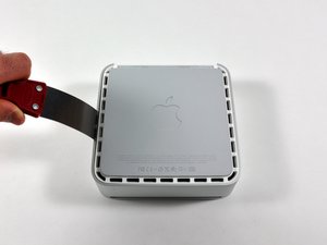

  • You'll need a putty knife in order to open the case. A 1.5 inch thin putty knife will work well, but you'll want to grind the edge down. Rub the putty knife's short edge back and forth on a sheet of all purpose rough grit sandpaper (100 grit will work fine) until it attains a beveled edge.
Image 1/2: Gently enlarge the existing crevice by rotating the putty knife downward and away from the mini.
  • Carefully insert a putty knife into the crevice in between the top cover and bottom housing. Start on the left side first. Push the blade down until you meet firm resistance (roughly 3/8 of an inch).
  • Gently enlarge the existing crevice by rotating the putty knife downward and away from the mini.
  • This is easier if you use two putty knives. Insert the first putty knife at the point on the left side where the gap is largest, press the handle of the knife downward and away from the mini.
  • Then insert the second knife next to it and push that knife down and out.
  • Take the first knife out of the mini and put it back in on the other side of the second knife, push down and out.
  • Repeat this process all the way around the mini.

Would you please post photo of the resulting mac mini case (both metal and plastic part) after these steps? I would like to know if there is any scratches by applying these technique. Thanks.
Use businesscards between case & putty knife if you don't want any scratches. Worked for me.
info5825 - Reply
I had no scratches at all, even without using business cards.
Richard Cacciato -
I tried using business cards with the putty knife, but in the initial stages there just isn't enough room in the slit to get them in there with the putty knife. I was also really worried about scratching the case, but just went really slowly with the putty knife and mine came out scratch free. :)
jeffkao - Reply
I used a wide putty and smoothed the edges all around using a pad sander machine (not necessary but convenient). So there are no marks left on the case.
akronymus -
To avoid scratches from wayward putty knife behaviour, masking tape along the thin perimeter edge of the aluminum case can be your friend. :-)
Alternatively, Good/High quality, *Clear* packing tape (parcel tape) is friendly, too. In my experience, the better quality tapes don't leave a residue when you peel it off of the aluminum case. For easier application to the thin lip of the case, cut a length of tape, then split it down the middle.

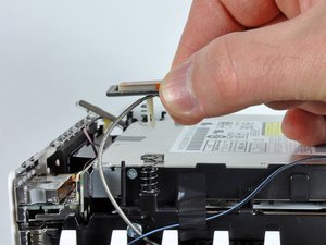

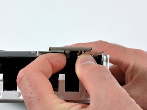

Image 1/1: We will first remove the AirPort antenna, located in the lower left corner of this picture.
  • In the next few steps you will be removing the AirPort and Bluetooth antennas (shown in red) from the internal frame. Be very careful, as breaking the brackets will require replacing the internal frame.
  • We will first remove the AirPort antenna, located in the lower left corner of this picture.

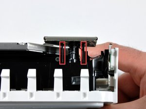

Image 1/2: Squeezing the two posts excessively will surely break them off the internal frame. Work delicately.
  • Slightly squeeze the two retaining arms toward each other and lift the AirPort antenna off its post.
  • Squeezing the two posts excessively will surely break them off the internal frame. Work delicately.
  • During reinstallation, you will have to slightly squeeze the two posts together so they fit into the openings on the AirPort antenna board.

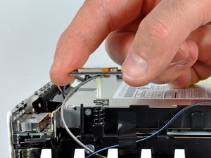

Image 1/2: Grab the Bluetooth antenna nearest the port side of the computer by the edges of the board and pull it straight up off the internal frame.
  • The two Bluetooth antenna boards simply lift off the internal frame.
  • Grab the Bluetooth antenna nearest the port side of the computer by the edges of the board and pull it straight up off the internal frame.
    • Pull carefully, as it may offer significant resistance and release suddenly.
On mine, at least, a considerable amount of force was required to get the bluetooth antennas up off the posts. In fact, I ended up pulling so hard one one of them that when it suddenly came up, I broke the antenna cable. Be careful!
talarohk - Reply
They do need a fair bit of force. Best way for me was first finger and thumb underneath, either side of the post; and first finger of the other hand on top to prevent it "jumping". Then just move up in one smooth motion.
Brian -
Did you repair the antenna or just let it go? I broke my antenna too, and I can't tell if it's a 2-conductor coaxial cable or a single conductor that I could resolder.
Whiskeychief -
Note on re-assembly - there is a "pin" formed from the top of the internal frame which needs to go through the corresponding hole in the antenna assembly. Although the antenna will clip down without it being exactly in place, the antenna will not be "sprung" and will probably foul the cover when it is replaced, probably causing damage.
As you almost certainly wouldn't notice this as you replace the cover, do check that this "pin" is aligned and that the antenna is floating on the spring, before replacing the cover.
Brian - Reply
I realized, that it made it easier when I grab and squeeze just a little on the spiral thing under the antenna while lifting it up.
Sebastian A Dyhr - Reply
A more controlled way of remove the bluetooth antennae: lever them gently off. The closer you are to the centre pin, the more force you will exert there, instead of wasting it bending up the board. You already have the tools - the putty knife & the spudger.
Put the putty knife gently under the board on the side of your non-dominant hand, and then the spudger under the board on the side of your dominant hand. Gently lift the handle of the putty knife and apply constant pressure. Then gently push and wriggle the spudger under the other side with your dominant hand and push constantly forward. The further you push forward, the more upward force you will apply.The antenna will pop up before you get the spudger all the way under, and it will only rise a few mm when it does.
Tim - Reply
Be aware of cable and Bluetooth antenna board upon reinstall. I attempted to reinstall the board as it faced the incorrect direction, and the cable was improperly positioned. The result? Upon snapping the board in, the cable got caught and portion of it was shorn off near the solder. So, be aware of the board and cable positioning on reinstall.
Tomas - Reply
From what I've read elsewhere- the "spiral thing" under the antenna is a plastic clip that
needs to be pinched together with fingertips,to release the antenna from its post.
This should also be done when replacing it, to ensure the antenna will clear the case.
Seems like this detail was skipped in other instructions here.
myretoucher1 - Reply
From my point of view, it's not always necessary to remove those antenna : I left the bluetooth antenna in place and just put the top part of the Mac Mini close to the bottom, linked by the cable.
cochardp - Reply

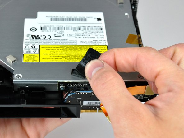

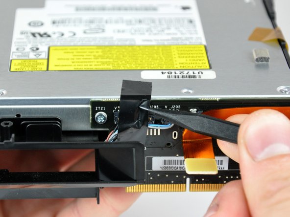

  • Use the tip of a spudger to remove the black electrical tape spanning the interconnect board and optical drive.

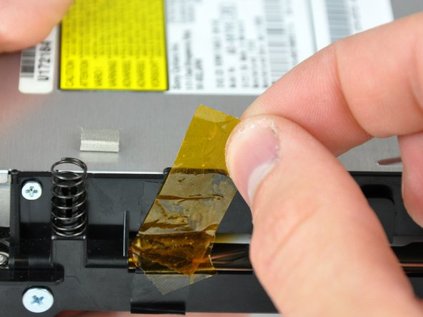

  • If necessary, remove the yellow kapton tape covering the internal frame and the optical drive.

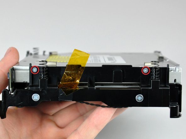

  • Remove the two Phillips screws securing the optical drive to the internal frame.
Image 1/1:
  • Turn the mini 180 degrees and remove the two Phillips screws securing the optical drive to the internal frame on the other side.

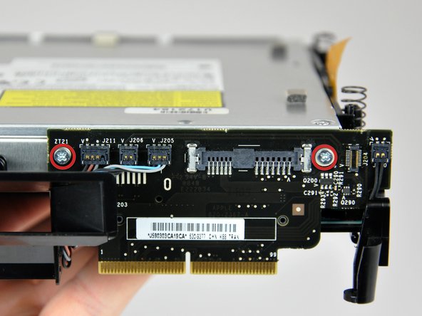

  • Remove the two Phillips screws securing the interconnect board to the optical drive.

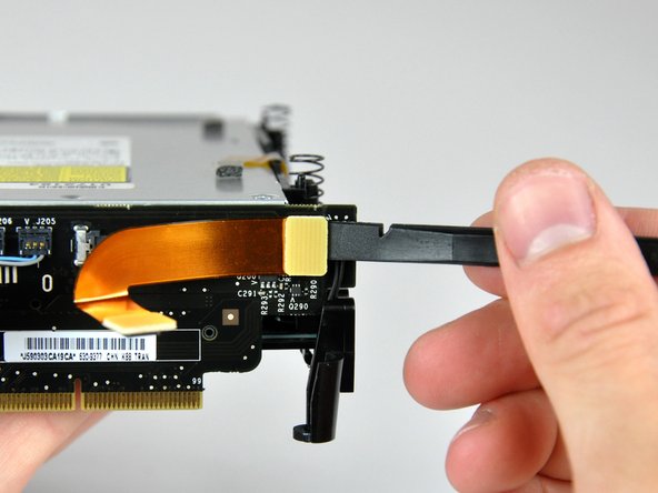

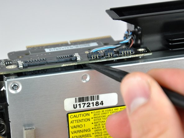

Image 1/1: Carefully increase the crevice to disconnect the optical drive from the interconnect board.
  • Insert the flat end of a spudger into the crevice between the optical drive and the interconnect board.
  • Carefully increase the crevice to disconnect the optical drive from the interconnect board.

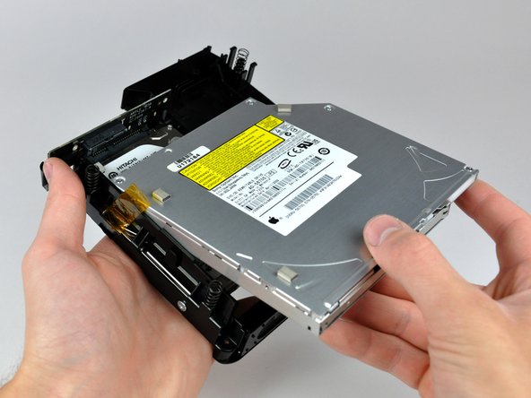

  • Gently lift the optical drive out of the internal frame.
Image 1/1:
  • Transfer the four foam bumpers to the replacement optical drive.
