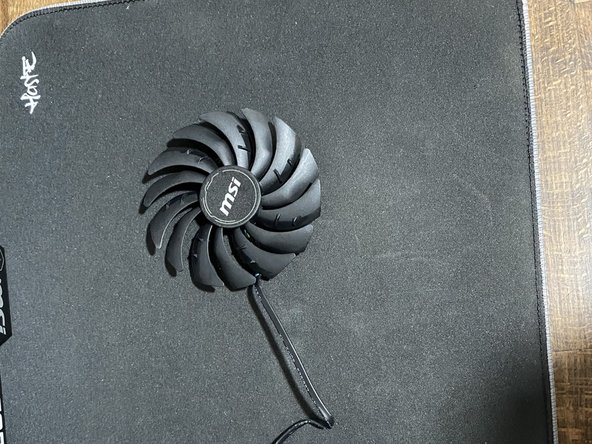

  4. RTX 3070 VENTUS 2X OC  GPU FAN Replacement, gpu fan cable: step 4, image 1 of 2 RTX 3070 VENTUS 2X OC  GPU FAN Replacement, gpu fan cable: step 4, image 2 of 2
    • Remove the gpu cable and it leave behind the bare heatsink
  5. RTX 3070 VENTUS 2X OC  GPU FAN Replacement, Fan screw: step 5, image 1 of 2 RTX 3070 VENTUS 2X OC  GPU FAN Replacement, Fan screw: step 5, image 2 of 2
    • Remove the screws that are holding the fans in place
  6. RTX 3070 VENTUS 2X OC  GPU FAN Replacement, Fan removed: step 6, image 1 of 2 RTX 3070 VENTUS 2X OC  GPU FAN Replacement, Fan removed: step 6, image 2 of 2
    • Get your replacement fan and reverse the order for reassembly.
