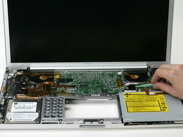

  10. PowerBook G4 Aluminum 17" 1-1.67 GHz PRAM Battery & USB Board Replacement: step 13, image 1 of 1
    • The optical drive ribbon cable is very fragile. Be sure to gently lift up the cable on the sides. Do not lift up on the cable from the end closest to the display.
    • Carefully disconnect the orange optical drive ribbon from the logic board.

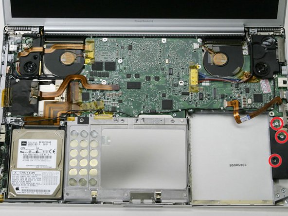

  13. PowerBook G4 Aluminum 17" 1-1.67 GHz PRAM Battery & USB Board Replacement: step 16, image 1 of 1
    • Remove the three 4 mm T8 Torx screws from the PRAM battery board.
  14. PowerBook G4 Aluminum 17" 1-1.67 GHz PRAM Battery & USB Board Replacement: step 17, image 1 of 1
    • Lift the board out of the computer.
