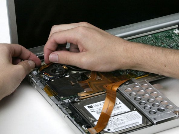

  9. PowerBook G4 Aluminum 17" 1-1.67 GHz DC-In Board Replacement, Bluetooth: step 12, image 1 of 1
    • Use the method described in the step for disconnecting the keyboard ribbon to loosen the connector on the DC-In board.
    • Pull the cable free of the loosened connector.

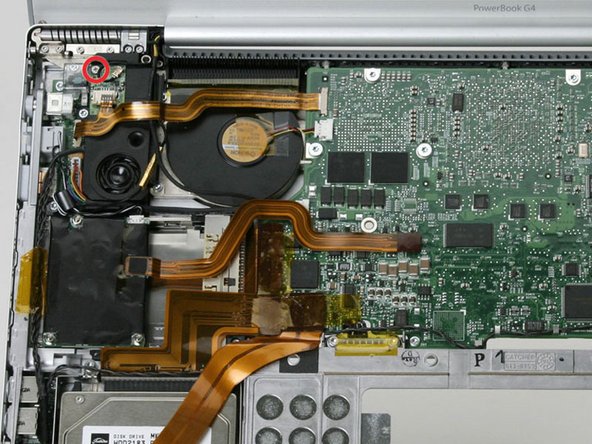

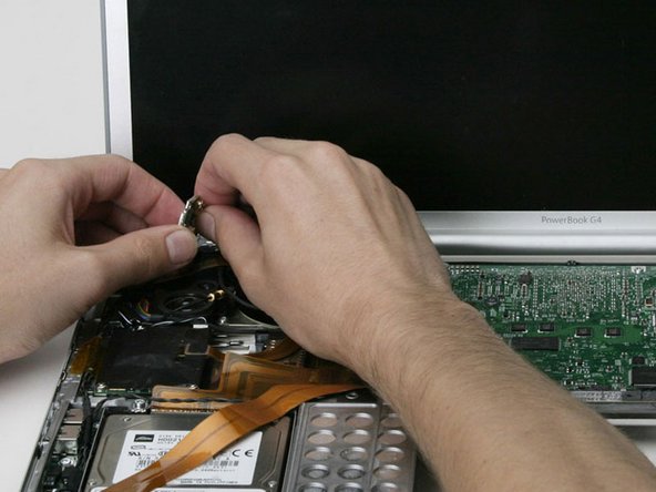

  10. PowerBook G4 Aluminum 17" 1-1.67 GHz DC-In Board Replacement: step 13, image 1 of 1
    • Remove the single Phillips screw from the Bluetooth board.
  11. PowerBook G4 Aluminum 17" 1-1.67 GHz DC-In Board Replacement: step 14, image 1 of 1
    • Lift the Bluetooth board partially out of the computer and disconnect the attached antenna cable.

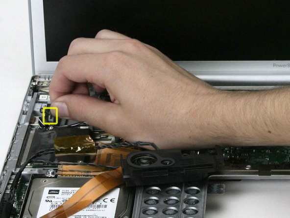

  12. PowerBook G4 Aluminum 17" 1-1.67 GHz DC-In Board Replacement, DC-In Board: step 15, image 1 of 1
    • Disconnect the black speaker cable from the sound board.
  13. PowerBook G4 Aluminum 17" 1-1.67 GHz DC-In Board Replacement: step 16, image 1 of 1

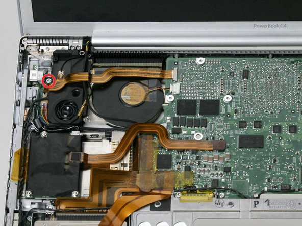

    • Remove the single T8 Torx screw from the left speaker assembly.
  14. PowerBook G4 Aluminum 17" 1-1.67 GHz DC-In Board Replacement: step 17, image 1 of 1

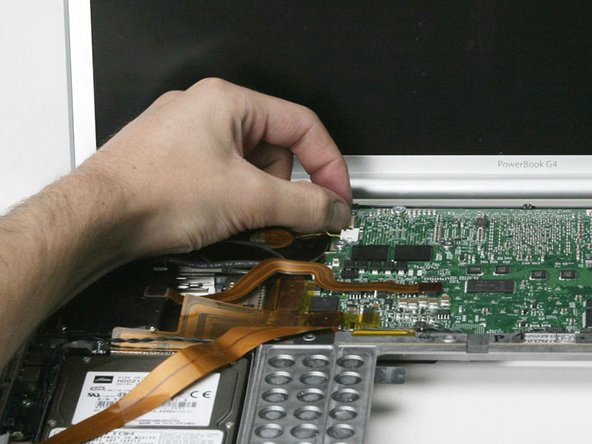

    • Disconnect the orange DC-In cable from the logic board.
  15. PowerBook G4 Aluminum 17" 1-1.67 GHz DC-In Board Replacement: step 18, image 1 of 1
    • Deroute the cables from the right side of the speaker and lift it off of the logic board.
  16. PowerBook G4 Aluminum 17" 1-1.67 GHz DC-In Board Replacement: step 19, image 1 of 1
    • Disconnect the rainbow power cable from the DC-In board.

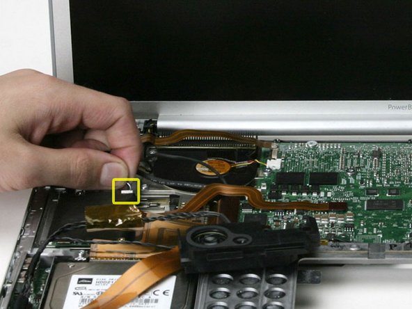

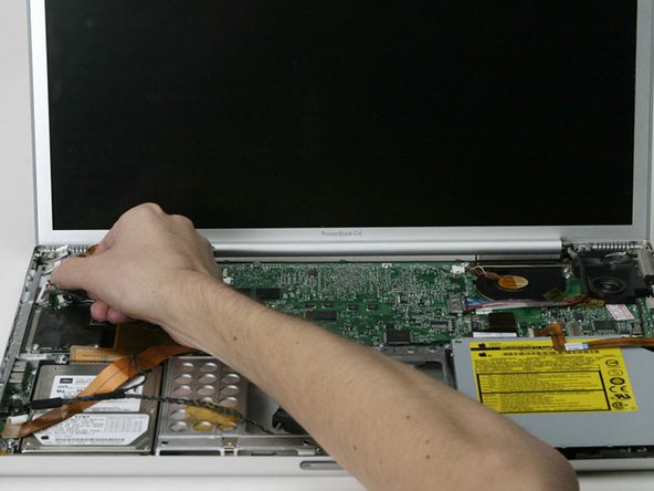

  17. PowerBook G4 Aluminum 17" 1-1.67 GHz DC-In Board Replacement: step 20, image 1 of 1
    • Disconnect the black and white RJ-11 cable from the top, right corner of the modem.

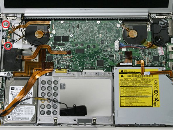

  18. PowerBook G4 Aluminum 17" 1-1.67 GHz DC-In Board Replacement: step 21, image 1 of 1
    • Remove the two identical T8 Torx screws from the DC-In board.
  19. PowerBook G4 Aluminum 17" 1-1.67 GHz DC-In Board Replacement: step 22, image 1 of 1
    • Slide the DC-In board to the right and lift it out of the computer.
    • If the DC-In board sticks, you may need to remove the T8 screw next to the DC-In board to free it.
