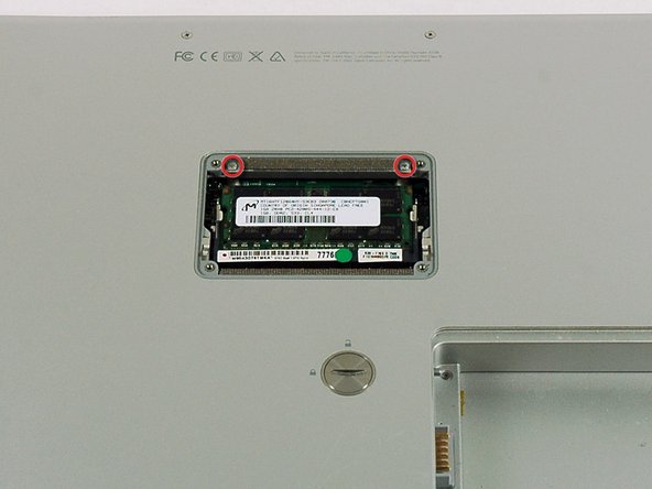

3 Edit Step 3  ¶
Image 1/1: Remove the two 12 mm Phillips screws on the Aluminum bracket at the top of the memory compartment.
3 Edit Step 3  ¶
  • Remove the memory compartment cover.
  • Remove the two 12 mm Phillips screws on the Aluminum bracket at the top of the memory compartment.

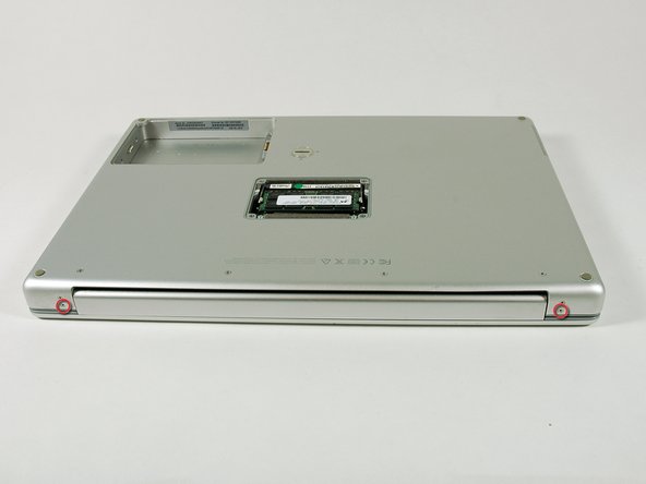

Edit Step 5  ¶
Image 1/1: Remove the lower 5 mm Phillips screw on each side of the hinge (two total).
Edit Step 5  ¶
  • Turn the computer 90 degrees clockwise so the hinge faces you.
  • Remove the lower 5 mm Phillips screw on each side of the hinge (two total).

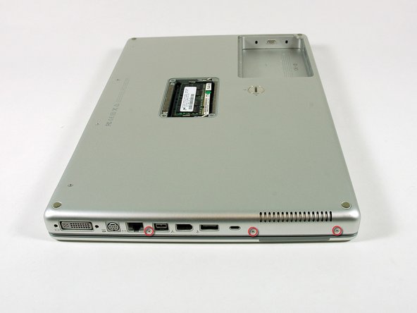

Edit Step 6  ¶
Image 1/1: Remove the three 3 mm Phillips screws along the edge of the lower case.
Edit Step 6  ¶
  • Rotate the computer 90 degrees clockwise so the ports face you.
  • Remove the three 3 mm Phillips screws along the edge of the lower case.
  • When replacing these screws, you must install them in the correct order. Begin by installing the screw closest to the display hinge, then work your way toward the front of the computer. Also, be careful not to put the screws in the two holes on either side of the video out port.

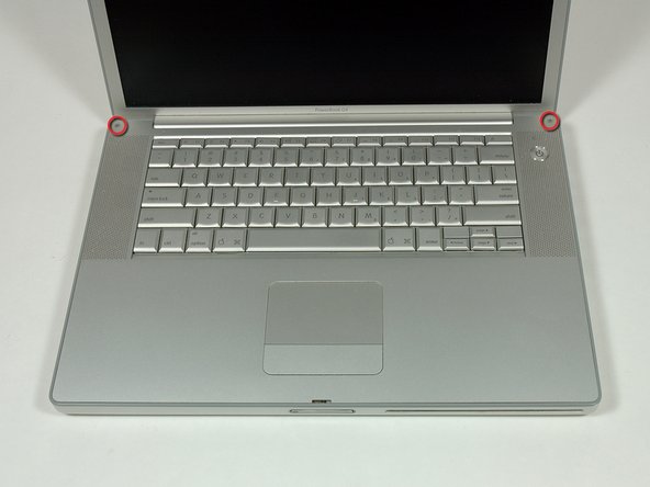

Edit Step 7  ¶
Image 1/1: Remove the two 4.2 mm long, 1.5 mm hex screws at the top corners of the upper case (two total).
Edit Step 7  ¶
  • Turn the computer over and open the display.
  • Remove the two 4.2 mm long, 1.5 mm hex screws at the top corners of the upper case (two total).
  • A T6 Torx driver will work, but repeated use will strip the screws.

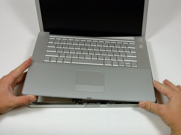

Edit Step 8  ¶
Image 1/1: Do not pull the upper case off yet; you still need to disconnect the keyboard and trackpad cable.
Edit Step 8  ¶
  • Grasp the back corners of the upper case and pull up.
    • Do not pull the upper case off yet; you still need to disconnect the keyboard and trackpad cable.
  • Lift the back of the case up and work your fingers along the sides, freeing the case as you go. Once you have freed the sides, you may need to rock the case up and down to free the front of the upper case.

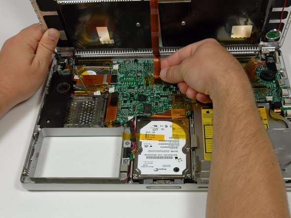

2 Edit Step 10  ¶
Image 1/1: Disconnect the trackpad ribbon from the logic board by pulling up on the connector.
2 Edit Step 10  ¶
  • Remove the amber tape securing the trackpad ribbon to the logic board.
  • Disconnect the trackpad ribbon from the logic board by pulling up on the connector.
  • Remove the upper case from the computer.

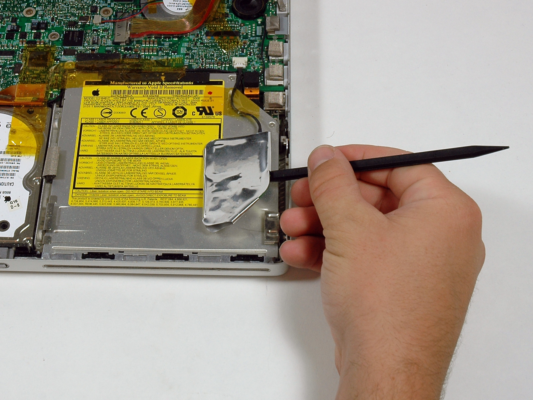

Edit Step 11 PRAM Battery  ¶
Image 1/1:
  • Use a spudger to pry up the PRAM battery from the optical drive.
1 Edit Step 12  ¶
Image 1/1: Remove tape as necessary.
1 Edit Step 12  ¶
  • Disconnect the PRAM battery cable from the logic board and remove the PRAM battery.
  • Remove tape as necessary.

I had 7mm screws here instead of 12mm. Did without them till later.
gepkes - Reply

First of all, awesome guide. I am using it in July 2015, and there is no way I could have successfully navigate the typical Apple laptop Rubik's cube of Powerbook maintenance.
Second, there is a REAL trick to removing the upper case here, and it involves knowing what those stupid internal metal catches look like so you can free them without folding your aluminum case into a pretzel.
WildBill - Reply
in my g4 there is also a big transparent ribbon (for keyboard?), to the right of the amber trackpad ribbon, that i disconnected before removing case cover.
ykuwabara - Reply
re: ykuwabara; this is due to the differences between the Model A1095 (yours) and the newer A1138 (illustrated here). The A1138 combines the keyboard and trackpad signals into one cable.
aaiverson - Reply
This step is unnecessary, the drive can be removed without disconnecting the PRAM battery. Simply fold the battery back onto the logic board.
Jeff Johnson - Reply
