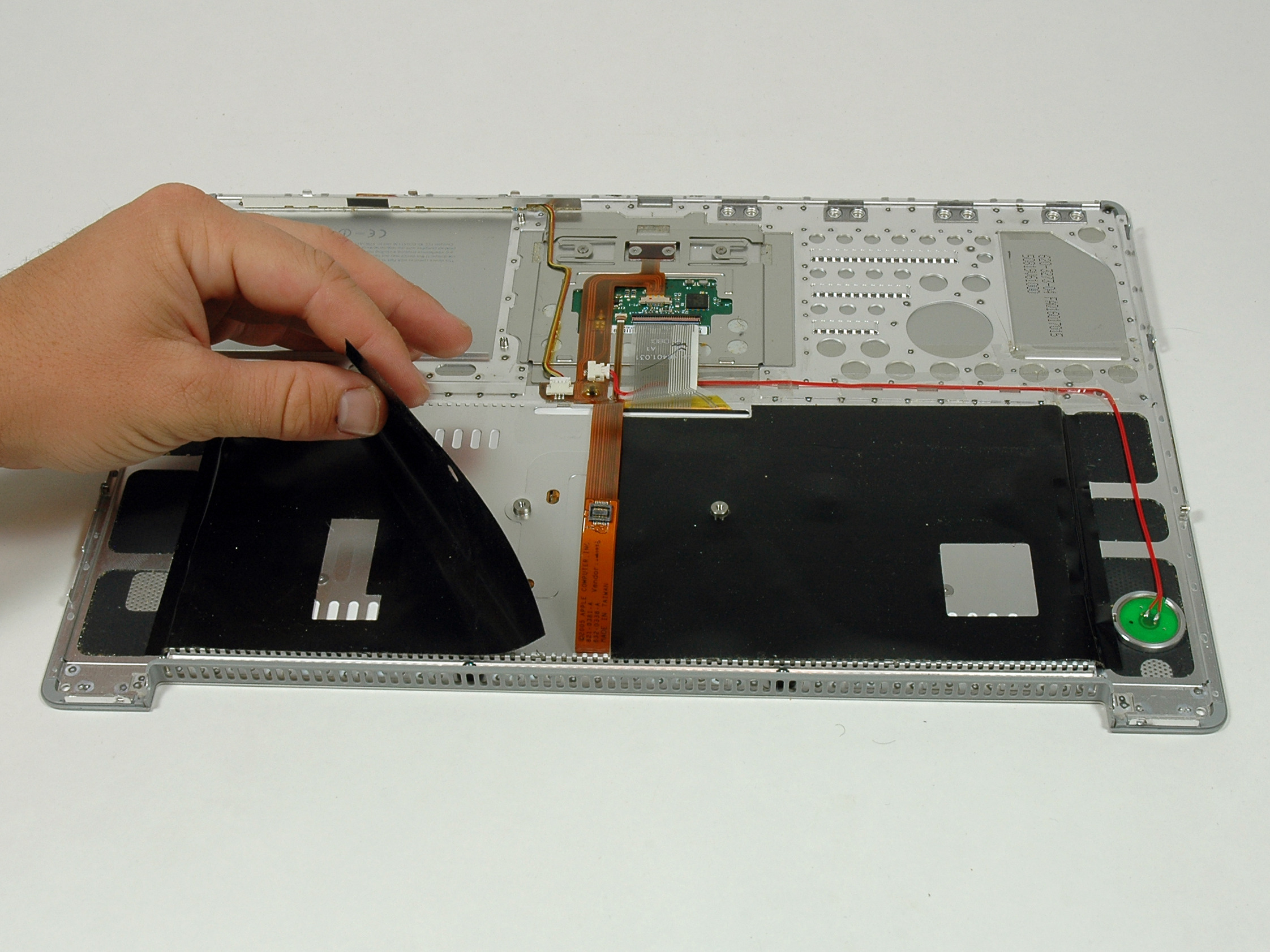

Edit Step 11 Keyboard  ¶
Image 1/1: Peel back the black plastic shielding on either side of the keyboard (there are two pieces).
  • On the following step, be careful with the tape on the side of the keyboard with the green power button, as the tape may stick and tear.
  • Peel back the black plastic shielding on either side of the keyboard (there are two pieces).

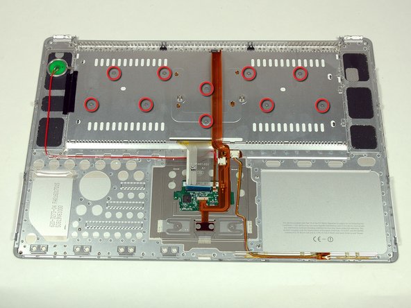

Edit Step 14  ¶
Image 1/1:
Edit Step 14  ¶
  • Remove the 10 identical Phillips screws attaching the keyboard to the casing.

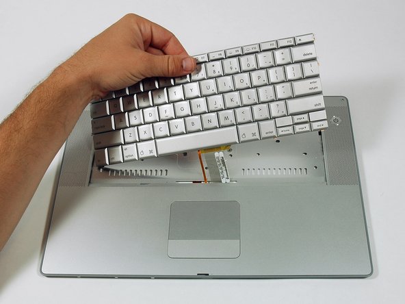

Edit Step 18  ¶
Image 1/1:
Edit Step 18  ¶
  • Maintaining your hold on the keyboard, lay the casing flat and gently bow the keyboard until the two tabs on either side of the keyboard come free.
Edit Step 19  ¶
Image 1/1:
Edit Step 19  ¶
  • Slide the keyboard away from the trackpad and out of the upper case.
Edit Step 20  ¶
Image 1/1:
Edit Step 20  ¶
  • To replace the keyboard, first slide the bottom tabs into the upper case. Then bow the keyboard out and first slide the tabs in on the right side of the keyboard, then slide in the tabs on the left side.
