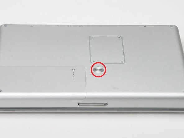

Use a coin to turn the battery locking screw 90 degrees to the right.
Lift the battery out of the computer.

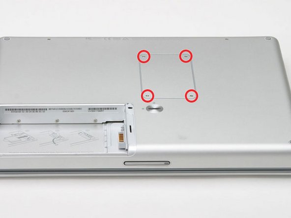

Remove the four Phillips screws from the memory door.
Slide the memory door away from the memory compartment.

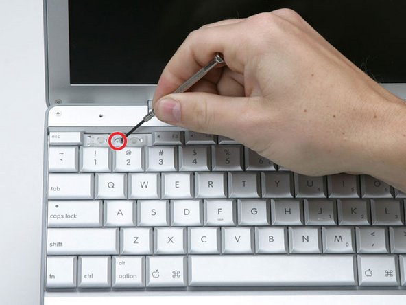

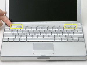

On the keyboard, remove the F1, F2, F11, and F12 keys.
This is scary - take a deep breath before continuing. Place your index finger under the upper left corner of the key and lift up until you hear a click. Then, transfer your finger to the left edge of the key and lift up to pull the key off.
You're freeing the two tabs on the left of the key from the two small holes in the plastic scissors mechanism.

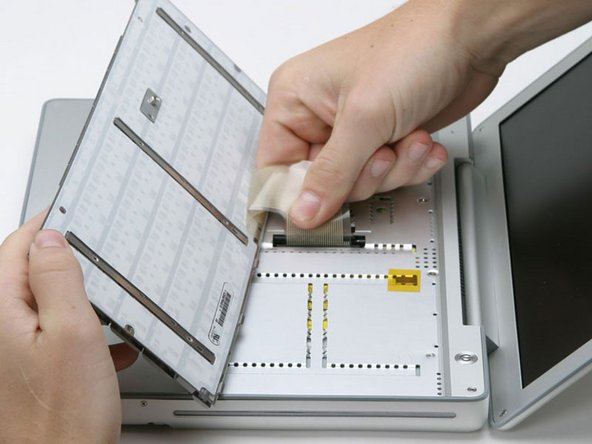

Lift the keyboard by the 'esc' and 'eject' keys and gently lift up until the keyboard is vertical.

Should this step specify that the memory door is now to be replaced? At Step 9 the photos show it back in place and yet I didn't see where it was to be screwed back on.
FWIW, my PB did not have an EMI Finger (assume some earlier repair removed it and did not put it back). Is that a concern?
kah - Reply

Step 8
I would not pull up on the ribbon as is being done in the picture. Note that the black pastic base that you see is the connector part that is permanently attached to the ribbon cable. Use a small screwdriver or spudger alternately on each end of the black plastic base to pry and rock it upwards.
jerrykrinock - Reply
I agree. I was able to use a needle nose pliers to gently grab the black connector and wiggle the connector from the motherboard.
emanmb - Reply
