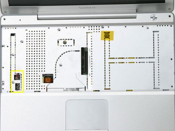

  5. PowerBook G4 Aluminum 12" 1-1.5 GHz Hard Drive Replacement: step 5, image 1 of 1
    • Use your fingernail or a small flathead screwdriver to peel up the gray stickers covering each of the screws.
  6. PowerBook G4 Aluminum 12" 1-1.5 GHz Hard Drive Replacement: step 6, image 1 of 1
    • Remove the two short Phillips screws.

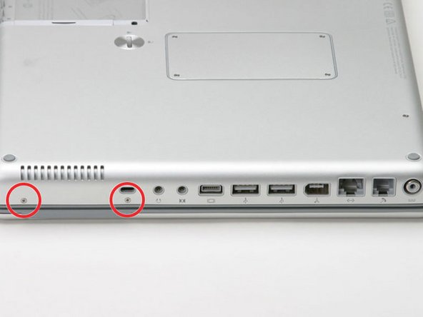

  10. PowerBook G4 Aluminum 12" 1-1.5 GHz Hard Drive Replacement: step 10, image 1 of 1

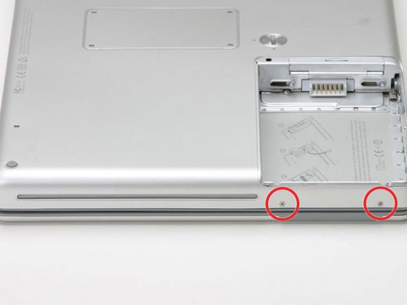

    • Turn the computer 90 degrees clockwise and remove the two Phillips screws from the casing.
    • Outside case screws are aprox. 1/4 in long

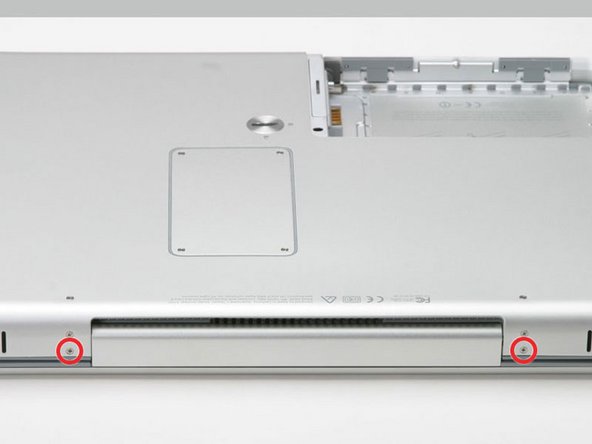

    • Turn the computer 90 degrees clockwise again, and remove only the bottom screw on either side of the hinge.
  12. PowerBook G4 Aluminum 12" 1-1.5 GHz Hard Drive Replacement: step 12, image 1 of 1

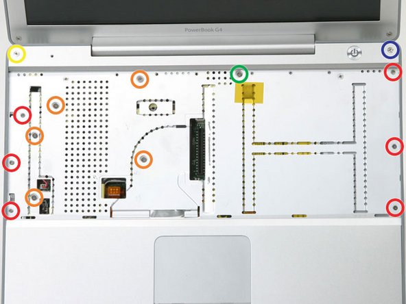

    • Remove the following 14 screws:
    • Six 2.5 mm Phillips on either side of the keyboard area.
    • Five 4.5 mm Phillips on the left half of the keyboard area.
    • One 7 mm hex in the upper left corner of the upper case (a T6 Torx driver will do the job nicely).
    • One 15 mm Phillips in the upper middle of the keyboard area.
    • One 16.5 mm hex in the upper right of the upper case (again, a T6 Torx driver will work well).

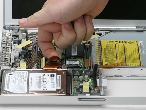

  14. PowerBook G4 Aluminum 12" 1-1.5 GHz Hard Drive Replacement: step 14, image 1 of 1

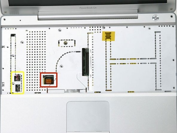

    • This step is extremely tricky, and has the potential to ruin your computer. It is easy to pull the plug with the red and black leads (the power) out of the motherboard. If you do that, it is nearly impossible to fix.
    • Peel up the two pieces of foil tape on the left side of the keyboard area.
    • The connectors at the ends of the cables are attached very firmly to the sockets on the logic board. Pulling directly on the cable will either separate the cable from its connector or the socket from the logic board.
    • Carefully disconnect the microphone and power cables from the logic board. Using your fingernails or a dental pick, carefully pry the connectors from their sockets. Make sure you're pulling only on the connector and not on the socket.

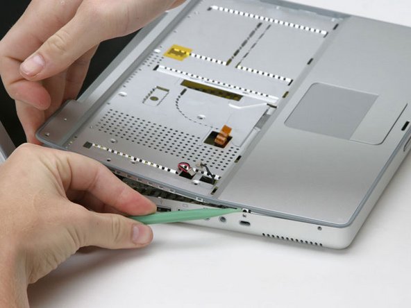

    • Starting at one of the upper corners near the screen, work around the frame, separating the upper case from the lower case.
  16. PowerBook G4 Aluminum 12" 1-1.5 GHz Hard Drive Replacement: step 16, image 1 of 1
    • Using a screw driver, gently release the two grey plastic clips inside the battery compartment in order to remove the right part of the upper case.
    • There are two more grey plastic clips holding the left part of the upper case. They are not easy to release as they are hidden from view prior to disassembly. They are in the same position as the two in the battery compartment, but on the opposite side of the trackpad. Try to stick a flat pry tool into the clip holes and push the clips inward (toward to screen) so they disengage and release the left part of the upper case.
    • Lift the upper case off the computer.

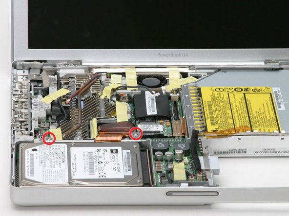

    • Remove the two Phillips screws from the hard drive bracket.
  18. PowerBook G4 Aluminum 12" 1-1.5 GHz Hard Drive Replacement: step 18, image 1 of 1
    • Use the orange plastic loop to disconnect the hard drive cable from the logic board.
  19. PowerBook G4 Aluminum 12" 1-1.5 GHz Hard Drive Replacement: step 19, image 1 of 1
    • Use the orange cable to pull the hard drive up, then pull it and the hard drive bracket out of the computer.

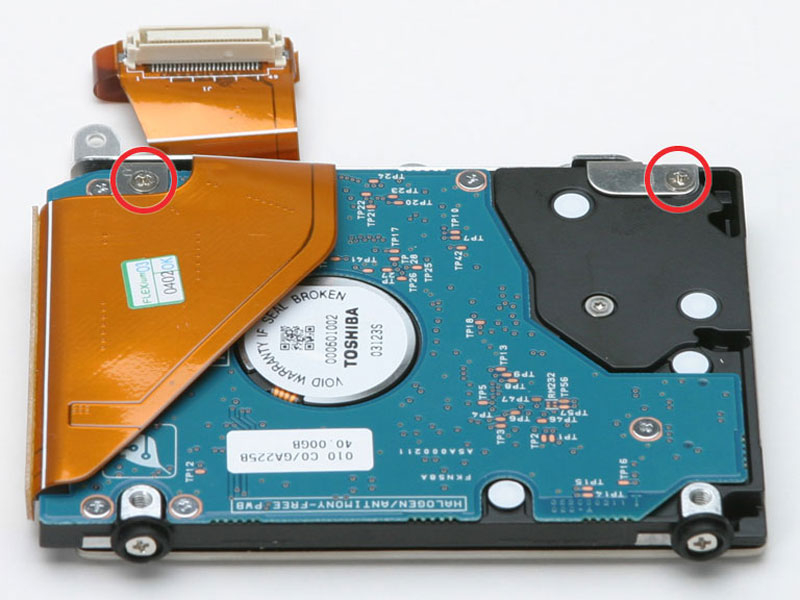

  20. PowerBook G4 Aluminum 12" 1-1.5 GHz Hard Drive Replacement, Hard Drive: step 20, image 1 of 1

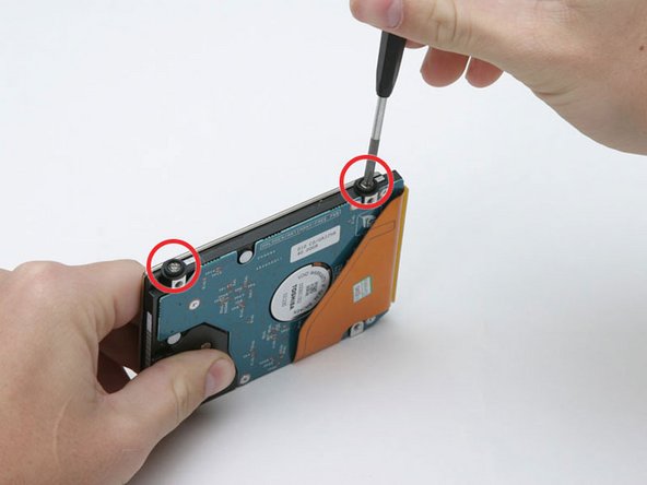

    • Remove the two Phillips screws on the bottom of the hard drive.
  21. PowerBook G4 Aluminum 12" 1-1.5 GHz Hard Drive Replacement: step 21, image 1 of 1
    • Remove the two Phillips screws and black rubber bumpers from the right side of the hard drive bracket.
    • Lift the metal bracket off of the hard drive.
    • Carefully peel the orange hard drive ribbon up from the bottom of the hard drive.

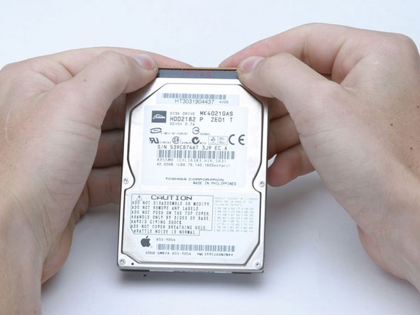

  22. PowerBook G4 Aluminum 12" 1-1.5 GHz Hard Drive Replacement: step 22, image 1 of 1
    • Disconnect the hard drive cable from the hard drive by applying even pressure on both sides while maintaining a firm grip on the drive itself.
    • This is a bit tricky. Try holding the drive against your body while pushing the cable away from you, or rocking the cable gently from side to side while applying even pressure, or both. If you bend the pins, do your best to straighten them, using the hard drive cable as a guide.
