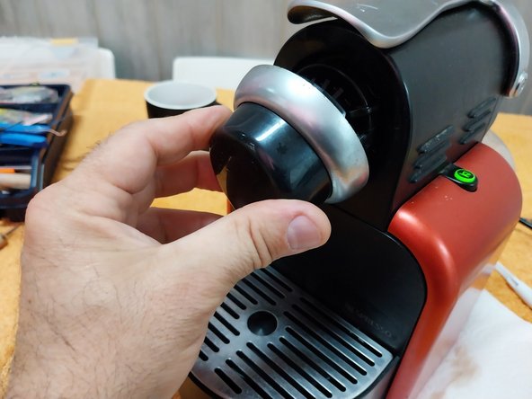

      • This disassembly and repair applies to the NESPRESSO Delonghi EN 95.R COFFEE MACHINE and similar models, it is applicable to many other models.
      • This repair is needed when the coffee outlet at the "Parrot Beak" becomes clogged or partially clogged. When coffee residue in one of the two interior 'ramps' for coffee exit are blocked, it overflows to the inside, ending up inside the device "THE MACHINE LEAKS WATER AND COFFEE"

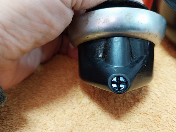

    2. Nespresso Delonghi EN 95.R coffee machine Cleaning parrot beak coffee outlet clogged (Leaks coffee into case).: step 2, image 1 of 3 Nespresso Delonghi EN 95.R coffee machine Cleaning parrot beak coffee outlet clogged (Leaks coffee into case).: step 2, image 2 of 3 Nespresso Delonghi EN 95.R coffee machine Cleaning parrot beak coffee outlet clogged (Leaks coffee into case).: step 2, image 3 of 3
      • In testing whether the problem was a clog, in the "parrot beak" I saw coffee drip inside, under the capsule press. In this case it squirted occasionally, so before going any further I took the opportunity to clean it... and while doing so make this guide.

    4. Nespresso Delonghi EN 95.R coffee machine Cleaning parrot beak coffee outlet clogged (Leaks coffee into case).: step 4, image 1 of 3 Nespresso Delonghi EN 95.R coffee machine Cleaning parrot beak coffee outlet clogged (Leaks coffee into case).: step 4, image 2 of 3 Nespresso Delonghi EN 95.R coffee machine Cleaning parrot beak coffee outlet clogged (Leaks coffee into case).: step 4, image 3 of 3
      • We insert the thin knife-blade between the black casing and the silver trim, on both sides of the 'parrot's beak' black cover. Once the blade is inserted we lightly pry to forty-five degrees at the Nine o'clock and 3 o'clock positions.
      • The disassembly "of the Parrot's Beak" in this particular machine is very simple, all that's needed is a small knife with a thin blade, and no teeth. Just prying on the two sides.

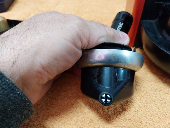

    5. Nespresso Delonghi EN 95.R coffee machine Cleaning parrot beak coffee outlet clogged (Leaks coffee into case).: step 5, image 1 of 2 Nespresso Delonghi EN 95.R coffee machine Cleaning parrot beak coffee outlet clogged (Leaks coffee into case).: step 5, image 2 of 2
      • Once unlatched, we use our fingernails, moving the 'beak' towards the front and tilting it downward.

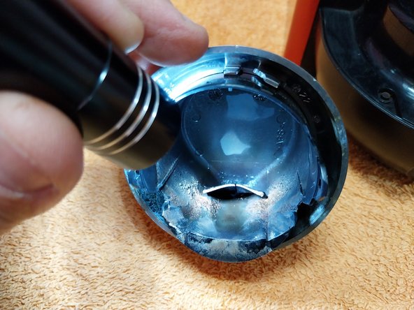

    8. Nespresso Delonghi EN 95.R coffee machine Cleaning parrot beak coffee outlet clogged (Leaks coffee into case).: step 8, image 1 of 3 Nespresso Delonghi EN 95.R coffee machine Cleaning parrot beak coffee outlet clogged (Leaks coffee into case).: step 8, image 2 of 3 Nespresso Delonghi EN 95.R coffee machine Cleaning parrot beak coffee outlet clogged (Leaks coffee into case).: step 8, image 3 of 3
      • photos of the inside of the 'parrot's beak', I advise you to use a flashlight. In these cases it is very useful, as we see, the beak has two ramps, (this one is quite clean despite the coffee residues present), the clog usually occurs in the lower ramp, jamming the two lower holes of the four that the exit point has.
      Ask FixBot
    9. Nespresso Delonghi EN 95.R coffee machine Cleaning parrot beak coffee outlet clogged (Leaks coffee into case).: step 9, image 1 of 3 Nespresso Delonghi EN 95.R coffee machine Cleaning parrot beak coffee outlet clogged (Leaks coffee into case).: step 9, image 2 of 3 Nespresso Delonghi EN 95.R coffee machine Cleaning parrot beak coffee outlet clogged (Leaks coffee into case).: step 9, image 3 of 3
      • With the flashlight, we examine the state of the fixed part of the parrot's beak, we see quite a lot of coffee residue has accumulated.

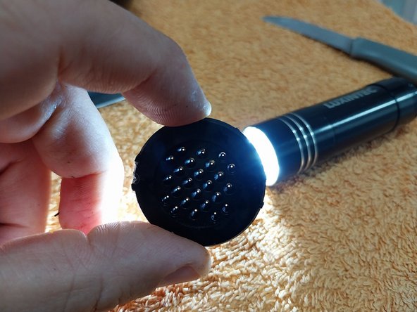

    10. Nespresso Delonghi EN 95.R coffee machine Cleaning parrot beak coffee outlet clogged (Leaks coffee into case).: step 10, image 1 of 2 Nespresso Delonghi EN 95.R coffee machine Cleaning parrot beak coffee outlet clogged (Leaks coffee into case).: step 10, image 2 of 2
      • Now we check the holes, (In this case they have residue, but aren't clogged), I've already mentioned that this machine was not particularly bad; I found one with three of the four holes clogged.

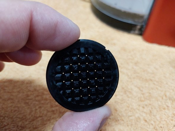

    11. Nespresso Delonghi EN 95.R coffee machine Cleaning parrot beak coffee outlet clogged (Leaks coffee into case).: step 11, image 1 of 2 Nespresso Delonghi EN 95.R coffee machine Cleaning parrot beak coffee outlet clogged (Leaks coffee into case).: step 11, image 2 of 2
      • This step varies on an individual basis, my advice is if you are not clear about it and/or you do not have a thin metal rod to make a punch: DO NOT DO IT SINCE IT ISN'T NECESSARY, YOU CAN DO THE CLEANING ANOTHER WAY.
      • In this example I used a homemade tool made with a razor handle and a thin steel rod WITH A BLUNT TIP.
      • I started to disassemble the screen where the capsule rests.
      Ask FixBot
    12. Nespresso Delonghi EN 95.R coffee machine Cleaning parrot beak coffee outlet clogged (Leaks coffee into case).: step 12, image 1 of 3 Nespresso Delonghi EN 95.R coffee machine Cleaning parrot beak coffee outlet clogged (Leaks coffee into case).: step 12, image 2 of 3 Nespresso Delonghi EN 95.R coffee machine Cleaning parrot beak coffee outlet clogged (Leaks coffee into case).: step 12, image 3 of 3
      • ATTENTION IF WE DO NOT WANT TO DISASSEMBLE THE SCREEN, YOU CAN GO DIRECTLY TO STEP 16. Photo 1: View using a flashlight, of the center hole through which we will insert the homemade tool or a rod to push the screen.
      • We insert the tool and push, it is not easy, but the round screen with holes pops out.
      • IF WE DO NOT WANT TO DO THIS STEP, we can skip it, and instead clean the screen under running water using a HARD BRISTLE toothbrush. It isn't perfect, but it is quite good.

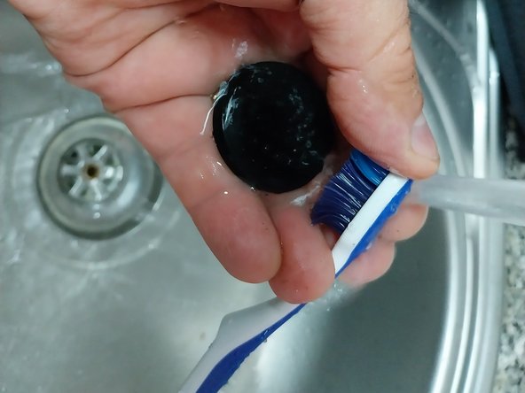

    14. Nespresso Delonghi EN 95.R coffee machine Cleaning parrot beak coffee outlet clogged (Leaks coffee into case).: step 14, image 1 of 2 Nespresso Delonghi EN 95.R coffee machine Cleaning parrot beak coffee outlet clogged (Leaks coffee into case).: step 14, image 2 of 2
      • Examine the screen with a flashlight and clean it with plenty of water, using a HARD bristle toothbrush.

    20. Nespresso Delonghi EN 95.R coffee machine Cleaning parrot beak coffee outlet clogged (Leaks coffee into case).: step 20, image 1 of 3 Nespresso Delonghi EN 95.R coffee machine Cleaning parrot beak coffee outlet clogged (Leaks coffee into case).: step 20, image 2 of 3 Nespresso Delonghi EN 95.R coffee machine Cleaning parrot beak coffee outlet clogged (Leaks coffee into case).: step 20, image 3 of 3
      • Now it's time to clean the parrot's beak, again using a HARD toothbrush. We can also use a small painter's brush, since the lower holes are in a fairly narrow gap (and plenty of water).
      Ask FixBot
    21. Nespresso Delonghi EN 95.R coffee machine Cleaning parrot beak coffee outlet clogged (Leaks coffee into case).: step 21, image 1 of 1
      • Only when the coffee residue is very dry and caked would we use a fine screwdriver or round toothpicks to scrape off the coffee remains... Without damaging the parts.
