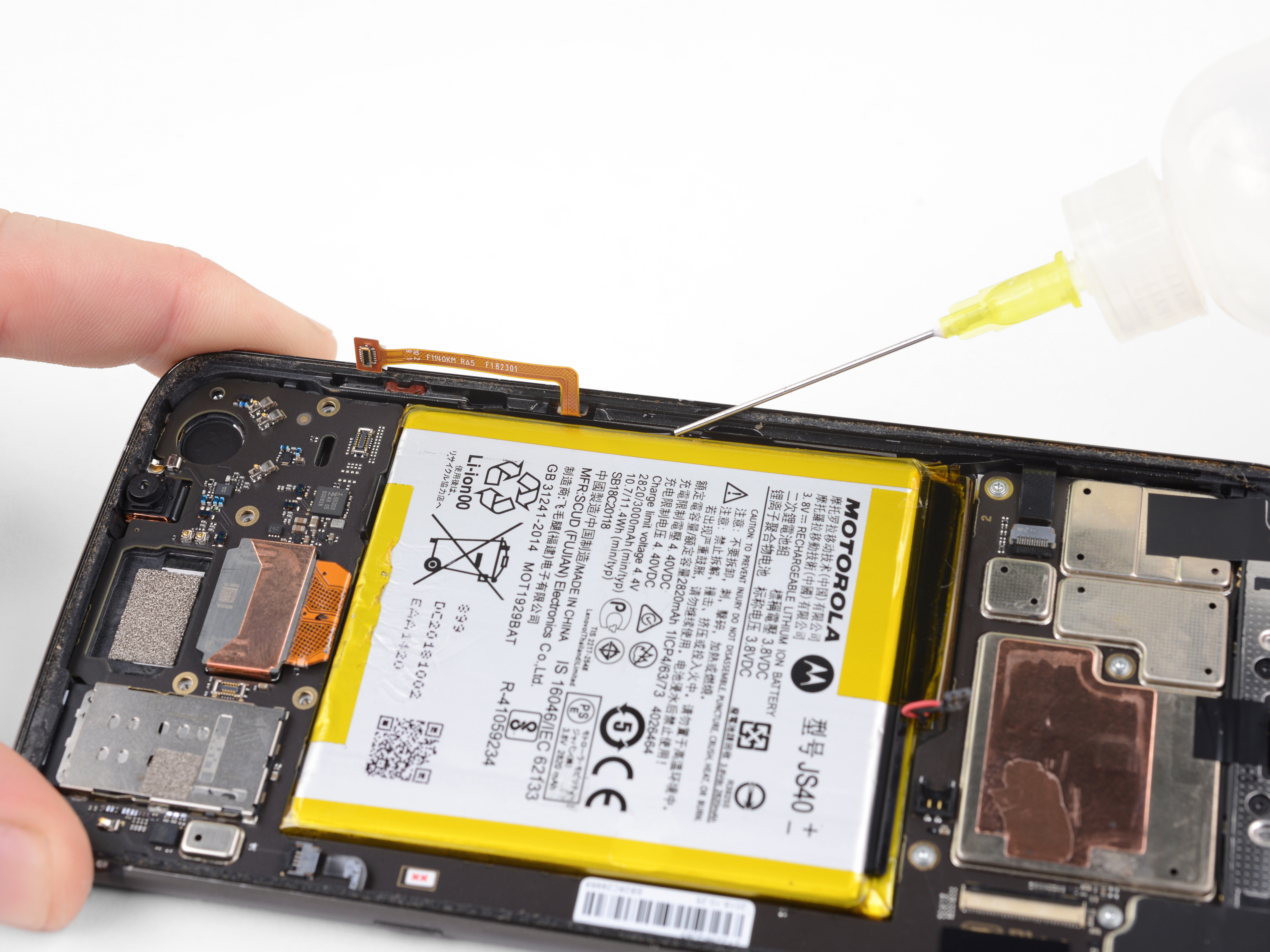

  20. Motorola Moto Z2 Force Battery Replacement, Heat the Battery Adhesive: step 20, image 1 of 1
    • Apply a freshly heated iOpener to the back of the phone directly behind the battery for two minutes to help soften the adhesive. Re-heat and reapply the iOpener as necessary.
    • Alternatively, apply high-concentration (>90%) isopropyl alcohol under the edge of the battery to weaken the adhesive underneath.
    • Let the phone sit for several minutes to allow the alcohol to penetrate and weaken the adhesive.
  21. Motorola Moto Z2 Force Battery Replacement, Remove the Battery: step 21, image 1 of 3 Motorola Moto Z2 Force Battery Replacement, Remove the Battery: step 21, image 2 of 3 Motorola Moto Z2 Force Battery Replacement, Remove the Battery: step 21, image 3 of 3
    • Insert a flexible plastic tool on the left edge of the battery. We use an opening pick here, but a playing card is a safer (albeit slower) option.
    • Gently pry up the battery with constant steady force.
    • Try to slowly release the battery's adhesive without deforming the battery. If the battery begins to bend out of shape, pry slower or apply more heat/isopropyl alcohol. Several rounds of heating or alcohol may be necessary.
    • Do not use excessive force or pry the battery with metal tools.
    • Slowly work your tool underneath the battery and continue prying until it is completely released from its adhesive.
