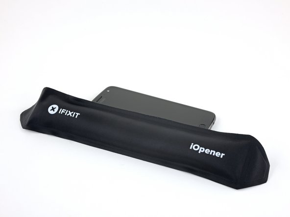

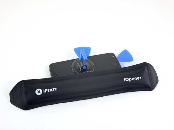

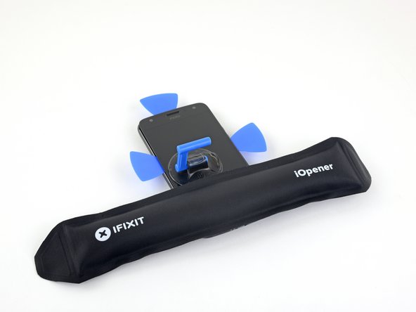

  1. Before you begin, turn off your phone. Heat an iOpener and apply it to the left edge of the phone for two minutes.
    • Before you begin, turn off your phone.
    • Heat an iOpener and apply it to the left edge of the phone for two minutes.
    • You may need to reheat and reapply the iOpener several times to get the phone warm enough. Follow the iOpener instructions to avoid overheating.
    • A hair dryer, heat gun, or hot plate may also be used, but be careful not to overheat the phone—the display and internal battery are both susceptible to heat damage.

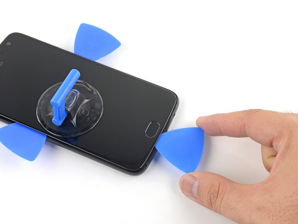

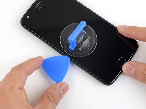

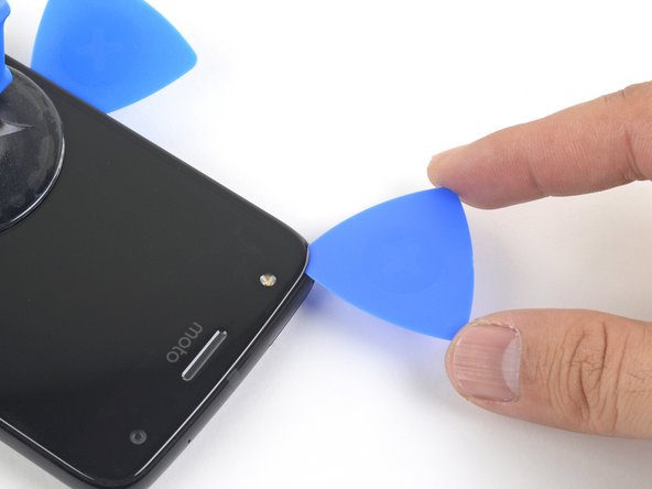

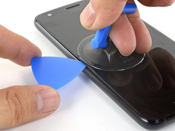

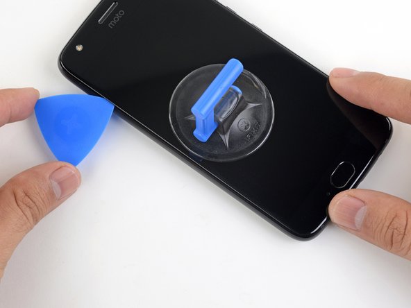

  2. Apply a suction cup to the screen, as close to the heated edge as possible. Pull on the suction cup with strong, steady force to create a gap in the seam. Insert the point of an opening pick into the gap.
    • Apply a suction cup to the screen, as close to the heated edge as possible.
    • Pull on the suction cup with strong, steady force to create a gap in the seam.
    • Insert the point of an opening pick into the gap.
    • Depending on the age of your phone, this may be difficult. If you are having trouble, apply heat to the edge and try again.

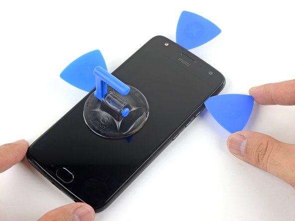

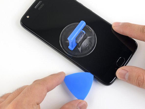

  3. Slide the opening pick along the edge to slice through the adhesive. Leave an opening pick in the seam to prevent the adhesive from re-sealing. Leave an opening pick in the seam to prevent the adhesive from re-sealing.
    • Slide the opening pick along the edge to slice through the adhesive.
    • Leave an opening pick in the seam to prevent the adhesive from re-sealing.

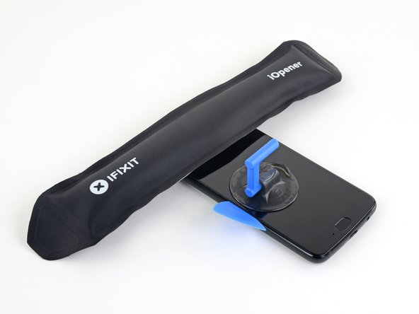

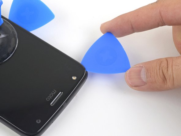

  4. Heat the top edge of the phone with an iOpener. Carefully slice around the corner and through the top edge to separate the adhesive. Carefully slice around the corner and through the top edge to separate the adhesive.
    • Heat the top edge of the phone with an iOpener.
    • Carefully slice around the corner and through the top edge to separate the adhesive.

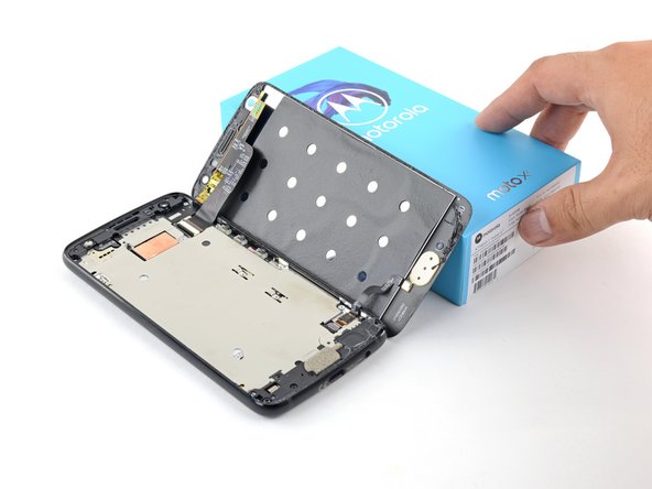

  9. Swing open the screen and prop it up with a small box as you work on disconnecting the flex cables.
    • Swing open the screen and prop it up with a small box as you work on disconnecting the flex cables.
    • During reassembly, this is a good time to power on your phone and test all functions before sealing it up. Be sure to power your phone back down completely before you continue working.

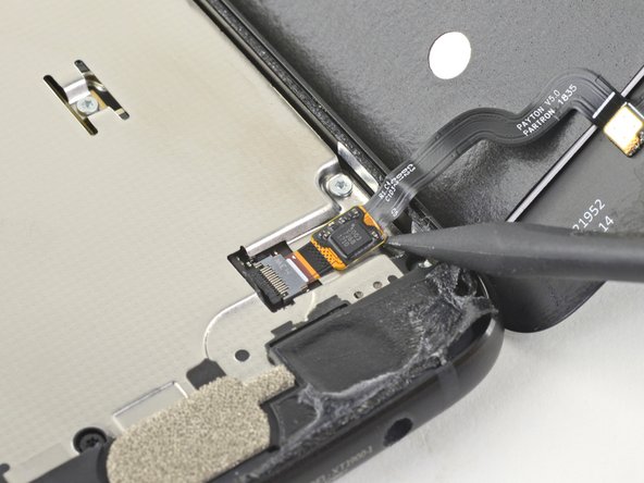

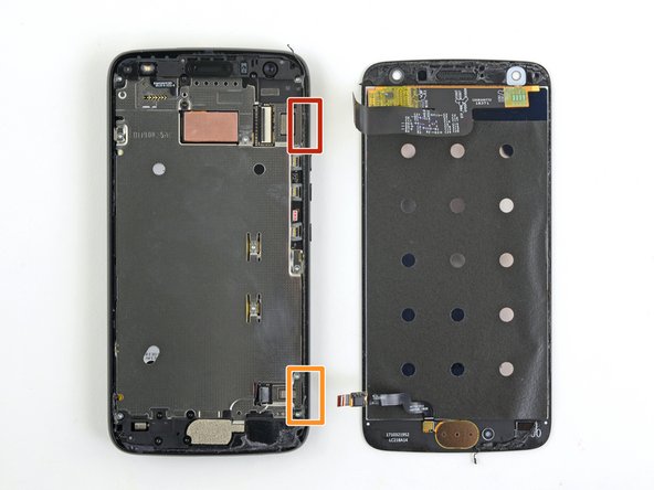

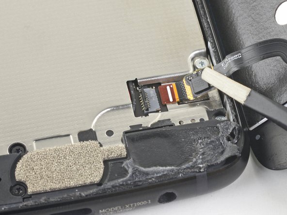

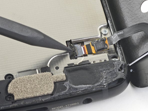

  10. Slide the point of a spudger underneath the fingerprint sensor cable and gently pry up to loosen the cable from the phone. Do not pull on the cable. It is still attached to the phone by a delicate ZIF socket.
    • Slide the point of a spudger underneath the fingerprint sensor cable and gently pry up to loosen the cable from the phone.
    • Do not pull on the cable. It is still attached to the phone by a delicate ZIF socket.
  11. Use the point of a spudger to flip up the lock bar on the fingerprint sensor's ZIF socket, near the bottom right of the phone. Use tweezers to carefully slide the fingerprint sensor cable out of the socket. Use tweezers to carefully slide the fingerprint sensor cable out of the socket.
    • Use the point of a spudger to flip up the lock bar on the fingerprint sensor's ZIF socket, near the bottom right of the phone.
    • Use tweezers to carefully slide the fingerprint sensor cable out of the socket.

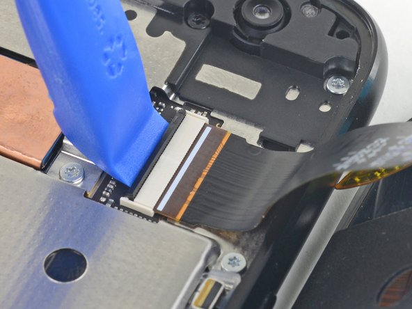

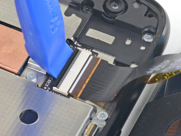

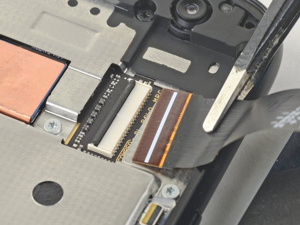

  12. Use an opening tool to flip up the wide lock bar on the display cable's ZIF socket, near the top right of the phone. Use tweezers to carefully slide the display cable out of the ZIF socket. Use tweezers to carefully slide the display cable out of the ZIF socket.
    • Use an opening tool to flip up the wide lock bar on the display cable's ZIF socket, near the top right of the phone.
    • Use tweezers to carefully slide the display cable out of the ZIF socket.

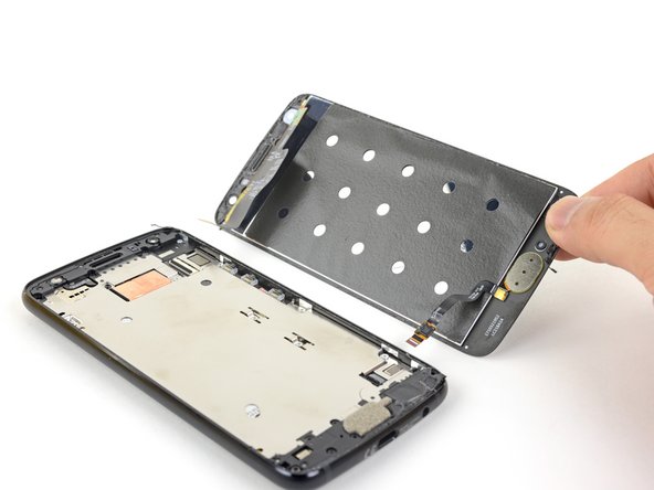

  13. Remove the screen. During reassembly, follow this guide to install custom-cut adhesives for your phone.
    • Remove the screen.
    • During reassembly, follow this guide to install custom-cut adhesives for your phone.

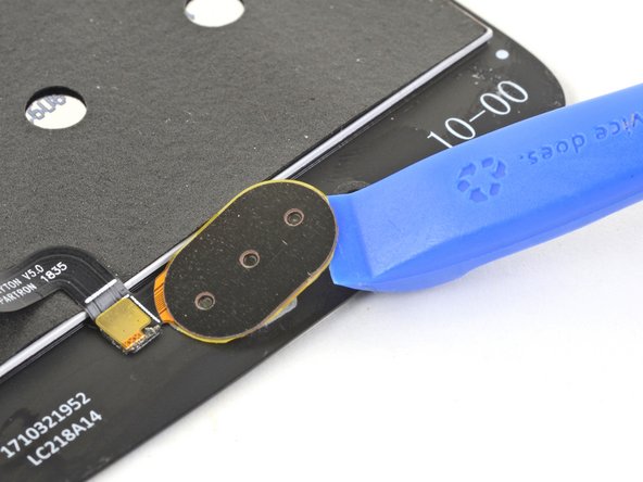

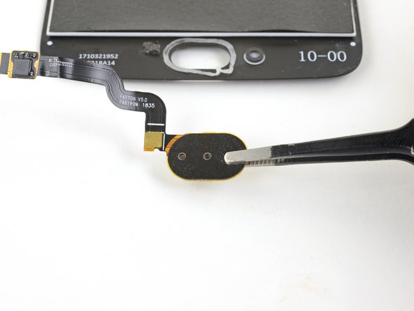

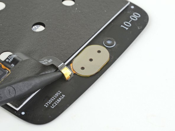

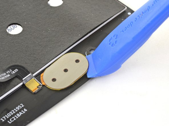

  14. Apply a heated iOpener to the fingerprint sensor for one minute to soften the adhesive gasket.
    • Apply a heated iOpener to the fingerprint sensor for one minute to soften the adhesive gasket.
  15. Slide the point of a spudger under the fingerprint sensor cable and gently pry to loosen the cable from the screen. Slide the point of a spudger under the fingerprint sensor cable and gently pry to loosen the cable from the screen.
    • Slide the point of a spudger under the fingerprint sensor cable and gently pry to loosen the cable from the screen.
  16. Use an opening tool to pry up and loosen the fingerprint sensor from the screen. Use an opening tool to pry up and loosen the fingerprint sensor from the screen.
    • Use an opening tool to pry up and loosen the fingerprint sensor from the screen.
  17. Remove the fingerprint sensor.
    • Remove the fingerprint sensor.
    • To reattach the fingerprint sensor, use a precut gasket, or apply some thin strips of Tesa adhesive to the perimeter of the sensor.

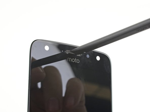

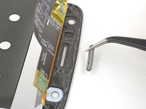

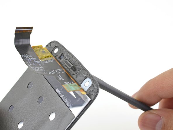

  18. If your replacement screen did not come with an earpiece speaker grille, you will have to transfer it from your original screen. The earpiece speaker grille consists of two small mesh pieces. Be careful not to lose them as you transfer them over. Use the flat edge of a spudger to push the grille from the front side of the screen to loosen it from its recess.
    • If your replacement screen did not come with an earpiece speaker grille, you will have to transfer it from your original screen.
    • The earpiece speaker grille consists of two small mesh pieces. Be careful not to lose them as you transfer them over.
    • Use the flat edge of a spudger to push the grille from the front side of the screen to loosen it from its recess.
    • Remove the grille.
    • Use some thin strips of Tesa tape to affix the grille to the replacement screen.

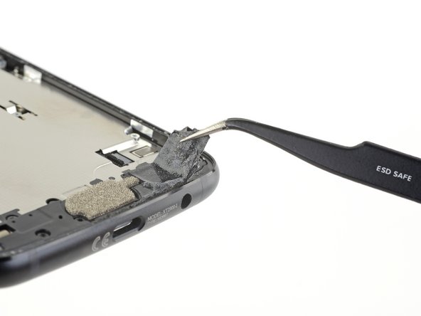

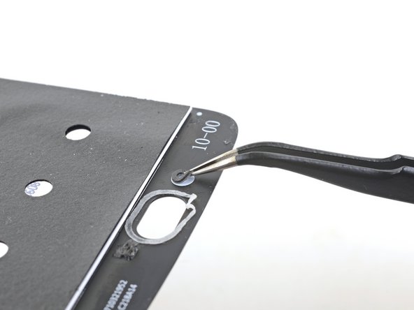

  19. If your replacement part did not come with a lower microphone gasket, use tweezers to carefully peel it from your old screen and transfer it to your replacement part.
    • If your replacement part did not come with a lower microphone gasket, use tweezers to carefully peel it from your old screen and transfer it to your replacement part.
    • Compare your new replacement screen to the original part. You may need to transfer remaining components or remove adhesive backings from the new part before installing.
