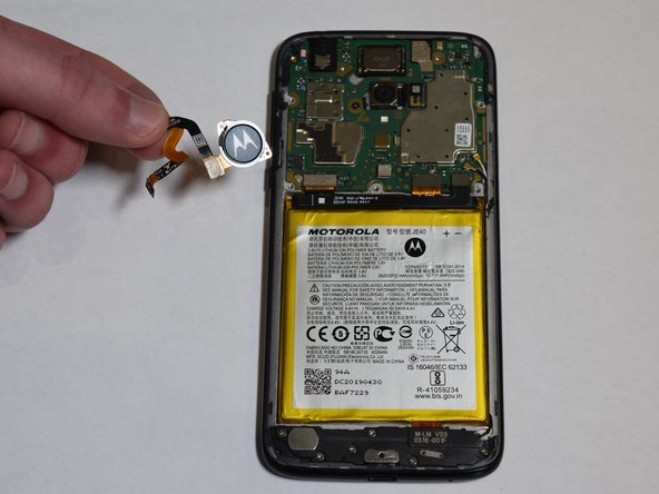

    • Lift motherboard cover from the bottom.
    • Use reverse tweezers or a similar tool if needed
  6. Motorola Moto G7 Play Fingerprint Sensor Replacement: step 6, image 1 of 2 Motorola Moto G7 Play Fingerprint Sensor Replacement: step 6, image 2 of 2
    • Using the iFixit opening tool, carefully disconnect the ribbon cable connecting the fingerprint scanner to the motherboard.
    • Remove the fingerprint scanner from the device.
