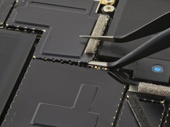

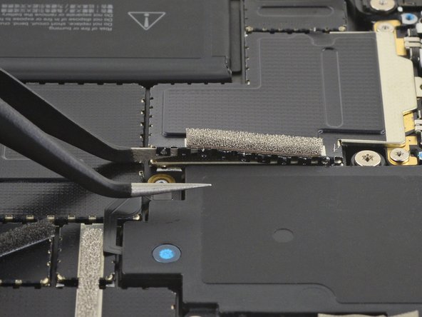

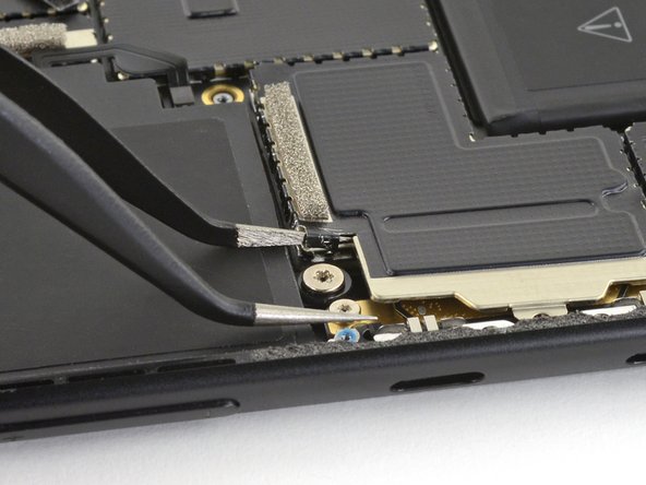

  16. Microsoft Surface Pro X USB-C Ports Replacement, Remove the display cable shield: step 16, image 1 of 3 Microsoft Surface Pro X USB-C Ports Replacement, Remove the display cable shield: step 16, image 2 of 3 Microsoft Surface Pro X USB-C Ports Replacement, Remove the display cable shield: step 16, image 3 of 3
    Tool used on this step:
    Buy

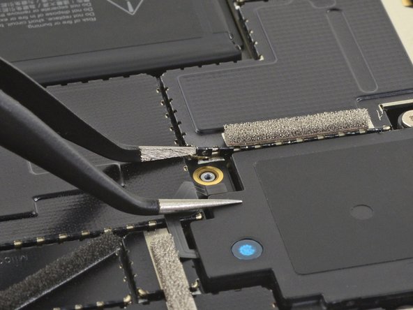

    • Insert a tine of a pair of pointed tweezers under the bottom right corner of the display cable shield (where the display cable is oriented down).
    • Lift up the corner to detach it from the screen.
  17. Microsoft Surface Pro X USB-C Ports Replacement: step 17, image 1 of 2 Microsoft Surface Pro X USB-C Ports Replacement: step 17, image 2 of 2
    • Repeat the previous step for the bottom right corner.
  18. Microsoft Surface Pro X USB-C Ports Replacement: step 18, image 1 of 1
    • Remove the display cable shield from the screen.

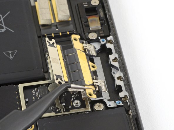

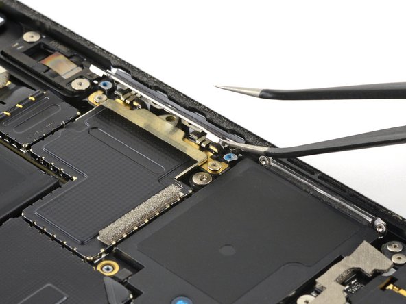

  34. Microsoft Surface Pro X USB-C Ports Replacement, Remove the USB-C port shield screws: step 34, image 1 of 1
    • Use a T3 Torx screwdriver to remove the three 2.9 mm screws securing the first USB-C port shield.

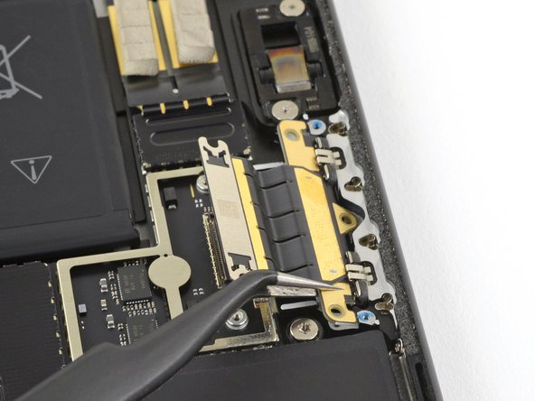

  35. Microsoft Surface Pro X USB-C Ports Replacement, Remove the first USB-C port shield: step 35, image 1 of 3 Microsoft Surface Pro X USB-C Ports Replacement, Remove the first USB-C port shield: step 35, image 2 of 3 Microsoft Surface Pro X USB-C Ports Replacement, Remove the first USB-C port shield: step 35, image 3 of 3
    Buy
    • If you are going to reuse the USB-C port shields, try to avoid excessively bending them during removal.
    • Insert one tine of a pair of pointed tweezers into the gap in the first USB-C port shield next to the screw hole closest to the left speaker.
    • Lift up the shield to detach it from the frame.
  36. Microsoft Surface Pro X USB-C Ports Replacement: step 36, image 1 of 1
    • Remove the first USB-C port shield from the frame.
    • If the shield isn't completely detached from the frame, pry up additional areas on the edges of the shield.
  37. Microsoft Surface Pro X USB-C Ports Replacement, Remove the second USB-C port shield: step 37, image 1 of 2 Microsoft Surface Pro X USB-C Ports Replacement, Remove the second USB-C port shield: step 37, image 2 of 2
    • Take care not to puncture or bend the battery with your tweezers—a punctured or bent battery may leak dangerous chemicals or cause a thermal event.
    • Don't pry up the USB-C port shield near the battery.
    • Insert one tine of a pair of pointed tweezers under one of the shield's corners closest to the left speaker.
    • Slide the tine along the edge of the shield to detach the corner from the frame.
  38. Microsoft Surface Pro X USB-C Ports Replacement: step 38, image 1 of 2 Microsoft Surface Pro X USB-C Ports Replacement: step 38, image 2 of 2
    • Repeat the previous step for the second edge of the shield corner to further detach it.
  39. Microsoft Surface Pro X USB-C Ports Replacement: step 39, image 1 of 2 Microsoft Surface Pro X USB-C Ports Replacement: step 39, image 2 of 2
    • Insert one tine of a pair of pointed tweezers under the other corner closest to the left speaker.
  40. Microsoft Surface Pro X USB-C Ports Replacement: step 40, image 1 of 2 Microsoft Surface Pro X USB-C Ports Replacement: step 40, image 2 of 2
  41. Microsoft Surface Pro X USB-C Ports Replacement: step 41, image 1 of 2 Microsoft Surface Pro X USB-C Ports Replacement: step 41, image 2 of 2
    • Slide one tine of a pair of pointed tweezers under one side of the shield's edge closest to the left speaker.
    • Lift up to detach the edge from the frame.
  42. Microsoft Surface Pro X USB-C Ports Replacement: step 42, image 1 of 3 Microsoft Surface Pro X USB-C Ports Replacement: step 42, image 2 of 3 Microsoft Surface Pro X USB-C Ports Replacement: step 42, image 3 of 3
    • Note that the second USB-C port shield may fling off of the frame when you detach it. You can place a finger on the shield to prevent it from flinging.
    • Slide one tine of a pair of pointed tweezers under the other side of the shield's edge closest to the left speaker.
    • Lift up to completely detach the edge from the frame.
    • Remove the second USB-C port shield from the frame.

  44. Microsoft Surface Pro X USB-C Ports Replacement: step 44, image 1 of 2 Microsoft Surface Pro X USB-C Ports Replacement: step 44, image 2 of 2
    • Insert the flat end of a spudger under the long edge of the USB-C port press connector.
    • Rotate the flat end of the spudger to disconnect the press connector from its socket.
    • When you disconnect connectors like these, be careful not to dislodge the small surface-mounted components surrounding the socket.
    • To re-attach press connectors like this one, carefully align and press down on one side until it clicks into place, then repeat on the other side. Do not press down on the middle. If the connector is misaligned, the pins can bend, causing permanent damage.

  46. Microsoft Surface Pro X USB-C Ports Replacement, Remove the USB-C ports: step 46, image 1 of 3 Microsoft Surface Pro X USB-C Ports Replacement, Remove the USB-C ports: step 46, image 2 of 3 Microsoft Surface Pro X USB-C Ports Replacement, Remove the USB-C ports: step 46, image 3 of 3
    • Use a pair of tweezers to grip the USB-C port screw hole tab closest to the left speaker.
    • Lift up the press connector edge of the USB-C ports to detach it from the frame.
    • Remove the USB-C ports from the frame.
