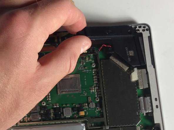

    2. Microsoft Surface Pro 4 Right Speaker Replacement: step 2, image 1 of 1
      • Use a small plastic spudger to work the speaker cable connector out of its socket.
