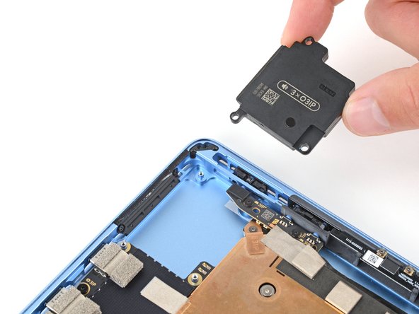

    1. Microsoft Surface Pro 11 Left Speaker Replacement, Remove the left speaker screws: step 25, image 1 of 2 Microsoft Surface Pro 11 Left Speaker Replacement, Remove the left speaker screws: step 25, image 2 of 2
      • Use a 3IP Torx Plus screwdriver to remove the three 2.6 mm‑long screws securing the left speaker.
      Ask FixBot
    2. Microsoft Surface Pro 11 Left Speaker Replacement, Remove the speaker: step 26, image 1 of 3 Microsoft Surface Pro 11 Left Speaker Replacement, Remove the speaker: step 26, image 2 of 3 Microsoft Surface Pro 11 Left Speaker Replacement, Remove the speaker: step 26, image 3 of 3
      • Use a spudger to lift the left speaker enough that you can grip it with your fingers.
      • Lift and remove the speaker.
      Ask FixBot
