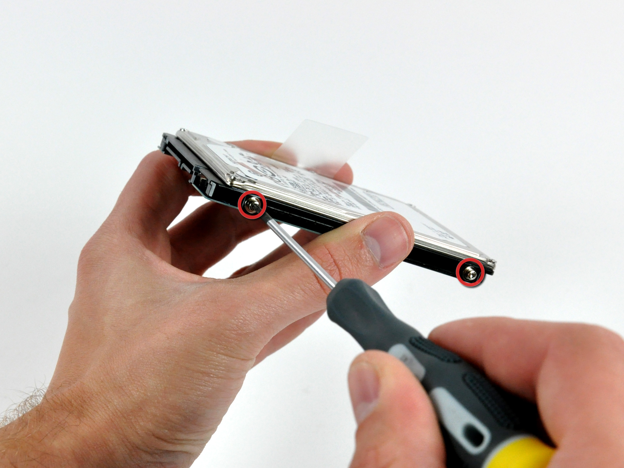

Image 1/1: You'll need to transfer these screws to your new hard drive if you're changing drives.
  • Remove the two T6 Torx screws from each side of the hard drive (four screws total).
  • You'll need to transfer these screws to your new hard drive if you're changing drives.
  • If you are installing a new hard drive, we have an OS X install guide to get you up and running.
