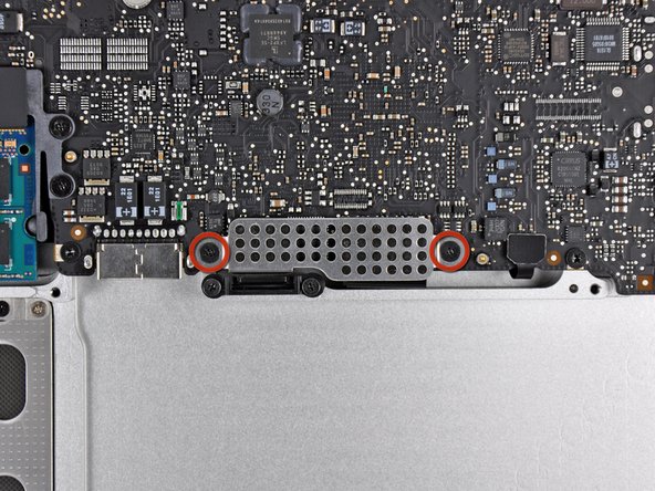

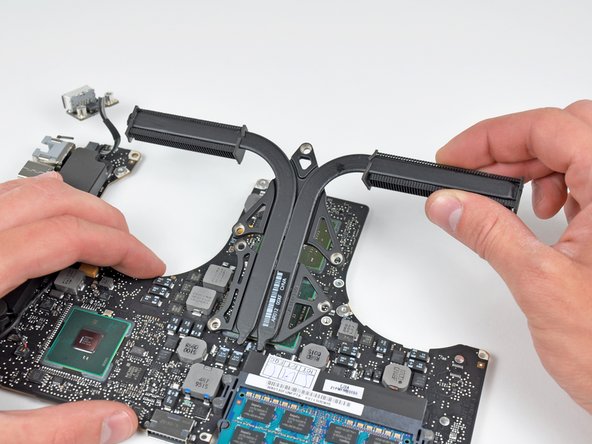

Use this guide to replace your bare logic board. This requires removal of every component attached to the logic board.
Image 1/1: Three 13.5 mm (14.1 mm) Phillips screws.
    • Three 13.5 mm (14.1 mm) Phillips screws.
    • Seven 3 mm Phillips screws.

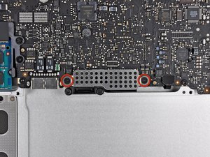

Image 1/1: Note: For certain repairs (e.g. hard drive), removing the battery is not necessary but it prevents any accidental shorting of electronics on the motherboard. If you do not remove the battery, please be careful as parts of the motherboard might be electrified.
  • Remove the two 7.4 mm Y1 Tri-Wing screws securing the battery to the upper case.
  • Note: For certain repairs (e.g. hard drive), removing the battery is not necessary but it prevents any accidental shorting of electronics on the motherboard. If you do not remove the battery, please be careful as parts of the motherboard might be electrified.
  • You do not necessarily have to follow steps 3-6 to remove the battery in order to replace the hard drive. However it is recommended to remove all power sources from electronics before working on them.

I'd like to add that for me, a 1/16th flathead screwdriver did NOT allow me to remove the tri-wing screws holding the battery in place. After several careful attempts, it became obvious I was perilously close to stripping the screw(s), so I abandoned the attempt to unscrew the tri-wing screws with a flathead screwdriver altogether. As it turned out, I didn't need to remove the battery to do what I needed to do (keyboard replacement), but it would have been a whole lot easier had the battery been easily removable.
dave - Reply
The Tri-wing screw driver is impossible to find in retail, amazon and ebay are great bets but they vary wildly in quality... I ordered two, and both were so cheap, and barely got the job done. It could be worth getting it here. When you do get it, make sure you push, the Y0 screws were very tight in my macbook, pressing hard prevents you from stripping the Y screw.
Abe - Reply

What worked for me was actually a set of needlenose pliers - the heads on those screws aren't flush, they actually stick out enough that it's possible to turn them from the outside. Caused some scuff marks on the finish of the screws but it's not like anyone's going to see them anyway!
oboewan42 - Reply
A tri-wing screwdriver sold as 'for Nintendo Wii' marked 'HFA 360/ x50' did the job. I replaced the screws with standard-head M2x6mm metric screws (M2 = 2 mm thread, 6 mm length of threaded part). Exactly, I took them out of an old hard-disk (with torx head and slightly shorter).
akronymus - Reply

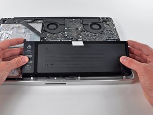

Image 1/2: Do not try to completely remove the battery just yet. Image 2/2: Do not try to completely remove the battery just yet.
  • Lift the battery by its plastic pull tab and slide it away from the long edge of the upper case.
  • Do not try to completely remove the battery just yet.

I'm having the same problem as previous commenters: the battery now drains much faster. It's the original factory unit—I only replaced the HD, which is working great.
Is there something I am missing with the battery reconnection? Maybe it's loose?
I just want to make sure before I crack open my laptop again.
cmalec722 - Reply
Fast battery drain problems might be due to a corrupted power manager circuit on the logic board. To reset it, remove the battery, press the power button for about 5-10 seconds, then reinstall the battery. I know the problem might have been partly due to removing the battery in the first place, but this is the procedure for resetting what might have gone wrong. It might also help to do a PRAM reset, by holding down Command-Option-P-R at power (not just from a restart), and let the Macbook chime twice after its initial powerup chime.
johnsawyercjs -

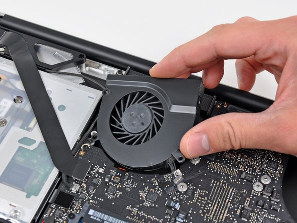

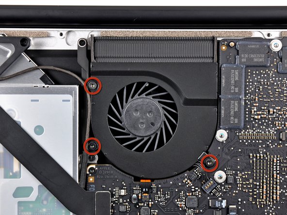

Image 1/1:
  • Remove the three 3.4 mm (3.1 mm) T6 Torx screws securing the left fan to the logic board.
Je vais juste vous surprendre car je suis français.
JI'll just surprise you because I am French .
I understood the problem of the left fan. In fact the problem is with the design at Apple. The fan housing is too narrow vertically a few tenths of millimeters. This is why so many problems . The left fans deteriorate very quickly.
The solution is very simple. Buy a new fan in China, it is the cheapest and level it's very fast delivery . Warning it comes fan already used but in good condition.
The thing to do is to over- raise the fan does not rub and deteriorating. To do so just buy a zinc washer 3 mm diameter available from my local hardware store ( € 3 for 70 pieces ) and place it under the black screw fully right and top right . The over- elevation leads to no longer have friction effect.
Thats ALL !!!
olivierbartoli - Reply

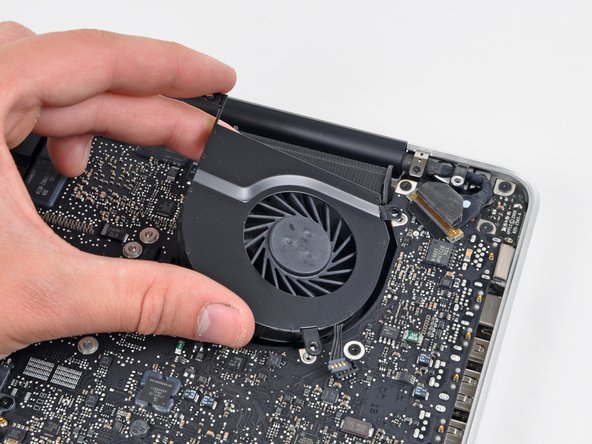

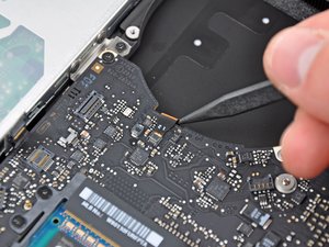

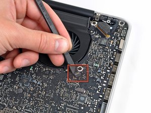

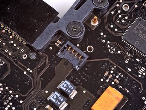

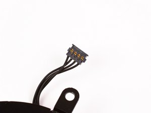

Image 1/3: It is useful to twist the spudger axially from beneath the fan cable wires to release the connector. Image 2/3: The fan socket and the fan connector can be seen in the second and third pictures. Be careful not to break the plastic fan socket off the logic board as you use your spudger to lift the fan connector straight up and out of its socket. The layout of the logic board shown in the second picture may look slightly different than your machine but the fan socket is the same. Image 3/3: The fan socket and the fan connector can be seen in the second and third pictures. Be careful not to break the plastic fan socket off the logic board as you use your spudger to lift the fan connector straight up and out of its socket. The layout of the logic board shown in the second picture may look slightly different than your machine but the fan socket is the same.
  • Use the flat end of a spudger to disconnect the left fan connector from the logic board.
  • It is useful to twist the spudger axially from beneath the fan cable wires to release the connector.
  • The fan socket and the fan connector can be seen in the second and third pictures. Be careful not to break the plastic fan socket off the logic board as you use your spudger to lift the fan connector straight up and out of its socket. The layout of the logic board shown in the second picture may look slightly different than your machine but the fan socket is the same.
I successfully removed my right fan, cleaned it and installed it back. But when it came to the left one I accidentally broke the connector from the logic board. Now I'm left with only one functioning fan. I'm using an external laptop fan. Do I have to replace the whole logic board or can it be fixed somehow? My temp is between 90-95 C when I run a heavy game.
khalid alodan - Reply
Image 1/1:
  • Lift the left fan out of the upper case.

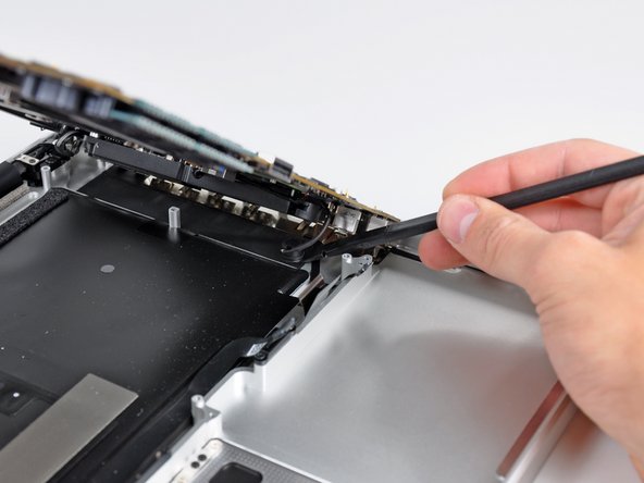

  • Remove the three T6 Torx screws securing the right fan to the upper case.
Image 1/2: It is useful to twist the spudger axially from beneath the fan cable wires to release the connector. Image 2/2: Remove the right fan from the upper case.
  • Use the flat end of a spudger to pry the right fan connector up out of its socket on the logic board.
  • Remove the right fan from the upper case.
There is no way to reconnect the fan cable. It looks like it was soldered onto the logic board. I disconnected it and can't reconnect it.
Has this happened to anyone else.
Vicki - Reply
Vicki, you tore the connector off the board. They can be re-soldered if you are very careful/skilled with a soldering iron, but that is not something that you should try to do if you haven't soldered SMD components before.
rcoleskelton - Reply

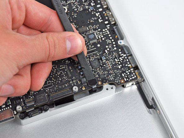

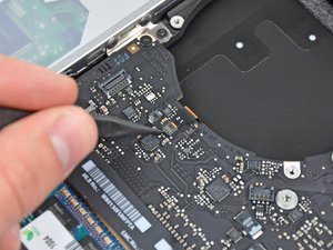

Image 1/1: Fold the AirPort / Bluetooth ribbon cable back to keep it out of the way of the logic board.
  • Use the flat end of a spudger to pry the AirPort / Bluetooth ribbon cable up off its socket on the logic board.
  • Fold the AirPort / Bluetooth ribbon cable back to keep it out of the way of the logic board.

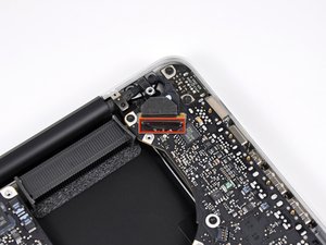

Image 1/1:
  • Disconnect the iSight cable by pulling its connector toward the optical drive opening.

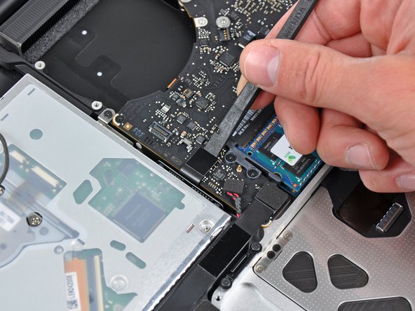

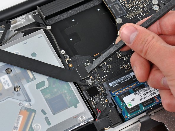

Image 1/1: Fold the optical drive cable back to keep it out of the way of the logic board.
  • Use the flat end of a spudger to pry the optical drive cable connector up from the logic board.
  • Fold the optical drive cable back to keep it out of the way of the logic board.

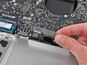

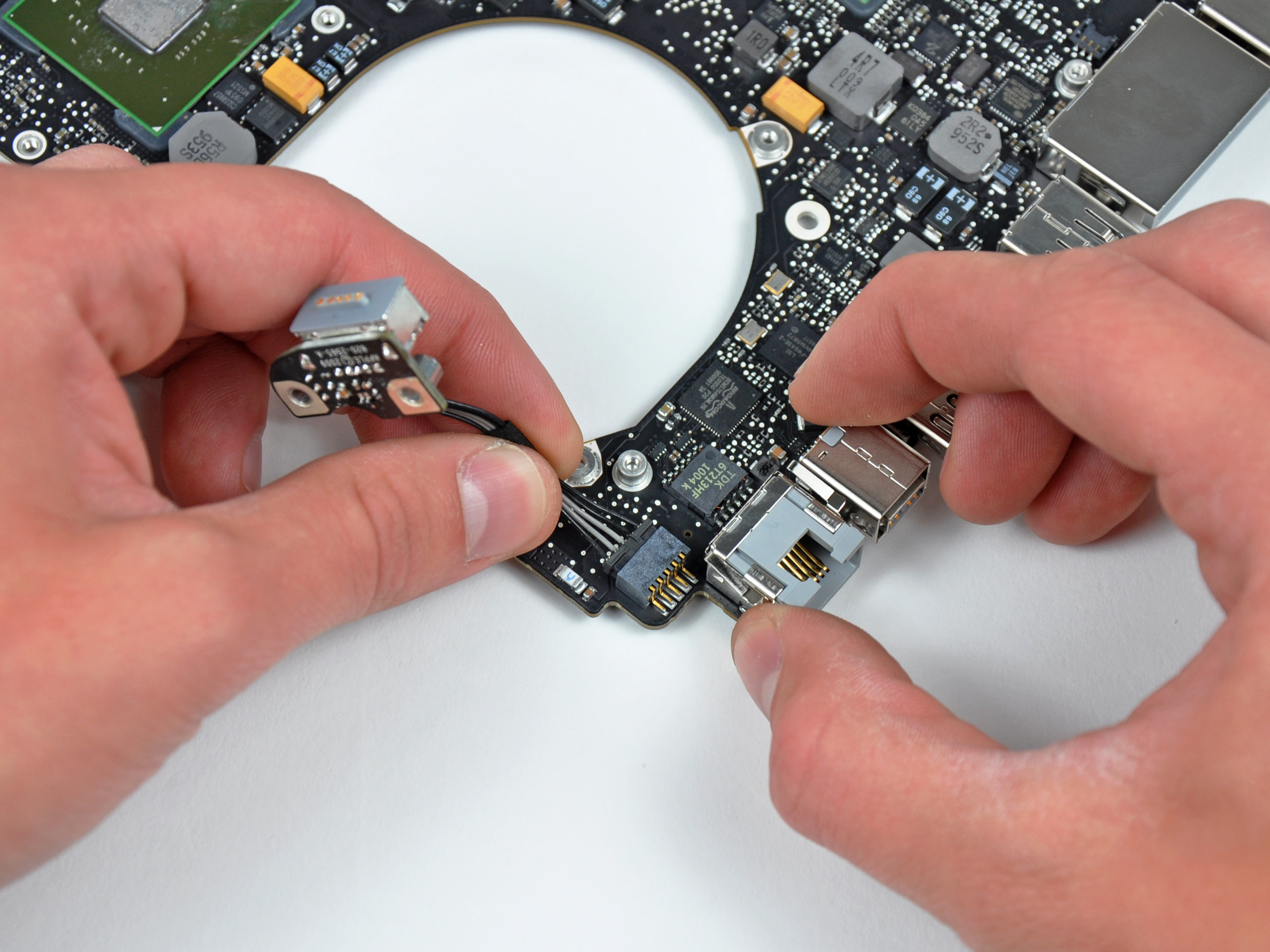

hello i just installed a brand new logic board in my mac, in my mac i have replaced the cd drive with an second ssd - but when i turn the mac on, the OS cant find the second ssd, the cable is in (it clicks in) - does anybody know how to fix this or ?
Best regards Mathias
mathiastondering - Reply

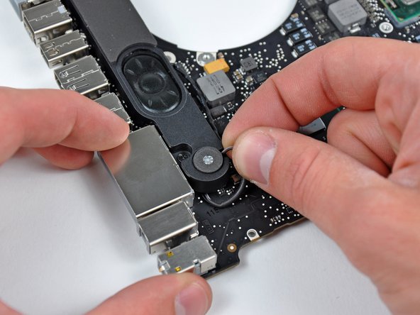

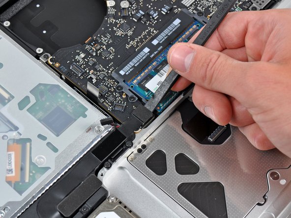

Image 1/1:
  • Carefully pull the subwoofer/right speaker cable up to lift its connector out of its socket on the logic board.

Image 1/1:

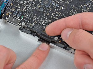

  • Use the flat end of a spudger to pry the hard drive cable connector up out of its socket on the logic board.

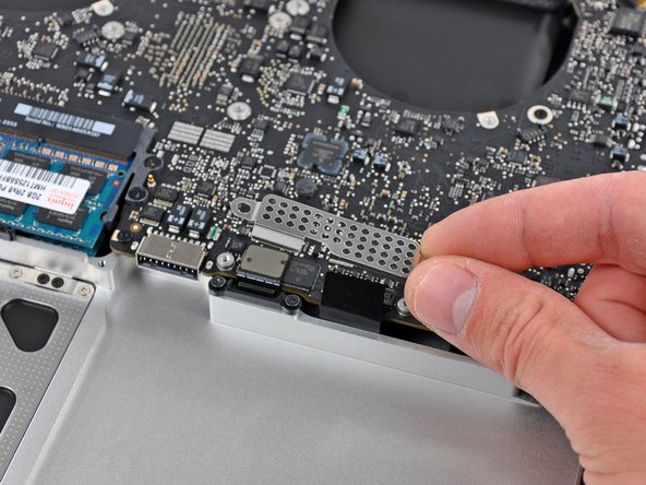

Image 1/2: Remove the EMI shield from the logic board. Image 2/2: Remove the EMI shield from the logic board.
  • Remove the two short Phillips screws securing the small EMI shield to the logic board.
  • Remove the EMI shield from the logic board.
Image 1/1:
  • Use the flat end of a spudger to pry the trackpad cable connector up out of its socket on the logic board.
Image 1/2: Make sure you are flipping up the retaining flap, '''not''' the socket itself. Image 2/2: Use the tip of a spudger to pull the keyboard ribbon cable straight out of its socket.
  • Use your fingernail to carefully flip up the keyboard ribbon cable retaining flap.
  • Make sure you are flipping up the retaining flap, not the socket itself.
  • Use the tip of a spudger to pull the keyboard ribbon cable straight out of its socket.
How will I know I have inserted the keyboard ribbon successfully? After installing a new upper case I can't seem to get the keyboard ribbon to stay in its socket. Or does the EMI sheild hold it in place?
cemcatikkas - Reply
Ditto. It seems very tricky to reinsert the keyboard ribbon.
GrooveStomp - Reply
I just did this - it is kinda tricky. The ribbon cable has a flap on top that is designed solely to help you coax the cable back into the socket....don't make the mistake I did and spend an hour trying to feed this flap through the socket. What worked for me was a combination of using the flap with my fingers and tweezers on the actual cable to reinsert it into the socket. Took a few tries, but I got the cable re-inserted, pressed down on the tiny locking thing, and the keyboard cable was in and secured.
dave - Reply
Indeed, it is difficult to insert the keyboard ribbon cable. It will stop after about 1mm of insertion. It needs to go in quite a bit further. Angling it slightly, you may be able to get a corner to go in, then straighten the ribbon while applying forward pressure. I reassembled it a few times with that sinking feeling on startup before I realized that it wasn't really making contact!
dennishodge - Reply
Image 1/1:
  • Use the flat end of a spudger to pry the battery indicator cable connector up out of its socket on the logic board.

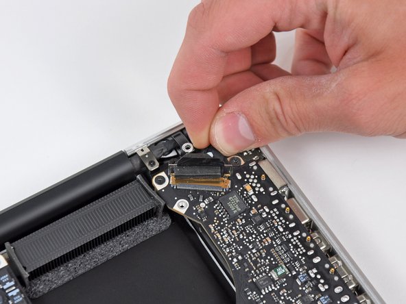

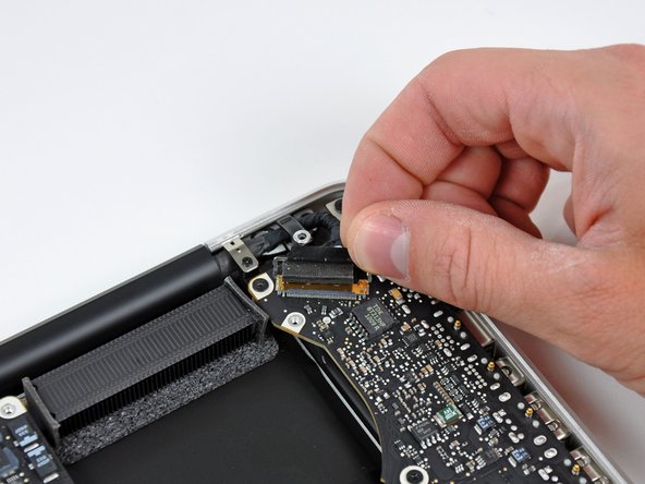

Image 1/3: Pull the display data cable straight out of its socket. Image 2/3: Do not pull the cable upward, as the socket is very fragile. Pull the cable parallel to the face of the logic board toward the corner of the upper case. Image 3/3: Do not pull the cable upward, as the socket is very fragile. Pull the cable parallel to the face of the logic board toward the corner of the upper case.
  • Grab the plastic pull tab secured to the display data cable lock and rotate it toward the DC-In side of the computer.
  • Pull the display data cable straight out of its socket.
  • Do not pull the cable upward, as the socket is very fragile. Pull the cable parallel to the face of the logic board toward the corner of the upper case.
One of the chips in this image was covered in glue. when I flipped the data cable clip, the glue plus encased chip popped right off the board. Does anyone know what chip this is? Without it, my Mac plays the startup chime, but the screen is black. The backlight is on, but it just displays black.
https://www.dropbox.com/s/befonnaz125fn9...
Jon - Reply
I did the exact same thing. I still have the tiny chip. Is there a way to glue it back on or will I need a new logic board now?
Louis Adams - Reply

Image 1/1:
  • Lift the logic board enough to gain clearance and use a spudger to pry the microphone up off the upper case.
On this step, the microphone was attached to the board so the whole unit lifted off easily.
seandodd - Reply
Mine was too; it was part of the speaker assembly, a much better arrangement.

Image 1/1: Remove the six T6 Torx screws securing the heat sink to the logic board.
  • Lay the logic board down on a soft flat surface with the heat sink facing up.
  • Remove the six T6 Torx screws securing the heat sink to the logic board.
  • Keep track of the small springs housed under each screw.
Image 1/1: If the heat sink appears to be stuck to the logic board after removing all six screws, it may be helpful to use a spudger to separate the two components.
  • Remove the heat sink from the logic board.
  • If the heat sink appears to be stuck to the logic board after removing all six screws, it may be helpful to use a spudger to separate the two components.
  • If you need to mount the heat sink back onto the logic board, we have a thermal paste guide that makes replacing the thermal compound easy.
Image 1/1:
  • If necessary, lift the microphone out of its recess in the left speaker housing.
Image 1/1:
  • Remove the two 5 mm Phillips screws securing the left speaker to the logic board.
Image 1/1: Carefully pull the left speaker wires upward to lift the left speaker connector out of its socket on the logic board.
  • If present, remove the small strip of black tape covering the left speaker connector.
  • Carefully pull the left speaker wires upward to lift the left speaker connector out of its socket on the logic board.
Image 1/1:
  • Carefully pull the microphone cables upward to lift the microphone connector out of its socket on the logic board.
Image 1/1: Pull the cables parallel to the face of the logic board.
  • Pull the DC-In board cables toward the heat sink to disconnect the DC-In board from its socket on the logic board.
  • Pull the cables parallel to the face of the logic board.

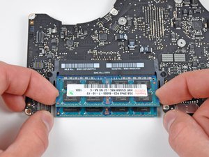

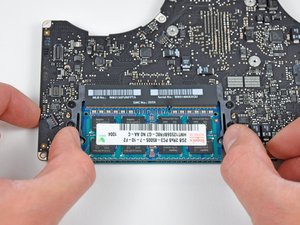

Image 1/2: These tabs lock the chip in place and releasing them will cause the chip to "pop" up. Image 2/2: After the RAM chip has popped up, pull it straight out of its socket.
  • Release the tabs on each side of the RAM chip by simultaneously pushing each tab away from the RAM.
  • These tabs lock the chip in place and releasing them will cause the chip to "pop" up.
  • After the RAM chip has popped up, pull it straight out of its socket.
  • Repeat this process if a second RAM chip is installed.

I broke one of the clips that secures the memory in the "down" position when replacing the RAM. Is there any way to replace just this part? I tried removing the 4 screws that appear to connect the fastener to the logic board but had not luck removing the piece. Any ideas?
Doug - Reply
