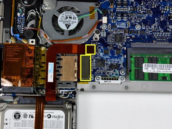

  14. MacBook Pro 15" Core 2 Duo Models A1226 and A1260 Logic Board Replacement: step 14, image 1 of 1
    • Disconnect the eight indicated connectors by placing a spudger beneath the wired side of each one and lifting up.
    • Use care when disconnecting some of the smaller connectors. A forceful prod with the spudger may accidentally break them off the logic board.

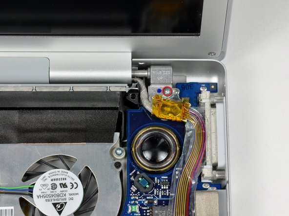

  16. MacBook Pro 15" Core 2 Duo Models A1226 and A1260 Logic Board Replacement: step 16, image 1 of 1
    • Remove the silver 9.5 mm T6 Torx screw securing the ground loop in the display data cable to the casing.
  17. MacBook Pro 15" Core 2 Duo Models A1226 and A1260 Logic Board Replacement: step 17, image 1 of 1

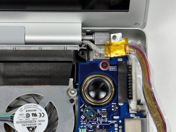

    • Remove the single black 6 mm T6 Torx screw securing the upper portion of the logic board to the lower case.
  18. MacBook Pro 15" Core 2 Duo Models A1226 and A1260 Logic Board Replacement: step 18, image 1 of 1
    • Peel up the orange Kapton tape securing the right thermal sensor cable to the logic board.

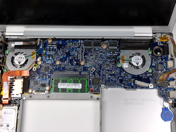

  19. MacBook Pro 15" Core 2 Duo Models A1226 and A1260 Logic Board Replacement: step 19, image 1 of 1
    • Remove the following 15 screws:
    • One 4.4 mm black Phillips screw to the right of the ram slot.
    • Eight 4.7 mm silver T6 Torx screws securing the logic board to the lower case.
    • If you leave the five uppermost orange screws in place, the heatsink/pipes come out effortlessly, still mounted onto the main board. That way its thermal connection is retained, and you won't need to reapply thermal paste as instructed two steps below.
    • One 6.2 mm black T6 Torx screw on the right side of the left fan.
    • Five 9.4 mm silver T6 Torx screws securing the left and right fans.

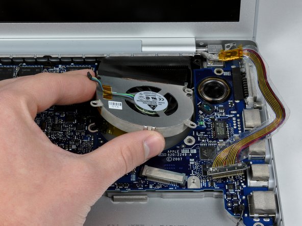

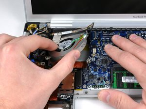

  20. MacBook Pro 15" Core 2 Duo Models A1226 and A1260 Logic Board Replacement: step 20, image 1 of 2 MacBook Pro 15" Core 2 Duo Models A1226 and A1260 Logic Board Replacement: step 20, image 2 of 2
    • Hold the logic board down with one hand and use your other hand to lift the left fan up from its housing. There is a piece of black tape securing the left fan to the heat sink. Carefully peel this tape up from the heat sink as you lift the left fan up.
    • Place the left fan above the Airport card. It is not necessary to remove the fan from the computer entirely.
    • Lift the right fan up and carefully peel up the tape securing the fan to the heat sink as you go.
    • Remove the right fan from the computer.

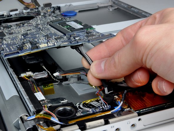

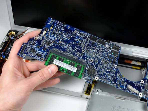

  21. MacBook Pro 15" Core 2 Duo Models A1226 and A1260 Logic Board Replacement: step 21, image 1 of 2 MacBook Pro 15" Core 2 Duo Models A1226 and A1260 Logic Board Replacement: step 21, image 2 of 2
    • Lift up the left side of the logic board and disconnect the gray and black power cable from the bottom of the board.
    • Pull the power cable connector parallel to the face of the logic board.
    • Grasp the logic board at the left side and at the thin section, and rotate the logic board out of the lower case.
    • If you detached the heatsink from the motherboard two steps above, you'll have to clean off and replace the old thermal compound from the chips on the back of the logic board. Use our Applying Thermal Paste Guide to prepare the processor and heat sink surfaces.

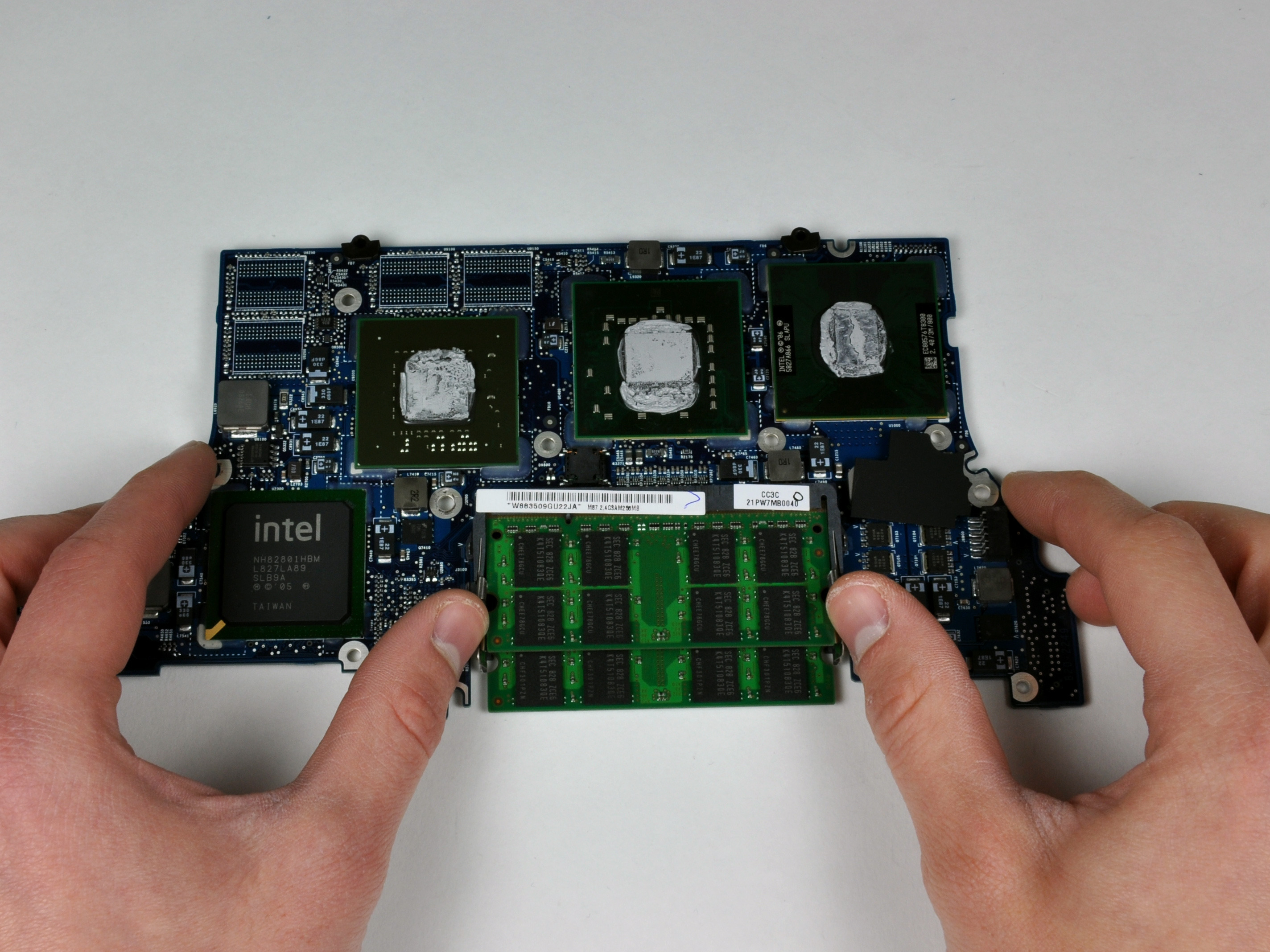

    • Release the tabs on each side of the RAM chip at the same time. These tabs lock the chip in place and releasing them will cause the chip to "pop" up.
    • Pull the chip directly out from its connector.
    • If there are two RAM chips installed, repeat the above procedure for the second chip.
    • When reinstalling the logic board, completely clean off the old thermal paste and apply a new layer on the three chips (CPU, GPU & PCH).
