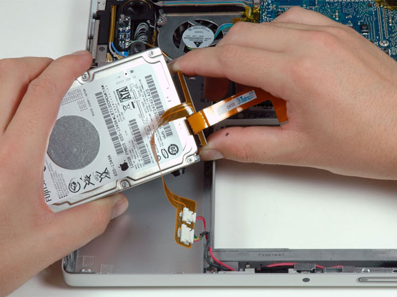

Use a spudger to carefully loosen the adhesive securing the sleep light and IR sensor connectors to the top of the hard drive.
  • Use a spudger to carefully loosen the adhesive securing the sleep light and IR sensor connectors to the top of the hard drive.
  • The entire ribbon cable may be glued to the hard drive. In that case, just carefully pry it up bit by bit with a spudger.
In my 15" Book the cable itself was glued to the harddrive. I have used a plastic case lifter out of my iPhone repaire box to separate the cable from the disc.

The default position of the sleep light and IR sensor connector assembly is directly over the hard drive breather hole on many replacement hard drives, including Hitachi Travelstar 7K500 and 5K250 models. Other brands also have breather holes in similar places. Be careful not to cover the hole with the adhesive portion of the connector tape, as this can interfere with proper operation of the drive. I was able to reinstall the cable twisted at a slight angle in order to keep the hole open.
josehill - Reply
dental floss works well in removing an adhesive heavy cable
dealer390 - Reply
That was a great hint, thanks!
Ralf Bergs -
It is important to reattach the ribbon cable very tight to the hard drive. I also had to put additional glue under one of the connectors. The first time there must have been a mechanical contact to the case which resulted in vibrations. At first I thought, that the new drive caused this but I opened the computer again and now the vibrations have completely vanished.
Thomas Bleek - Reply

Lift up the hard drive with one hand and use your other hand to disconnect the hard drive cable.
  • Lift up the hard drive with one hand and use your other hand to disconnect the hard drive cable.
