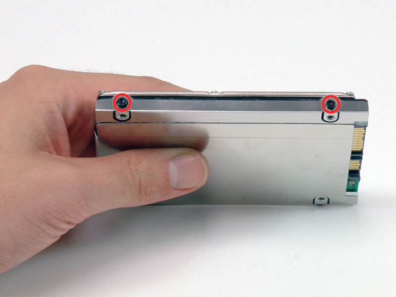

Image 1/1:
  • Rotate the hard drive and remove the two black T8 Torx screws on the other side of the drive.
screws without the flange go nearest to the Sata connector(???)
gbelford - Reply
As seen in the photo, yes as you said
Julio Molero - Reply

The rubber guide came off on mine too. The mistake is that the screws without the flanges go on the outside edge of the Mac and the flange ones towards the inside. If you do it backwards it will pull the rubber guide off and then an otherwise effortless install will take a while longer to complete.
MarkBookPro - Reply
