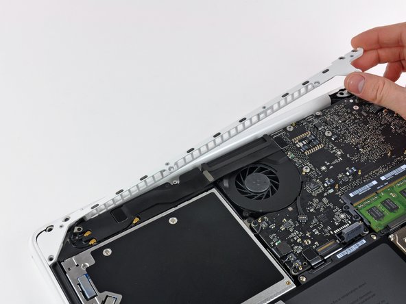

Remove the following screws from the optical drive side of the rear vent:
Two 10 mm T8 Torx
Two 5.2 mm Phillips
Remove the following screws from the port side of rear vent:
Two 10 mm T8 Torx
Two 5.2 mm Phillips

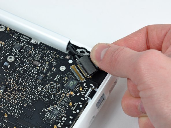

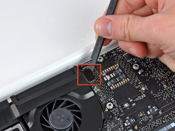

Use the flat end of a spudger to pry the AirPort/Bluetooth ribbon cable up off the logic board.

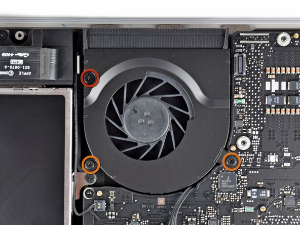

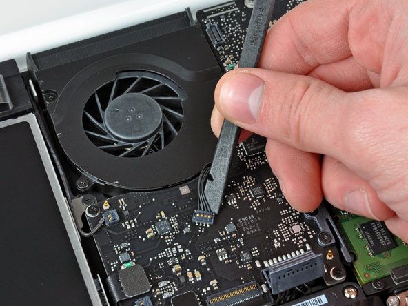

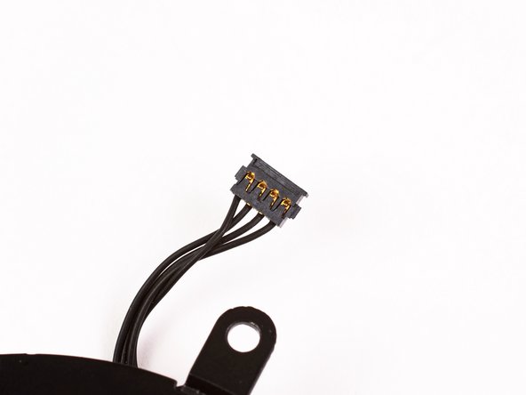

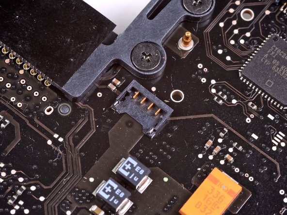

Use a spudger to pry the fan connector straight up and out of its socket on the logic board.
Remove the following three screws securing the fan to the upper case:
One 7.1 mm Phillips screw.
Two 5 mm Phillips screws.
Lift the fan out of the upper case.

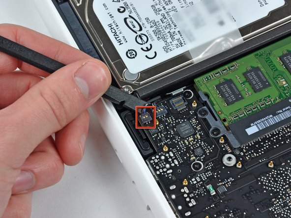

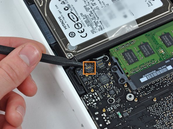

Carefully pry the delicate rear speaker connector up off the logic board. These small L/R speaker connectors are quite easily broken.

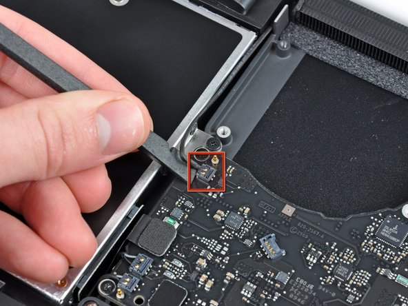

Use a spudger to pry the right speaker connector and sleep LED connector up off the logic board.

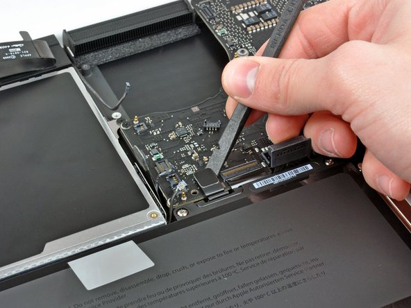

Use your fingernail to flip up the locking flap on the ZIF socket for the keyboard ribbon cable.
Use the tip of a spudger to slide the keyboard ribbon cable out of its socket.

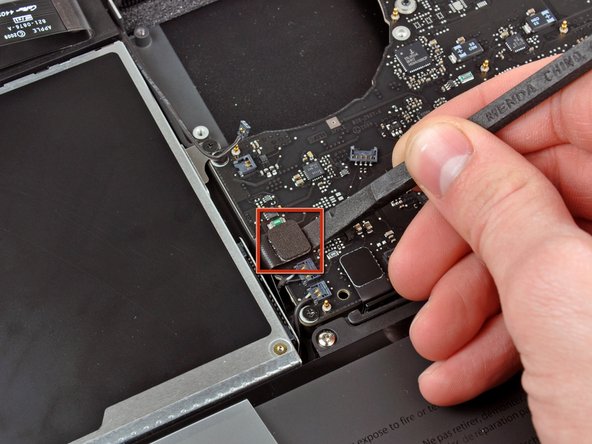

Use the flat end of a spudger to pry the hard drive cable connector up off the logic board.

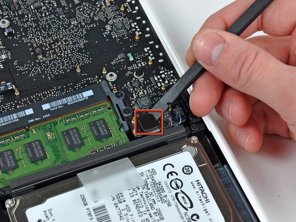

Use a spudger to pry the left speaker connector and microphone connector up off the logic board.

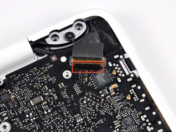

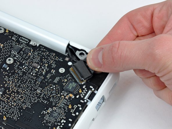

Grab the plastic pull tab secured to the display data cable lock and rotate it toward the DC-In side of the computer.
Gently pull the display data cable connector away from its socket on the logic board.

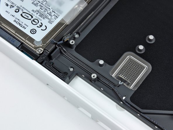

Remove the two 4.1 to 4.5 mm T6 Torx screws securing the MagSafe board to the upper case.
On some models, these screws may be T7. Be careful not to strip away the head with a smaller bit.

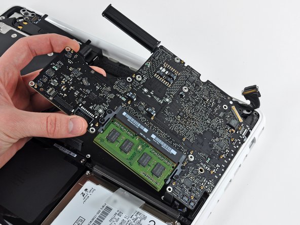

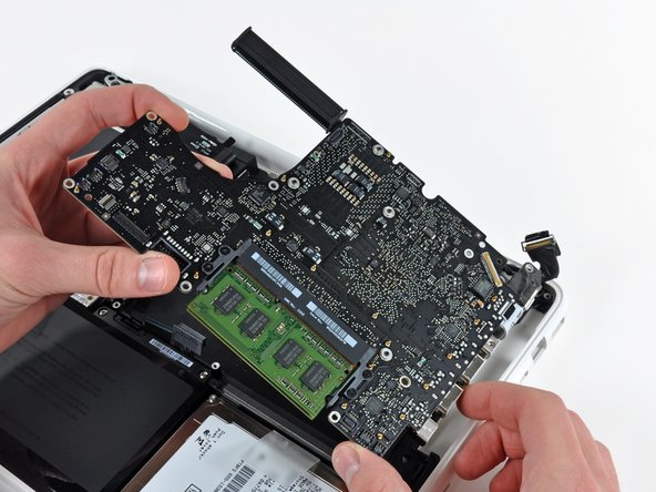

Lift the side of the logic board opposite the ports out of the upper case.
Rotate the logic board away from the upper case until the ports clear the lip molded in the upper case.
Pull the logic board and MagSafe board away from the edge of the upper case as one piece.

Amazing guide.dissasemble until step 6 then skip to 17.saves me a lot of time(approximately 30 min!!!)
use torx 6-8-philips and a pencil.thank you.
Giorgos Saras - Reply

you can actually stop disassembling now and try to replace it now. after removing two t6 screws it came off pretty easily
grze - Reply
Good tip, thanks! I skipped ahead to step 17 and had no problem getting the magsafe board out from under the logic board and the new one installed. Saves a lot of work disconnecting connectors indicated as Fragile!
matt15 -
Thank You! Saved me an hour or so of work and a lot of stress!
15sweyandt -
I also did Step 6, then skipped to Step 17 & 18. Once I had the display data cable off, I could remove the 2 T6 Torx screws holding the MagSafe board on and remove it. You can reach under the logic board with the point of the spudger to work the cable out of the socket. Note how you maneuver the board out of the tight space so you can maneuver it back in. When you put the new MagSafe board in, plug in the cable first. If you bend the wires so the plug approaches the socket at the appropriate angle, you can nudge it in with the pointed end of the spudger.
hpendleton -
Step 8
Since this kind of connector and very fragile and easy to damage even with a spudger I use a needle that I insert in the front side of the connector, between the connector and the socket and only apply a little pressure while lifting up the needle. The connector will then pop up from one side. Repeat the procedure for the other side. With this method it's impossible to damage the connector. I adopted this method after ruining two or three connectors using the spudger.
lemerise - Reply
HELP! Both the connector AND socket detached from the logic board! Is it possible (barring micro-surgery) to reattach the socket to the logic board?
John Watson - Reply
same problem here...any ideas? Did you fix it again, John?
Ben Kn -
I disconnected the connector and socket from the logic board because I wasn't being careful and wasn't using a spudger tool as was recommended. Luckily, a friend of mine that's handy with a soldering gun was able to individually solder each wire from the cooling fan's wire assembly back onto the soldering points on the logic board. It's really intricate, tricky, and risky...but at that point, what choice do you have? I verify it's possible to fix and my cooling fan is now running perfectly fine.
Dan Barnhart - Reply
Step 10
While these connectors are very delicate, a new upper body case will have new connectors already installed. I slightly broke two connectors while removing them.
Also, the connectors have a notch underneath (on the logic board) for the corner of the spudger to fit into. The hard part is that you cannot see the notches until the connectors are removed.
Nations81 - Reply
Hi. Long time ago, I know but.... How did you fix them?
I snapped mine off, can it be soldered back on?
Sai G -
I used pointed tip of one side of the tweezers from the ifixit Home Tech Toolkit. I found this thinner pointed tip better than a spudger for hitting that notch in the socket underneath the connectors. Since this is a metal tool, I pried very gently and I was working on a MacBook with the battery taken out entirely (early on as suggested in the video) and was also using an Anti-Static wrist strap. I found the spudger broke one of the connectors because it's relatively thick plastic, and put too much pressure under the cables before the tip could reach the plastic block of the connector. The pressure under the cable popped the wire contact right through the top of the plastic block connector. (it was OK this connector broke since I didn't need to reuse it--my replacement keyboard/upper case came with its own cables.)
Because the tips of the tweezers are angled, I felt I had better control of the torque I was applying than if I used a jeweler's flathead screwdriver.
kenhtanaka - Reply
i used a very sharp dental pick - a tool i've permanently "added" to my ifixit tool kit bag
pprod - Reply
Using a needle/pin works well. I did what another person mentioned in Step 8. Pry up from the back corner with the tip of the needle. Be gentle. One side will pop up a tiny bit. Move to the other side and gently pry there. Mine popped out completely at that point.
stanos1 - Reply
Step 12
I broke a speaker connector on this step. I found it easier to use a tiny flathead screwdriver to gently pry these connectors up.
brad - Reply
Did u manage to fix the broken speaker connexion Brad? Mine snapped off. How can I fix that?
Sai G - Reply
Step 14
I had to remove the battery again to insert the keyboard ribbon cable. I just couldn't get the right angle and force otherwise.
asciimo - Reply
When reassembling make sure this cable is really deep in it's socket. (Use some force with the spudger wedging it in between the cable and battery). If you don't, you won't be able to power up the board. I had 2 logicboards that I thought were dead, but it turned out the cable was not inserted enough. Jump starting them with the jump pads did nothing (with or without cable connected), but connecting the cable properly made the board come alive. Really check this!!
Peterdk - Reply
You sir, just saved my day! Switching boards between two mac and I thought I broke the two at once... This should be documented on the manual!!
jorgecarleitao -
Thanks for your help!!! I thought I did the replacement wrong. Greetings from Peru.
Lalo Gonzalez -
This was hugely helpful! The cable requires much more force than expected.
Daniel DeGrasse -
'This should be added to the guide:
MacBook unibody keyboard ribbon cable won't go in
bilang31 - Reply
There really should be a comment in the steps regarding tips on how to put the ribbon back in. The tape did the trick and I am back up and running.
alexhgreene - Reply

Step 17
Just lift the tab up slightly to release the clip that secures the data display cable. Then the cable will slide out easily.
matt15 - Reply
If the video data cable has been disconnected before, the adhesive on the might not hold. Be extra cautious in disconnecting this. An illuminated magnifier would be a good help on this step as it is very delicate. This was where I feared I would fail. Was very relieved in getting through this step...
svenaustx - Reply
